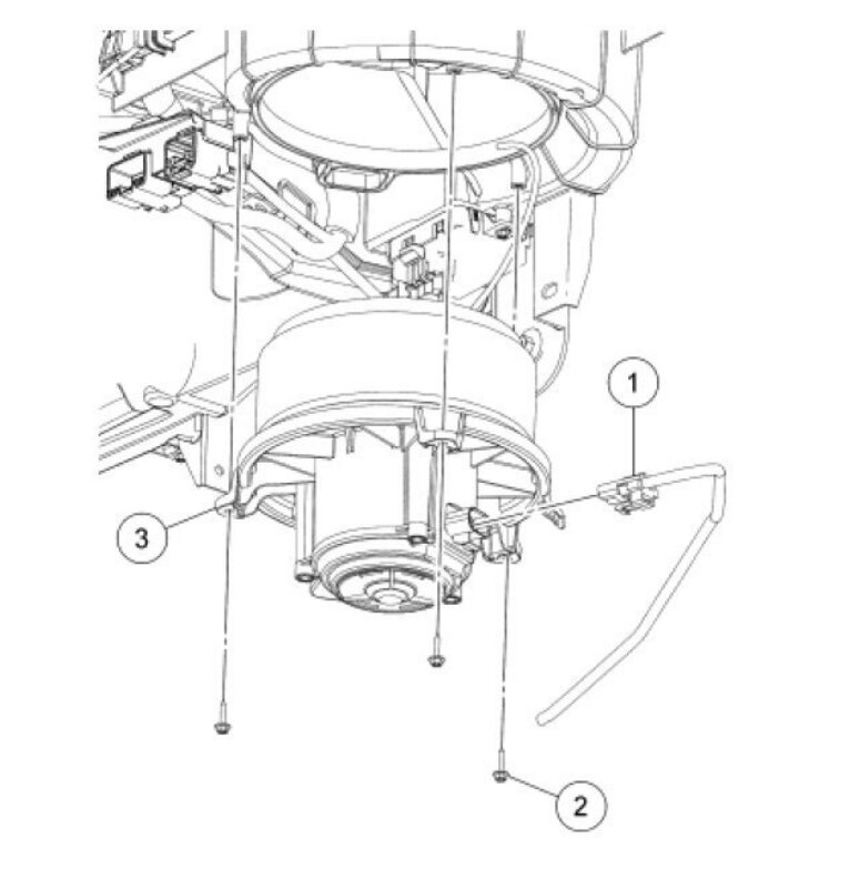

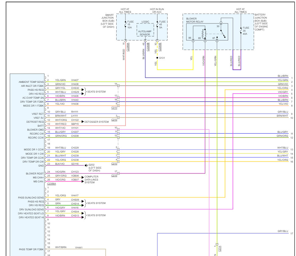

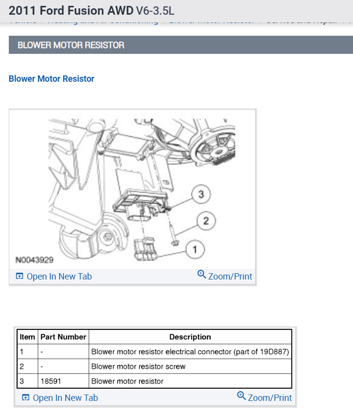

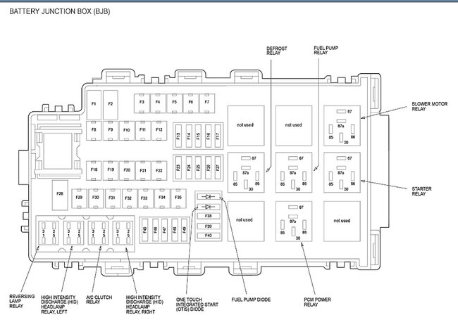

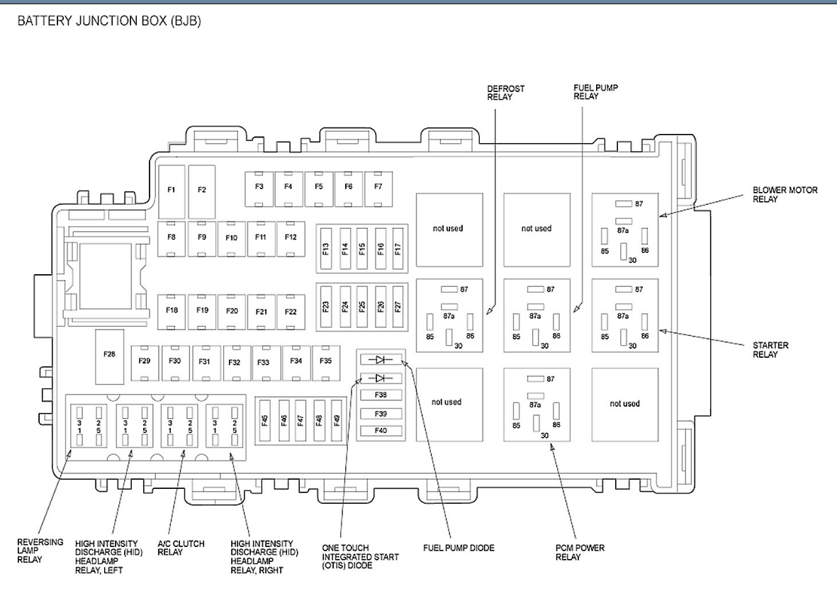

Even though the resistor looks okay it can still be bad, did the resistor or the blower motor smell burnt? I would check fuse #35 in the under-hood fuse panel here is a guide to help.

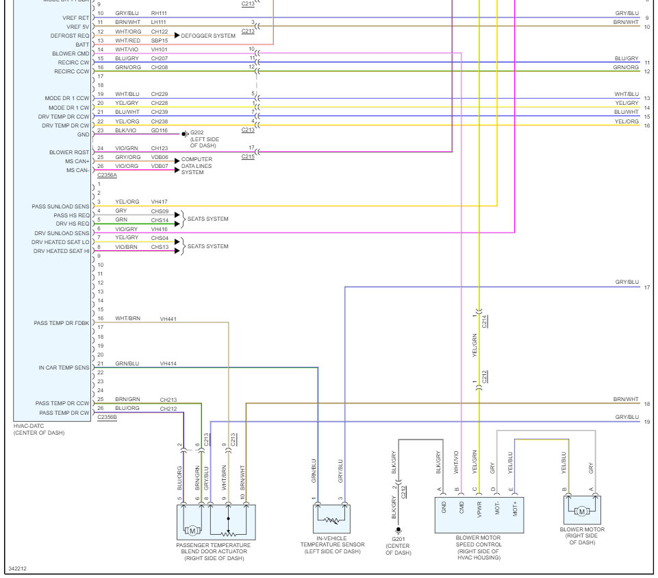

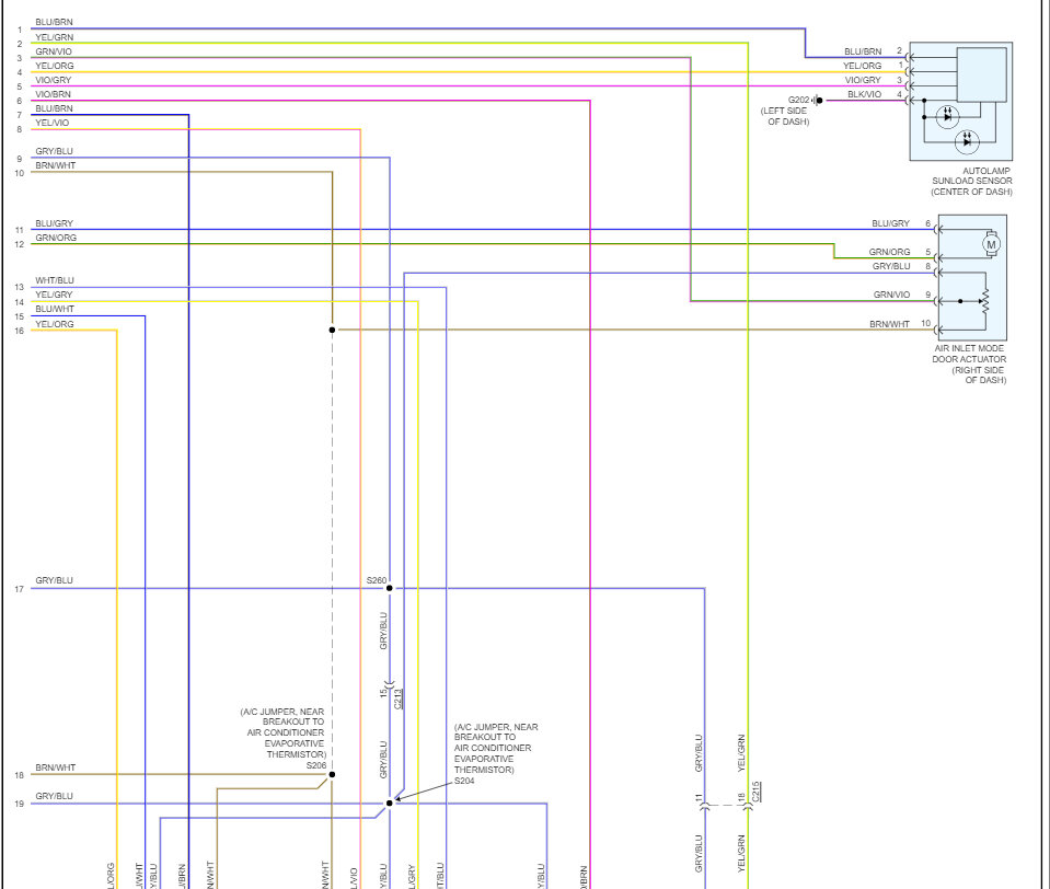

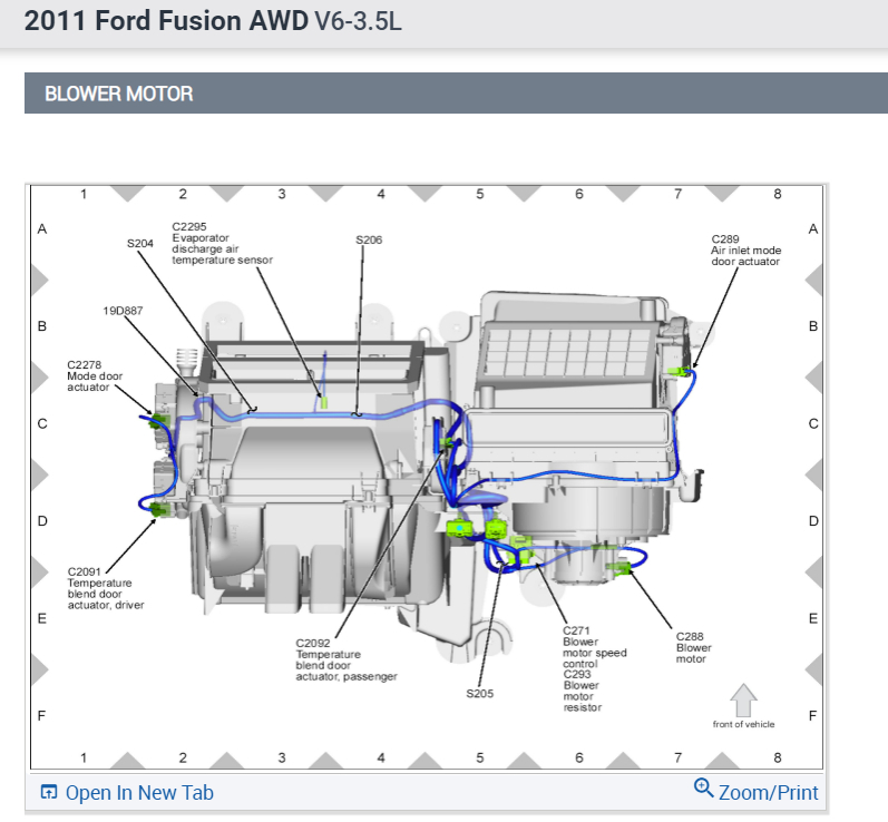

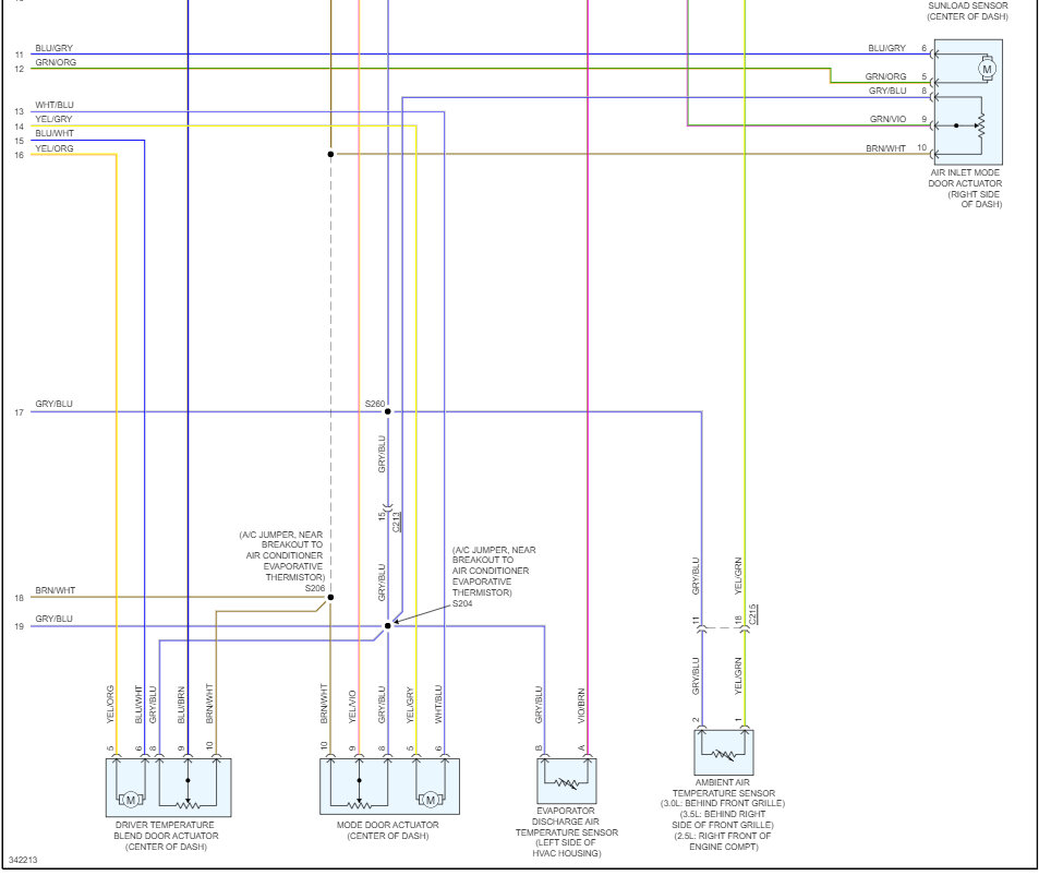

Also, here are the HVAC wiring diagrams so you can see how the system works, also there is a blower motor relay that might be out as well in the same fuse panel as the blower motor fuse. Check out the images (below). Let us know what happens and please upload pictures or videos of the problem so we can see what's going on.
