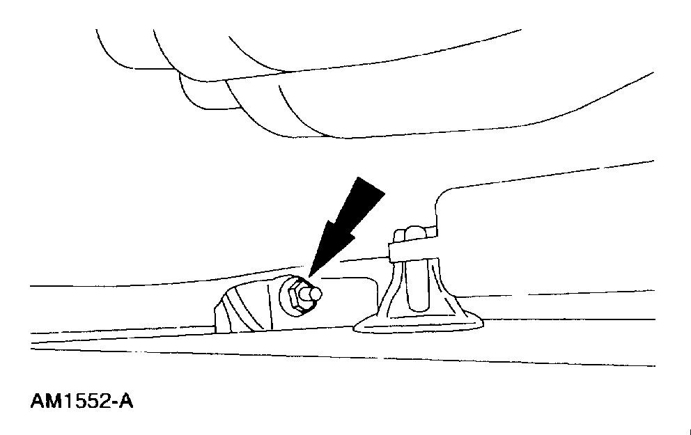

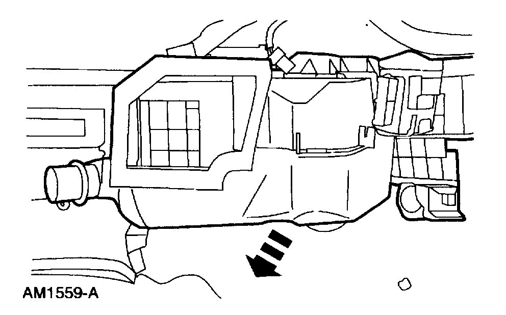

If you determine it is the heater core, here are directions specific to your vehicle for replacement. Just a note, the plenum chamber needs removed. I will start with those directions first. The attached pictures correlate with the directions.
2000 Mercury Grand Marquis V8-4.6L VIN W
Removal and Installation
Vehicle Heating and Air Conditioning Housing Assembly HVAC Service and Repair Procedures Removal and Installation
REMOVAL AND INSTALLATION
REMOVAL
1. Remove the rear seat airflow duct. For additional information, refer to Air Duct. See: Air Duct > Procedures
2. Remove the instrument panel. For additional information, refer to: Dashboard/Instrument Panel. See: Dashboard / Instrument Panel > Service and Repair
3. Drain the coolant from the radiator so the coolant level is below the heater core. For additional information, refer to Cooling System. See: Cooling System > Procedures
pic 1

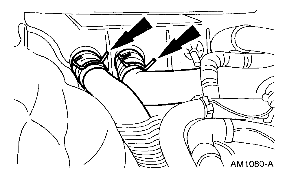

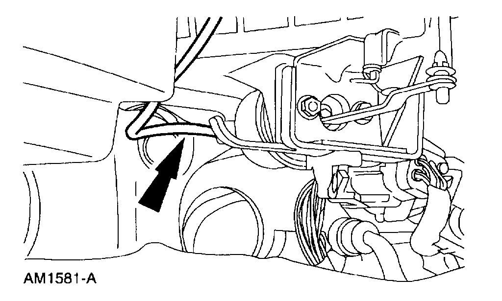

4. Disconnect the heater water hoses.
pic 2

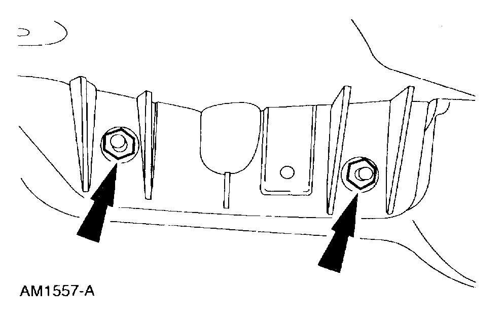

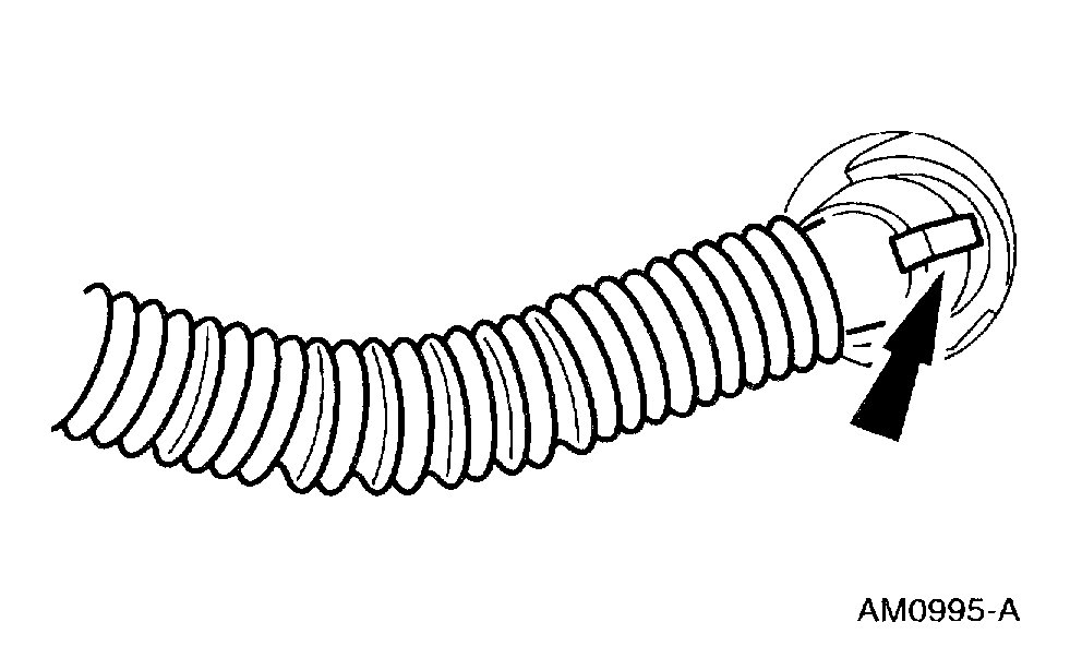

5. Inside the vehicle, remove the nut.
pic 3

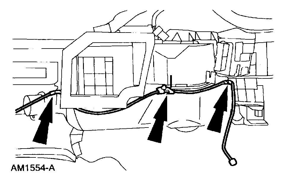

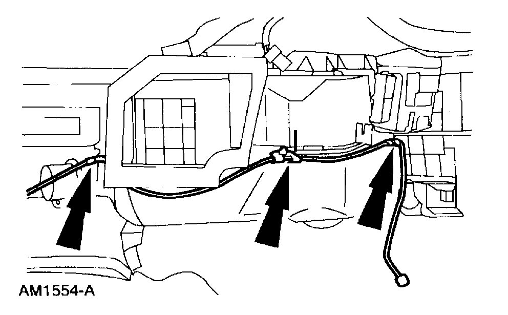

6. Disconnect the vacuum hoses.
NOTE: Mark the locations of the vacuum hoses.
pic 4

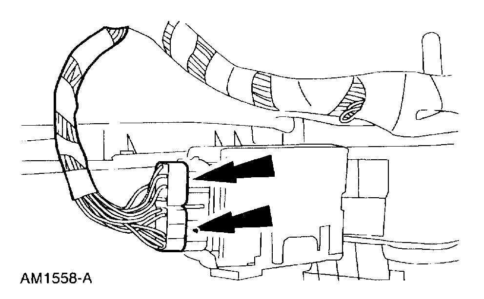

7. Disconnect the vacuum hose.
pic 5

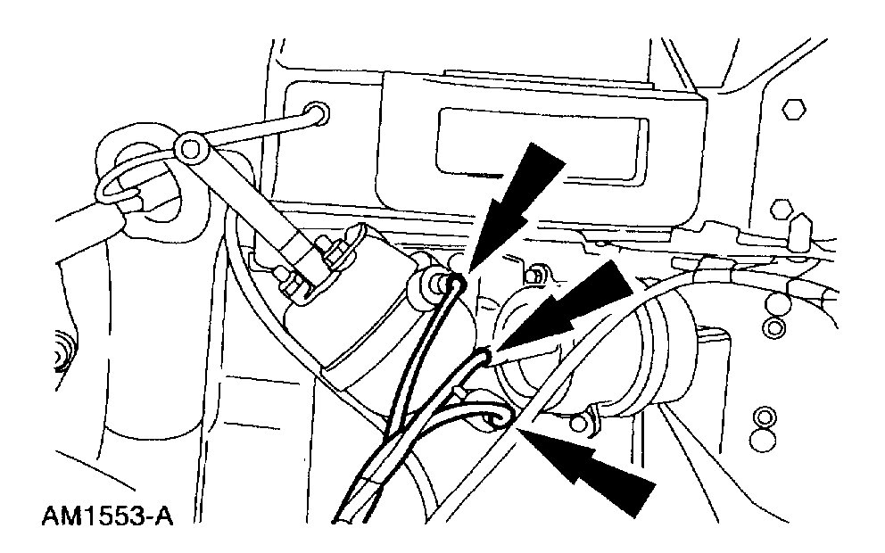

8. Remove the pin-type retainers and remove the vacuum harness.
pic 6

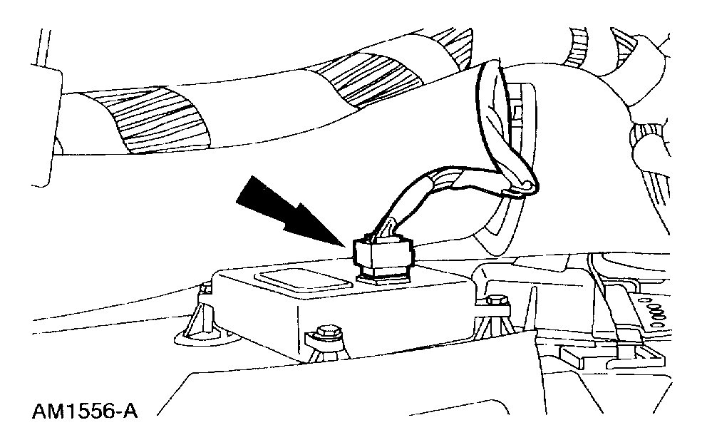

9. Disconnect the connector.
pic 7

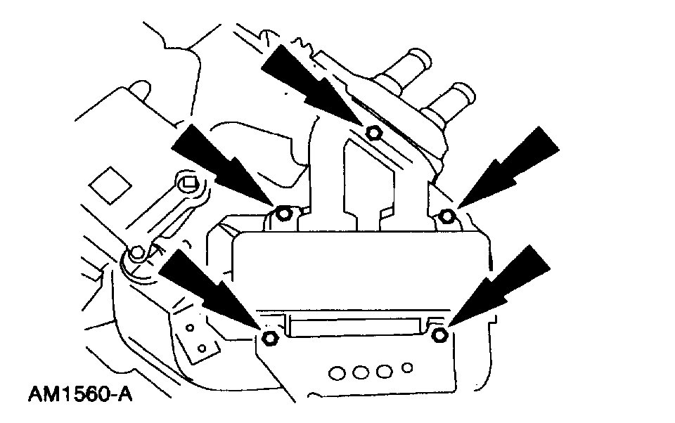

1O. Remove the nuts.
pic 8

1. Remove the plenum chamber.
pic 19

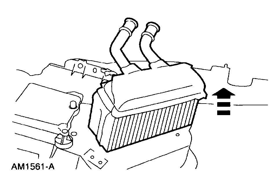

2. Remove the screws and the heater core cover.
pic 20
3. Carefully cut the seal above the heater core inlet and outlet tubes and remove the heater core.
