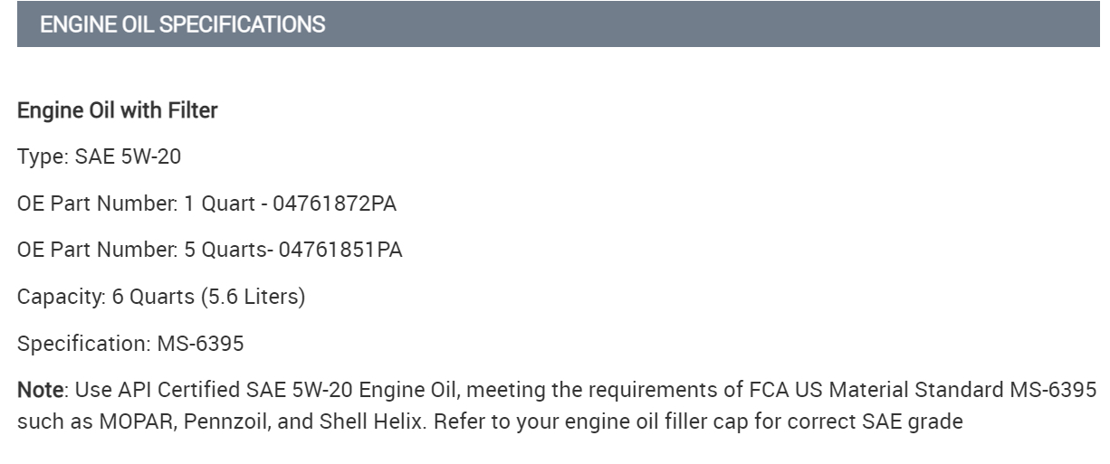

Here is the correct oil type and capacity if there were any noises from the top of the engine. It may have had the wrong engine oil in it to begin with. Most quick lube places throw whatever oil they have in the vehicles that come in.

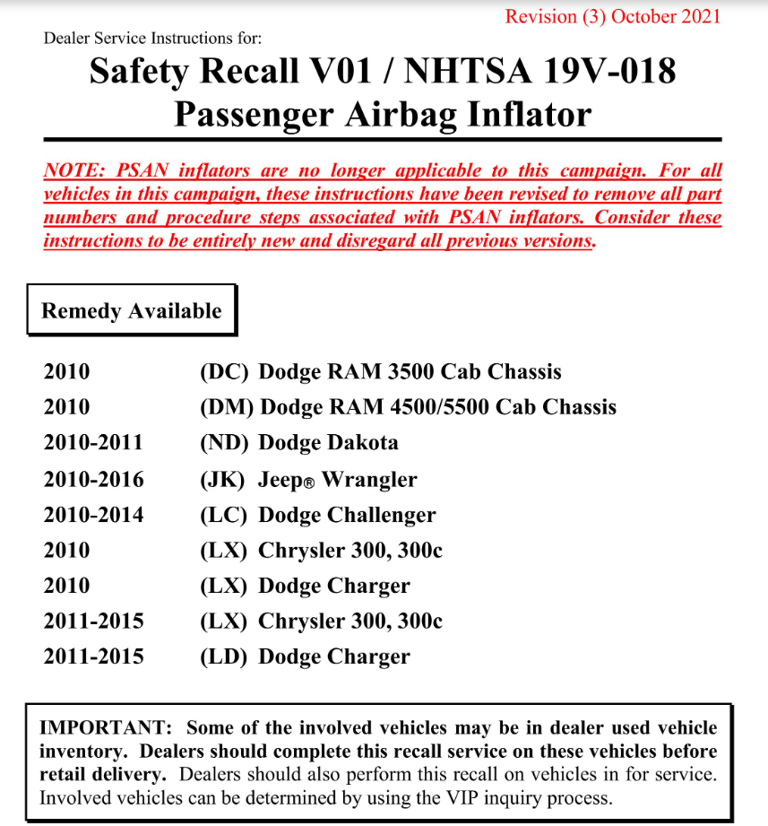

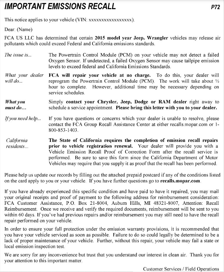

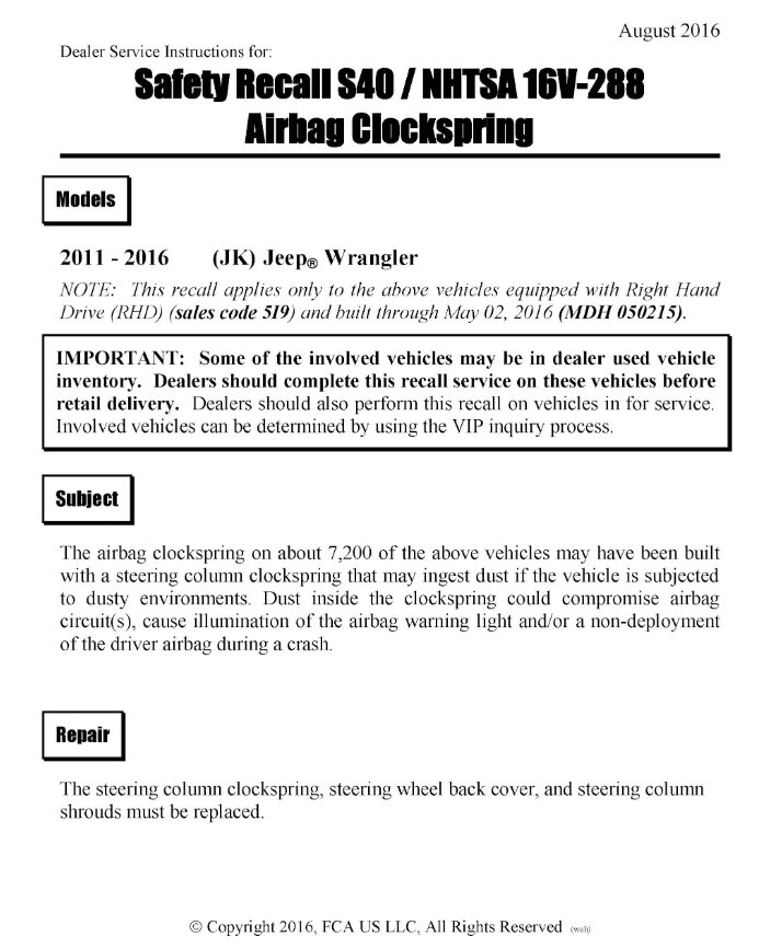

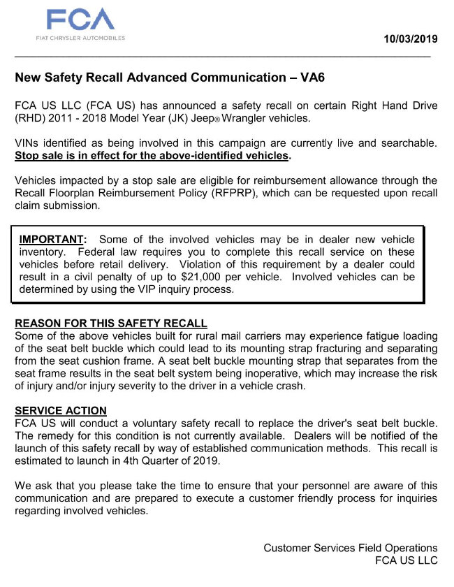

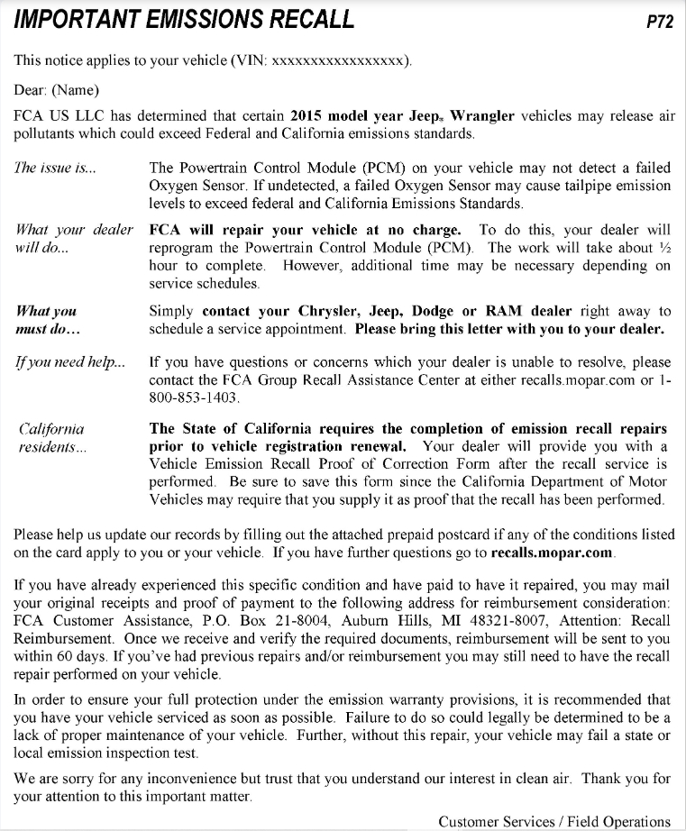

Pages 2 to 4 are some safety Recalls for your vehicle as well. The dealership should take care of these for free in most situations.
