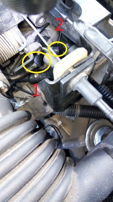

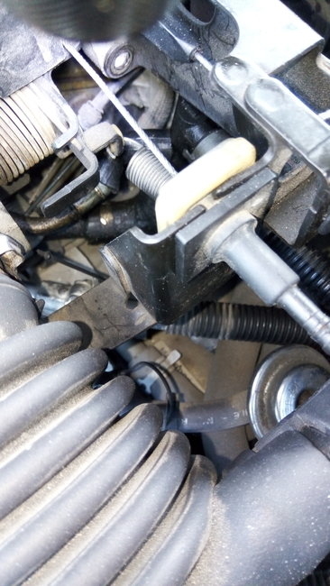

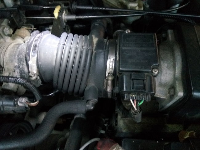

I think I found the source of the coolant leak I took a picture. I do not know if it is missing a clamp or what and the rubber is bent like it is being pushed out of place.

I do not know if you can see it or not but it is under that spring.

Could you see what I was talking about from that picture? I can hear air coming out of it.

No, I could not see anything coolant related.

Not sure why I said coolant... I meant power steering. I do not know what it is called so it is hard for me to say what it is. Google and YouTube is the only training I have had. lol

I am seeing what looks like a 3/4" hose under the throttle return spring that should have a clamp. WT is correct about the leak detector dye, but it is the quickest and easiest way to track down a fluid leak.

So just replace the hose? What is the clamp called? Or does it matter.

In the pictures below.
This looks like a small hose, a vacuum line maybe.
If it is hissing, it probably is a vacuum leak and needs to be reconnected! You may need to replace it if it is too short.
It would not be part of the oil leak problem.

I am going to buy some hose tomorrow after work. I will let you know if that stops the engine sputter.

Replaced the hose and pcv valve seems to have fixed the sputter. While idleing anyway have not driven yet, still trying to find the oil leak

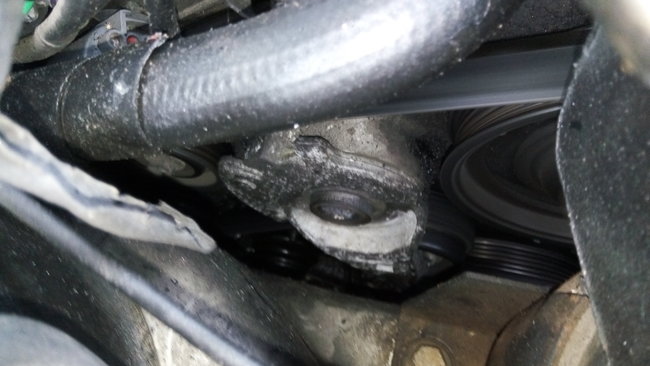

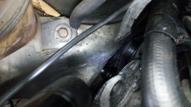

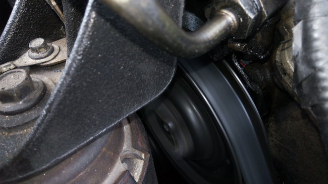

I believe the passenger side leak may be behind this pulley. It's the hugest one is that where a seal is?

Edit... Not hugest (phone auto correct)
Highest

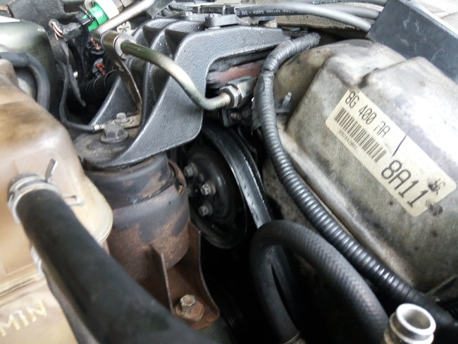

I dont know what you call this but there is oil inside it
