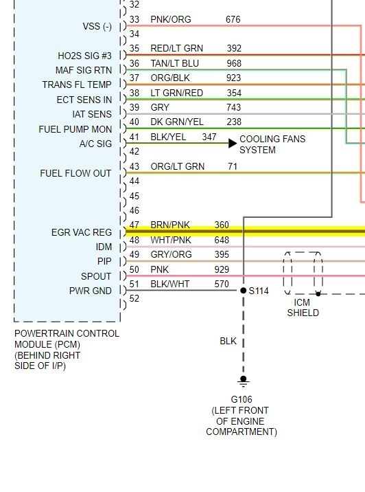

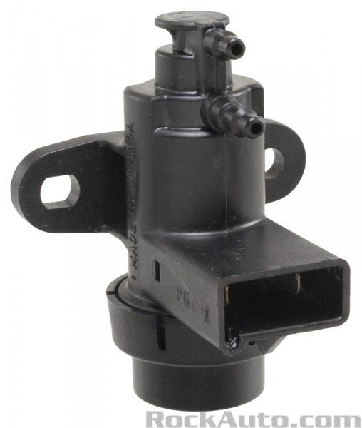

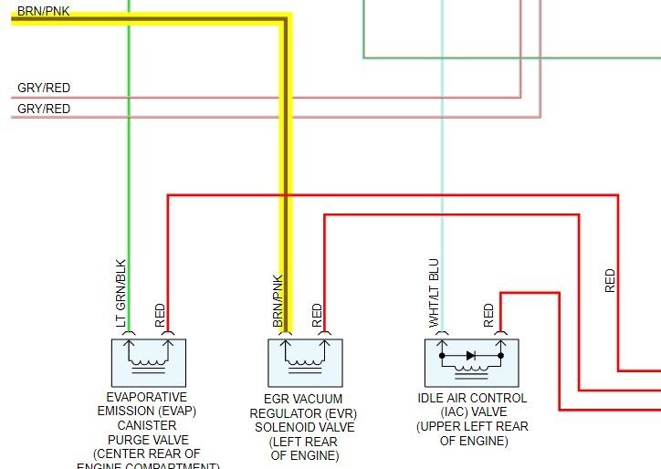

P1409 is a circuit code. It means that the PCM isn't seeing the voltage it wants to see from the EGR vacuum regulator valve based on how far it is commanding the EGR to open or close. The terminals on them are prone to corrosion.
The EVR is a solenoid valve as in the image below. It should have a Red wire and a Brown wire with a Pink stripe on it. Disconnect it and use an OHM meter to check between the two terminals. You should get between 26 and 40 ohms. If that is in spec, measure the voltage on the Red wire, it should be battery voltage. The Brown/Pink wire is the control wire, It goes directly to the PCM at pin number 47. I would measure from the connector to that pin with the ohm meter as well, for that one you want less than an ohm if the wire and connector are good. If those test good it could be the driver transistor for that solenoid failed, however I suspect corrosion at a connector as it has been setting.
