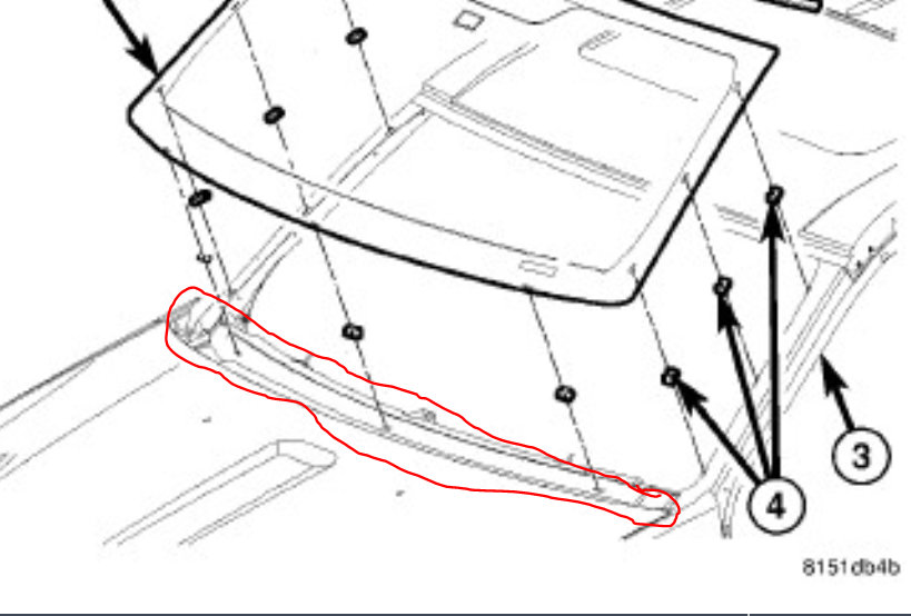

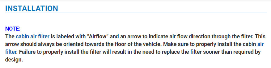

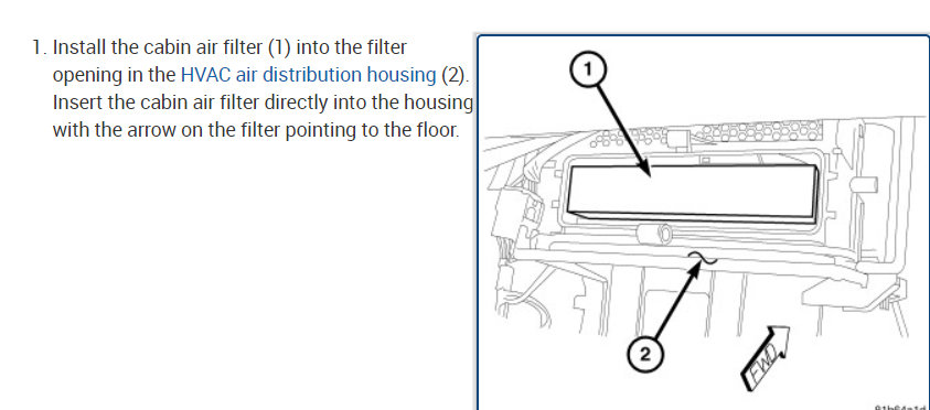

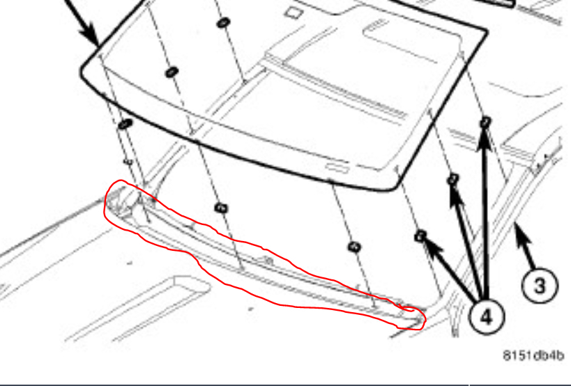

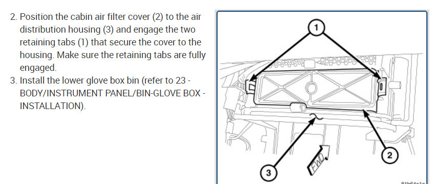

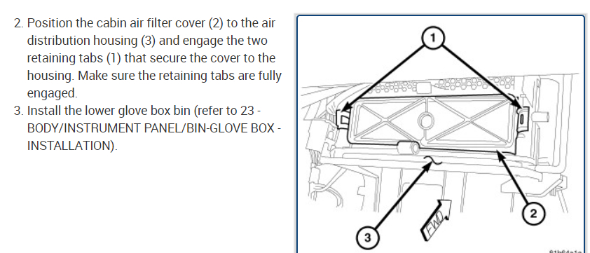

Here is the information you've requested. The area behind the back of the hood and the bottom of the front windshield is called the cowl. That is where all the air is drawn into the van for heating and cooling. I always suggest for people to spray an entire can of Lysol spray into the length of the cowl to help eliminate bacteria and smell. Here is a tutorial showing what is involved for cabin air filter replacement:
https://www.2carpros.com/articles/how-to-change-an-air-cabin-filter
I've attached picture steps below for cabin air filter replacement and the front cowl location for your van. Hope this helps and thanks for using 2CarPros.

Yes, you can have the A/C on when you spray into the cowl area because you want the fan to be running. Just be sure to have it in the intake setting and not recirculation. Nothing will get damaged it just helps with smells and germs. If you can see if you can remove any debris or junk to help with smells. Hope this helps and thanks again for using 2CarPros.
