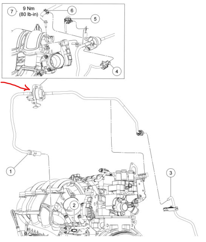

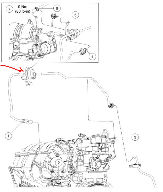

I am not sure on the cat cleaners but it might be worth a try. I have seen an EVAP purge valve stick open and allow excessive gas vapors into the exhaust system, here is the location so you can remove it to see if you can blow through it which if you can it is bad. FYI. Check out the images (below). Please let us know how it goes.
