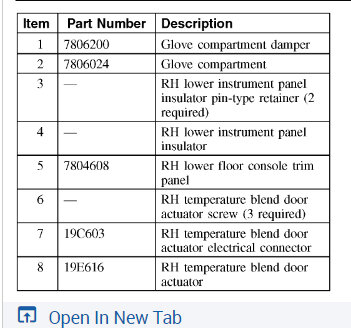

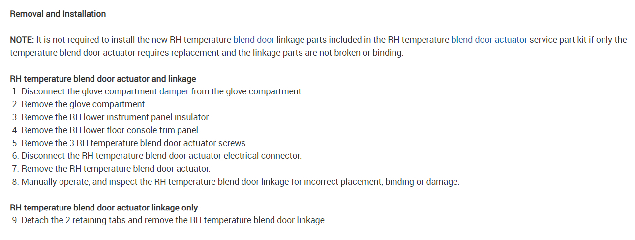

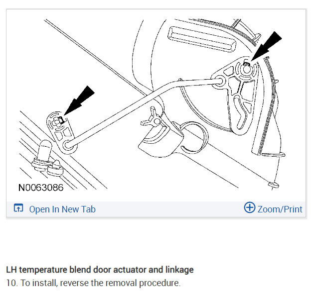

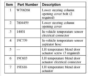

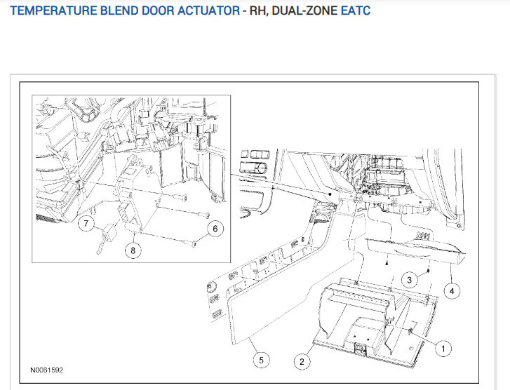

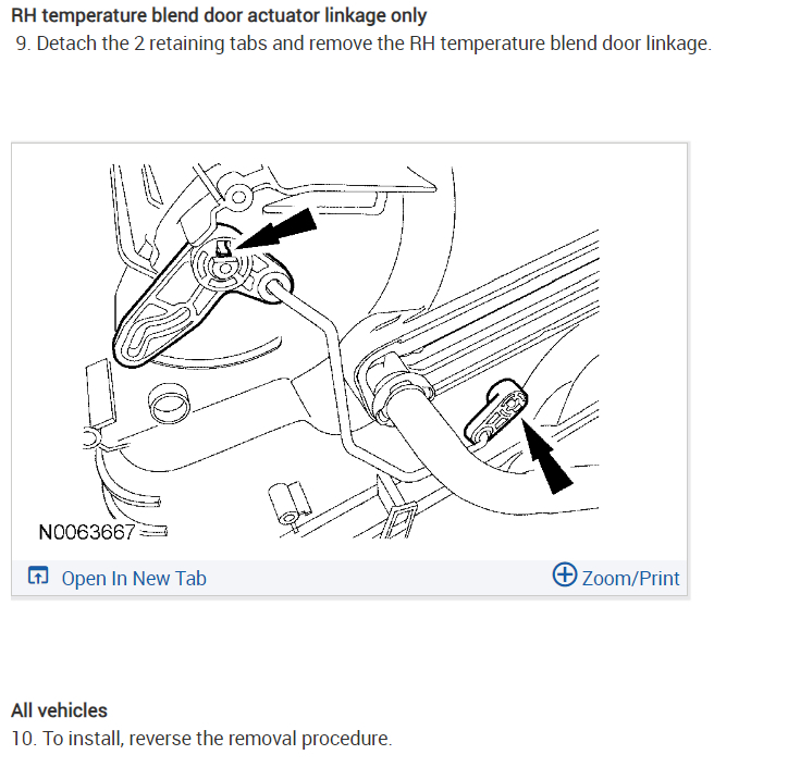

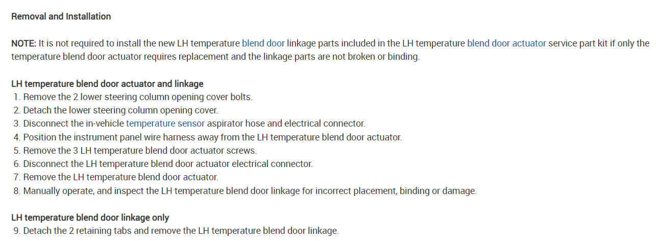

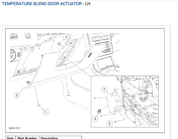

Could anyone please help me out with the location of the blend door actuators left and right. The vehicle listed above has 1.8tdci diesel.
Sep 21, 2024 at 5:20 PM

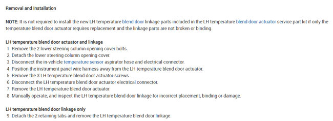

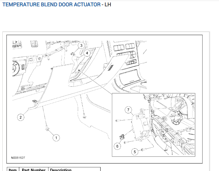

Sure, the left side blend door actuator is behind the dash trim panel and the right side is behind the glove box, here are the location and the instructions on how to change them out in the images below. Check out the images (below). Let us know if you need anything else.
