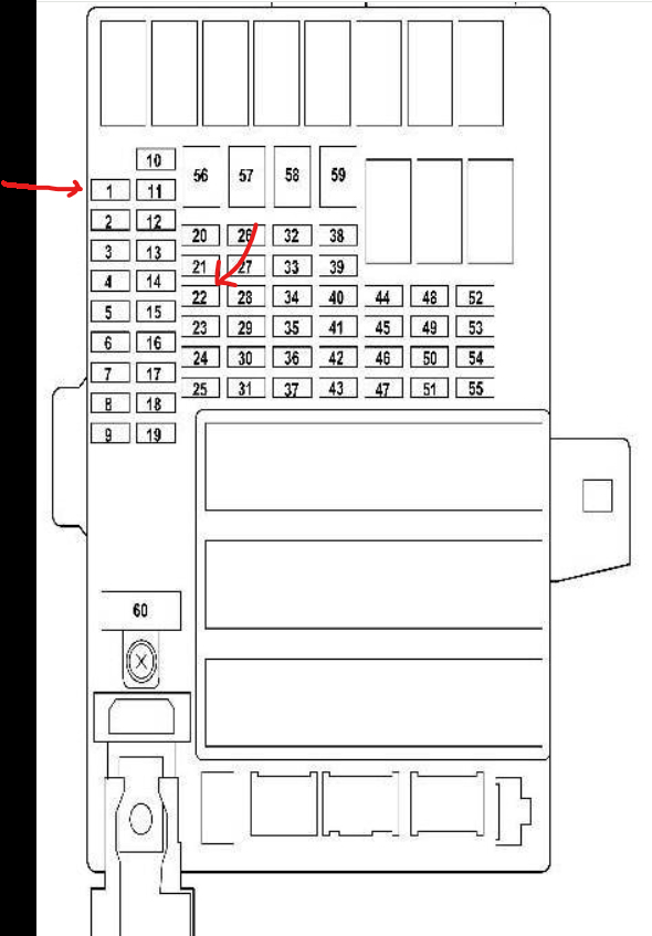

I recently was looking for my cigarette lighter fuse for the front panel of my car, so a removed all the fuse to check for any blown one but was not successful in finding that fuse and I don't have a car manual sadly as I bought mine used. After I tried starting my car and realized it would not start unless I held the key fob directly over the push start button, there was no light in the dashboard when I enter the car which usually shows up once I enter with the key. I tried locking the door using the remote, however it would not lock. So, I changed the batteries in my remote but the problem persists. I then went for my OBDll tester and realized it would never power own. So now I am wondering what may have been the issue or what fuse might be the issue if any.

So, is this an electric car? It sounds like the MICU has one out inside the dash fuse panel. But first let's check the fuse #1 and fuse #22 here is a guide to help you with the fuse locations in the images below also I found this video which can help.
and
https://youtu.be/6Tlg3JmgNSQ?si=15Smi3FxYuqRrrxc
Check out the images (below). Please upload pictures or videos in your response to the problem so we can see what's going on.

Thanks much, I actually was watching your video via YouTube and then decided to contact you. I have found the issue. So apparently it was a misplaced fuse in the engine bay that was the cause. Thank you for the quick reply.
