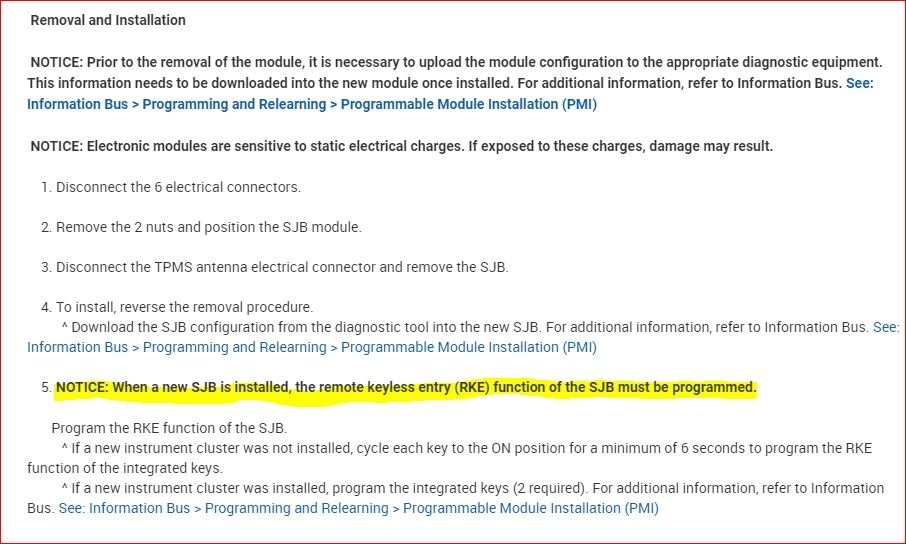

My right front directional stopped working but all others were working fine. I replaced the smart junction box with a used one which solved the problem. Now neither of my key fobs work. I can't lock or unlock the doors, unlock the trunk or set the alarm. Do the fobs need to be reprogrammed and if so, is there a way to do it without taking the car to a dealer?

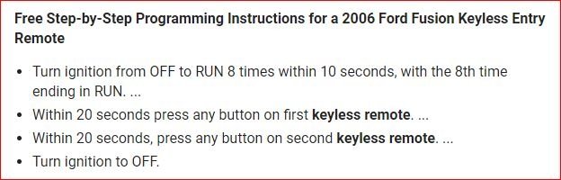

Hi Laurie,
You definitely need to program them and should be able to do it yourself.
There may be an issue due to it being a used module but I doubt it. Here is a video and written instructions. Let me know if you have trouble and we can try something else.

Thanks for getting back to me. I did everything as described in the video. The locks engaged and disengaged as shown. When I hit the button on the fob, the alarm (horn) went off twice, but the fob still isn't working. I did replace the batteries in both fobs but still no luck.
