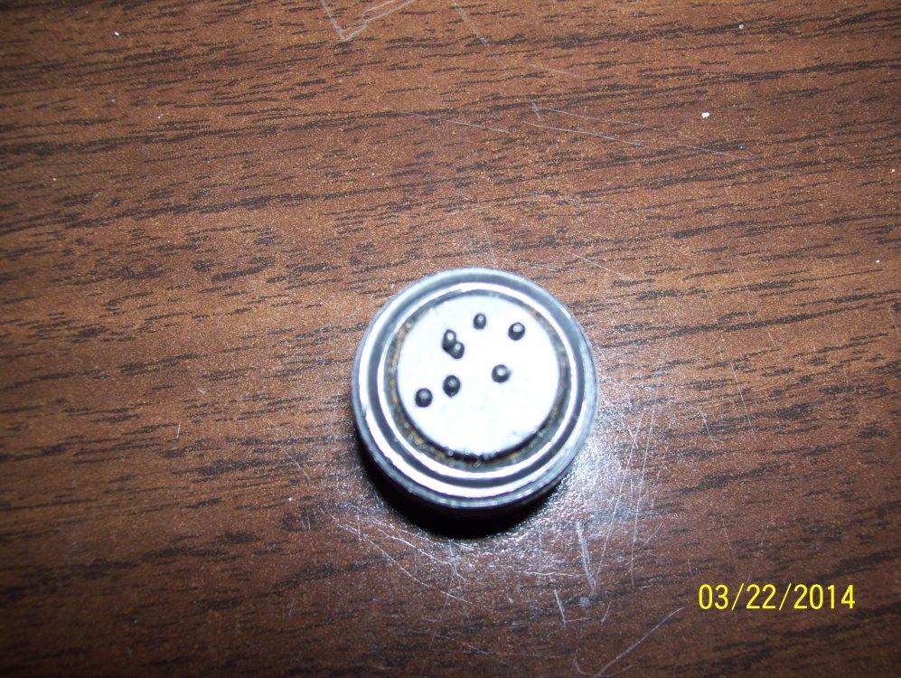

When I changed my differential oil in my Dana 30, veri-loc front axle in my 2001 Jeep Grand Cherokee with quadra-drive, there was just normal metal shavings on the magnet but in the bottom of the pumpkin I found several very small metal balls, maybe ball bearings but have never seen any this small on any vehicle, what could they be and is this serious? The pic is the balls on the fill plug magnet, and the magnet is less than 1" so you can see how small these are.

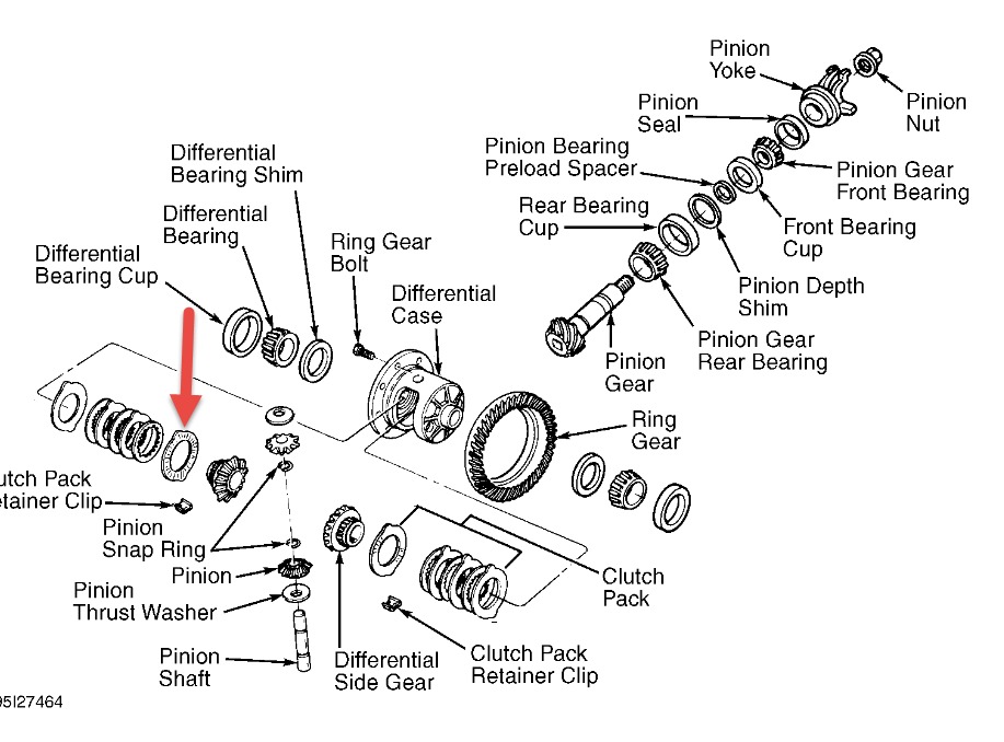

it cold be small pieces of metal coming off of the clutch plates inside which I've pointed to in the pic. I really wouldn't worry about it to much , the car is 13 yrs old an is going ot have some wear. As long as it continues to operate ok and not make any noises let it go. or drive it til it breaks which may be years from now.

These little round balls could be coming off a clutch plate? Not doubting you but how could they be round? These are not slivers, they are round.

that is the only thing I can think of as the clutch plates that I pointed to are steel and from wear they may begetting worn round andfall off or they are getting mashed in the gears because they are small it won't hurt it to much. If it were bearing material they are very hard and when they go bad they peel off, kinda like chrome peeling if you have ever seen that. regardless I don't think it is something to be worried over and just drive it.

YOUR PIC NEVER ARRIVED
MY HYPOTHESIS IS THE BALLS ARE "CAST IRON SPLATTER" FROM THE CAST IRON CASE BEING POURED
ALL OF THIS CRAP GOES THRU WASHED, ETC TO CLEAN 'EM UP AFTER THEY ARE CAST
SOMETIMES THE SPLATTERS ARE SORTA WELDED/ STUCK TO THE CASE INSIDE AND OUT......DRIVING HEAT (EXPANSION / CONTRACTION)/ BOUNCING/ GEAR OIL FLOW AS THE GUTS TURN INSIDE MAY HAVE DISLODGED THE ONES YOU SEE------HECK, THERE MAYBE OTHERS "STUCK GOOD" STILL ON THE CASE

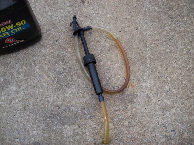

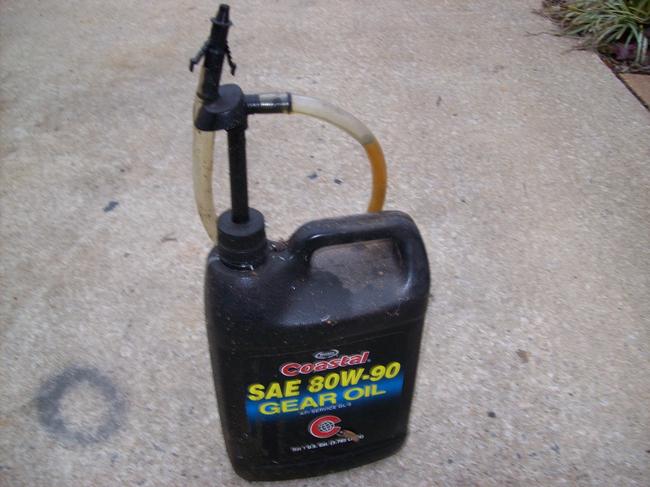

HERE'S A PIC OF A REAL EZ WAY TO INSTALL YOUR GEAR OIL.....THE PUMP IS LESS THAN $5 AT A PARTS STORE
WHEN THE FLUID LEVEL REACHES THE FILL HOLE (ON LEVEL GROUND) AND STARTS RUNNING OUT--GIVE IT TWO QUICK PUMPS AND STICK THE PLUG BACK IN FAST!.............DIGGING IN THE HOLE WITH YOUR PINKY FINGER DON'T CUT IT FOR CORRECT LEVEL......CORRECT LEVEL IS WHEN YOU PULL THE PLUG OUT FOR A "LOOK SEE" AND THE FLUID "JUST STARTS TO FLOW OUT!"

I will try to attach pic again. If these are clutch plat fragments is this why the front diff. (this Dana 30 veri-loc) going straight down the road is pretty quiet but turning a corner, the sharper I turn the more noise/grawling noise it makes, and in 4wd it's even louder, is this the clutch plates breaking down? Does the axle need rebuilding when this happens or just part of the breakdown/wear out process?
