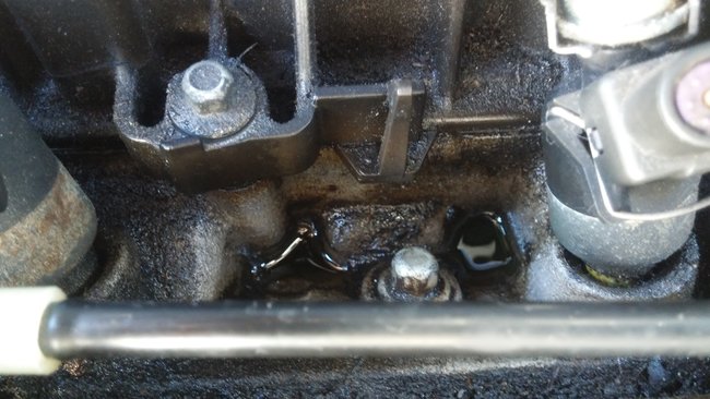

I have noticed that there is what looks/seems to be small amounts of oil, on the engine just below the upper intake manifold gasket, and it is sitting in the little pocket crevices, i usually get a rag and use my pinky to absorb it. Help! but, the car starts right up though, i usually have to turn on A/C fans to keep temperature stable.

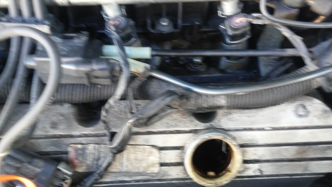

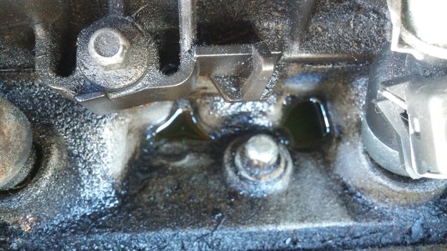

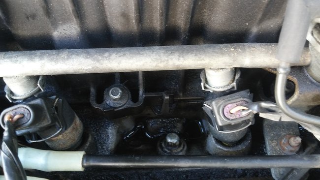

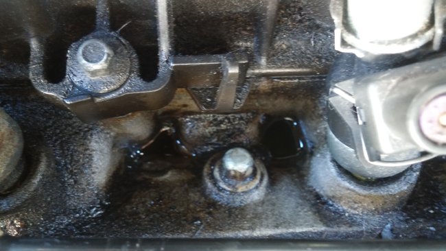

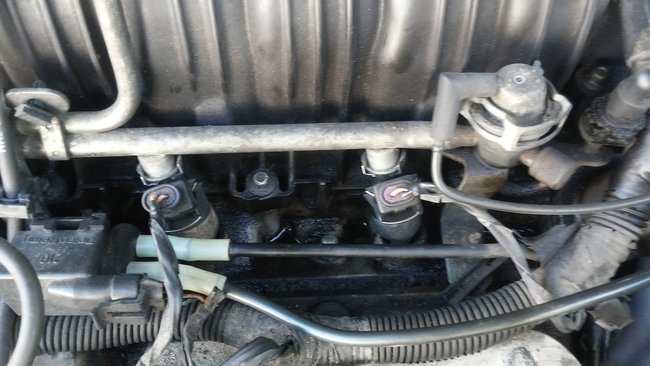

I sent some pictures, and if you look at the middle towards the bottom of each photo, you can see the two oil spots/miniature puddles.

Hey DWIGHT,
That is definitely an valve cover gasket leak, here is a guide on how to change it. Once competed clean up the oil and the problem should be gone.
