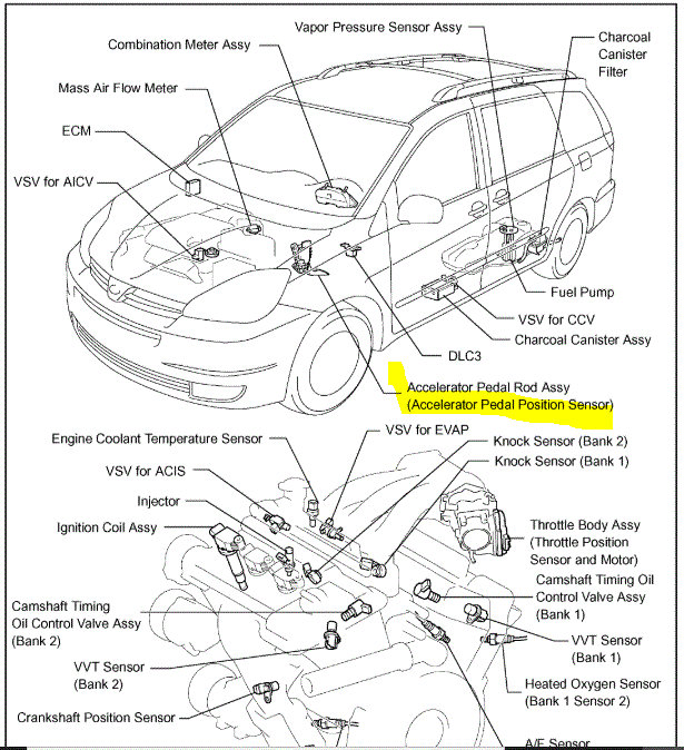

I want you to do me a favor. If possible, recode this with your phone and upload it for me to see. From a stop, press the accelerator at least half way and hold it. Does it still not respond? I'm asking because the accelerator pedal has a sensor which could be loose or going bad. That is what signals the throttle assembly to accelerate the engine.
I attached a pic below. Let me know if you had the can bus system scanned.
