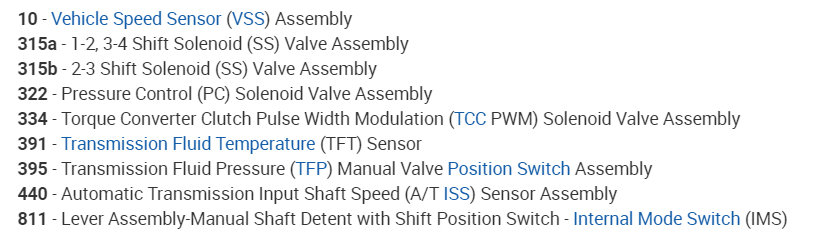

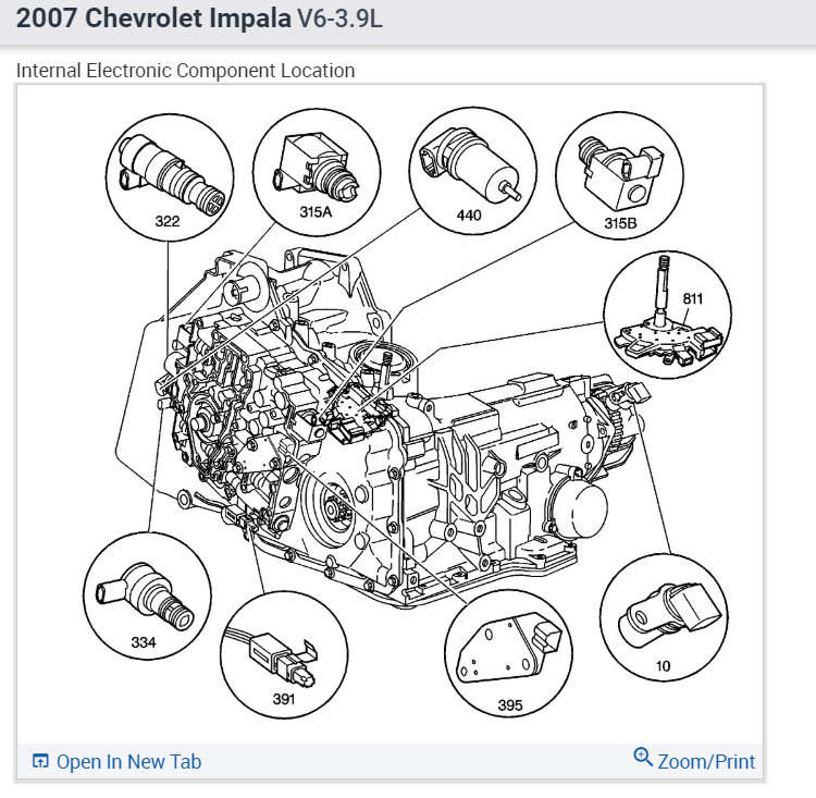

This sounds like you could have an input shaft speed sensor that is not working right. First lets scan the PCM for codes to see what comes up.
Here is the location of the sensor so you can replace it. Check out the diagrams (below). Please let us know what happens.
