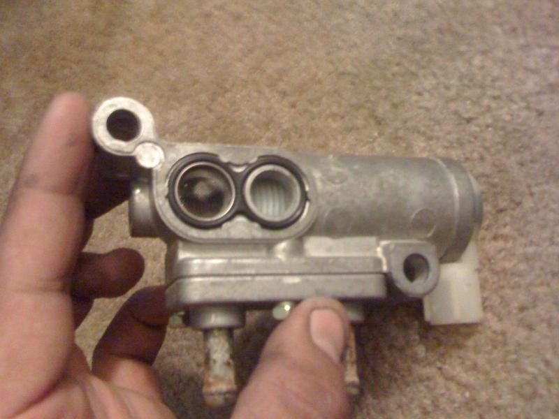

Normal operating temperature idle for the vehicle listed above (Si model) is around 750 rpm however mine is idling high at 900 rpm on operating temperature.
I've cleaned the IACV and FITV as well as throttle body.There are no apparent vacuum leaks from what I can see or hear. Coolant levels are normal, and the radiator fan operates as it should.
Jan 21, 2020 at 10:40 AM
AL514
  • 5,464 POSTS
Hello, Honda's are notorious for fast idle problems. What's going on is the fast idle thermo valve is not closing all the way. It's coolant controlled and located near the throttle plates. It will have 1 or 2 coolant hoses going to it. There is a cover with 2 screws that you can open and adjust the valve. You can even take it off and see if it's hanging open. I've seen most of them are adjustable for some reason. It should look something like this. I would check that first unless you have a vacuum leak. But start with checking this valve that it's not clogged up coolant passages or adjusted it's way out.

Okay, so I've taken off and cleaned the part referenced and reconnected it. I thought I'd take the throttle body off as well to make sure the plate was free of debris.
Now that it's all back on, when I start the car it idles rough at 2100 rpm and has a very loud and very high pitched whine. No idea what I've done or could have caused this.

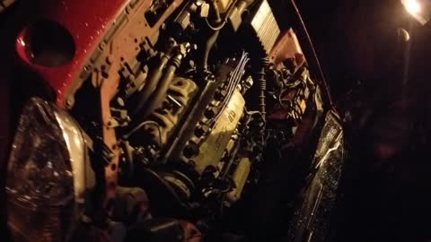

Here's a video of the sound I'm trying to explain. Friend who recorded it stated it sounded like it was near my intake manifold.

That is a crazy sound, so this sound started when you removed the fast idle valve? I would remove it again and see if it's stuck in one position. If the noise started there, it must be related. Although I've never heard one make that noise. Does that fast idle valve have any electrical connections? If so try unplugging it. That sound is of electronic in nature, but the high idle was caused by you removing the throttle body, the gasket should be replaced and torqued to spec. There is a vacuum leak around the throttle plates. Get the idle to come down first and see if the noise continues. Did you pull the valve apart when you had it off the car?
