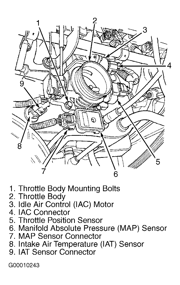

vibration at idle, feel it in steering wheel, and body. replaced IAC, TPS, MAP and all three motor mounts. runs real good, but gas mileage is not good at eleven mpg, over 900 rpm vibration is gone. thanks for any help.

Check for engine misfire trouble codes and when and if you get a P001-006, check for an intake manifold vacuum leak near the cylinder that is misfiring at idle.
