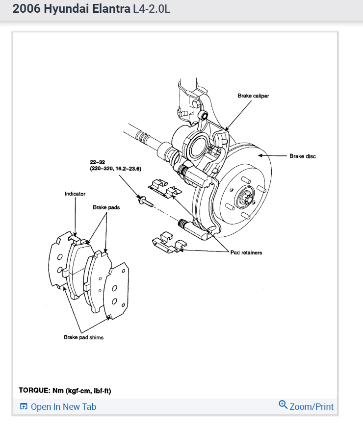

This happens when the brake replacement parts are sub par which create this problem, I would have the brakes redone with top quality parts. Here is a step by step video to change the pad and rotors out.
https://youtu.be/7zjHSFVangI
