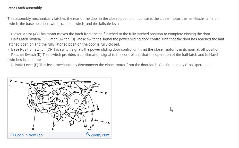

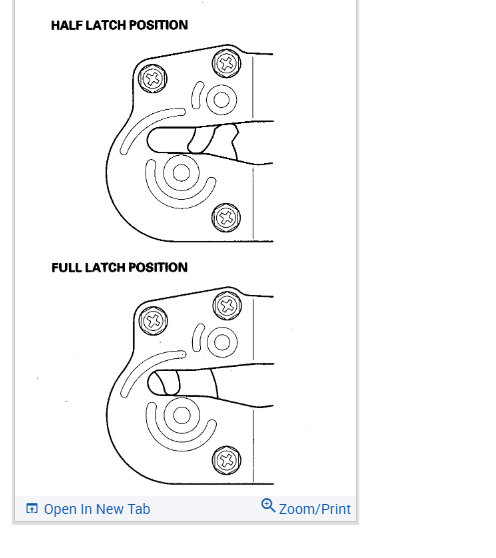

Okay. All good points. As you said, I think the issue you are having rests in the operation of the latch. The best way I can describe it is the latch has two stages. Half latched is the first stage. This is where the door motor slides the door forward and the tracks guide the door in so that the front and rear latches make contact with the strikers which are the hooks on the body of the vehicle. When they make contact there is a switch that is flipped to tell the latch motor to move from the open position to the half latched position. This is means it closes the latch around the striker. Then it begins to move to the second position which is the fully latched position. To do this, the motor closes the latch even more and this action actually pulls the door in the rest of the way and locks it closed.
The fact that it is beginning to close shows the motor can grab the striker but is not able to pull the door in. The reason is, the motor is either weak or the assembly is binding.
