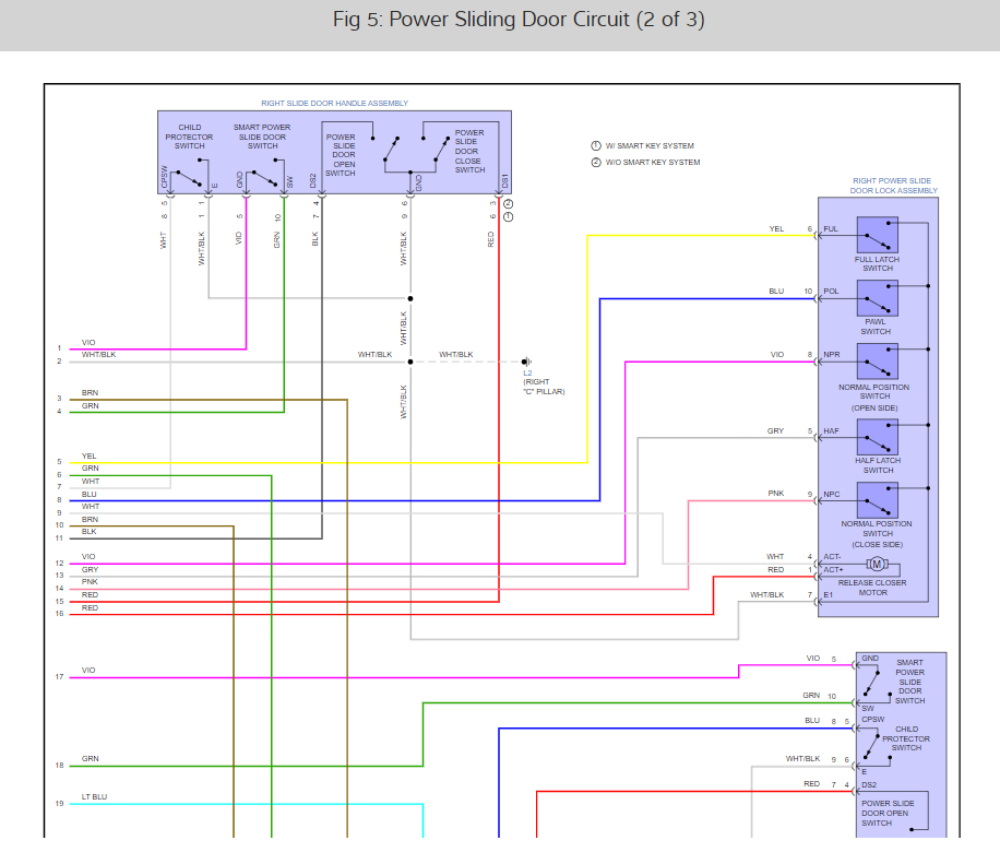

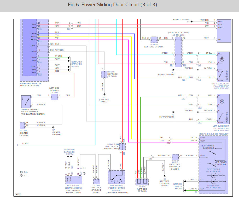

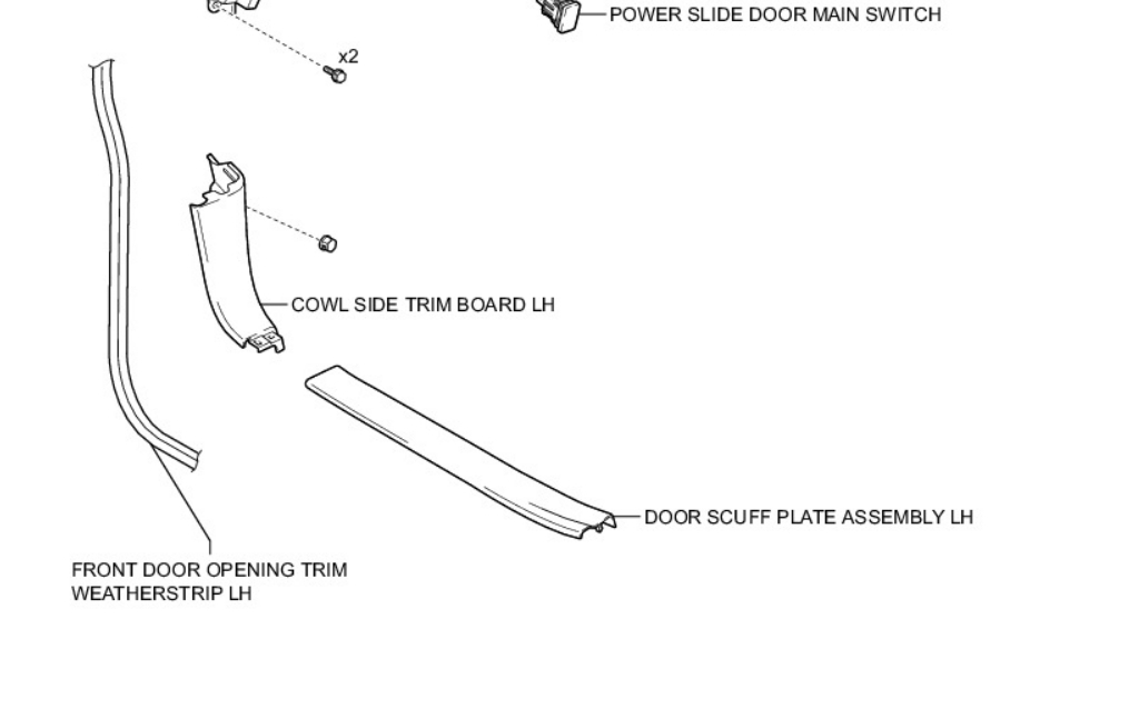

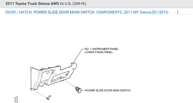

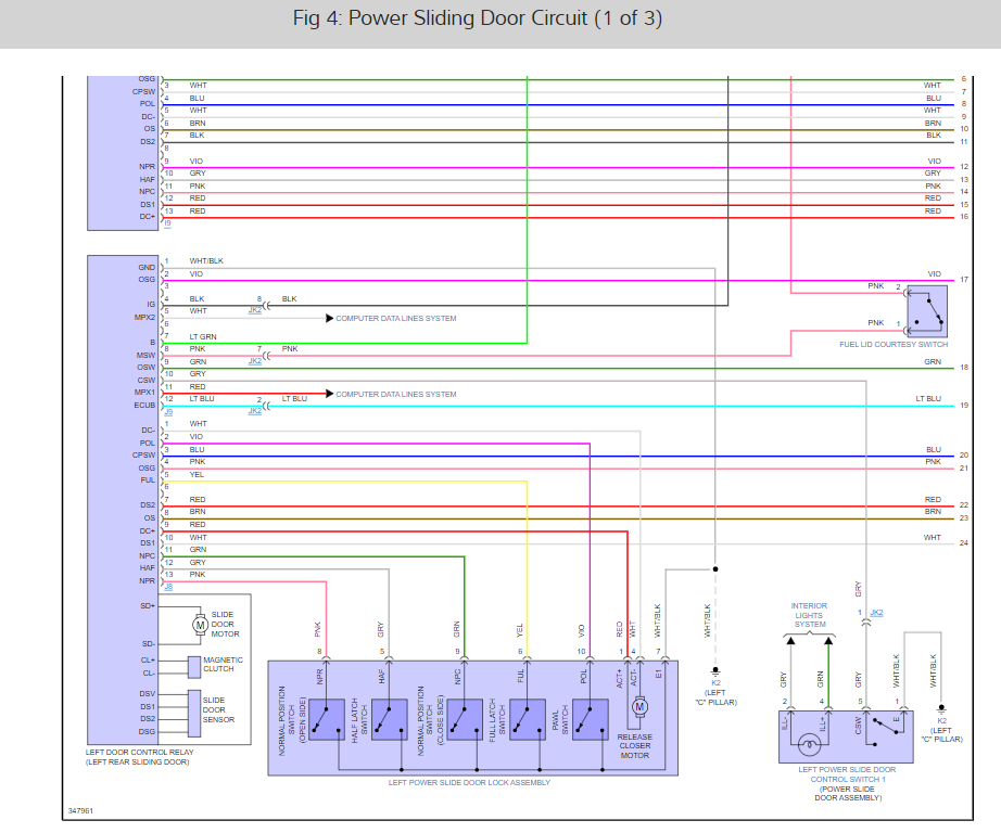

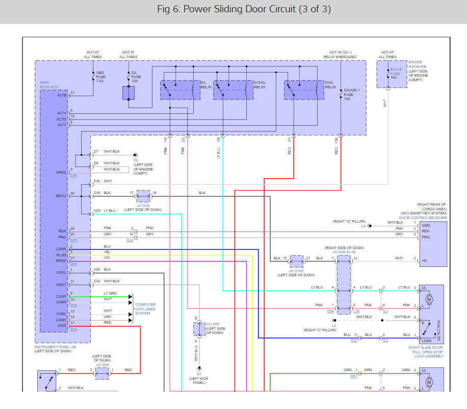

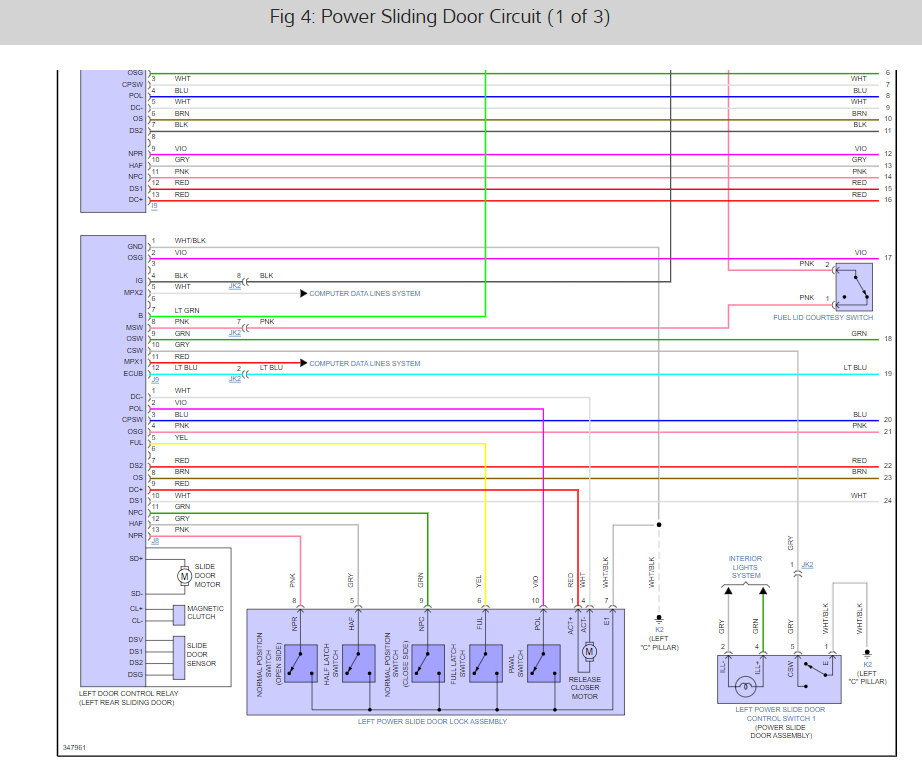

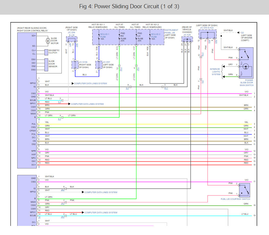

sliding doors open with remote and the buttons by the doors, but not the switch in the overhead.
Oct 23, 2022 at 3:00 PM

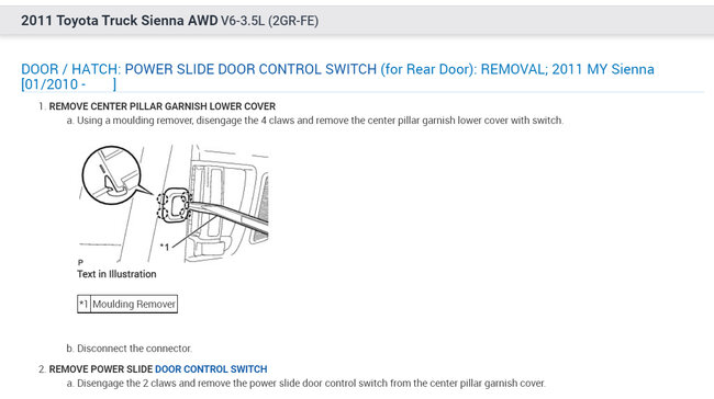

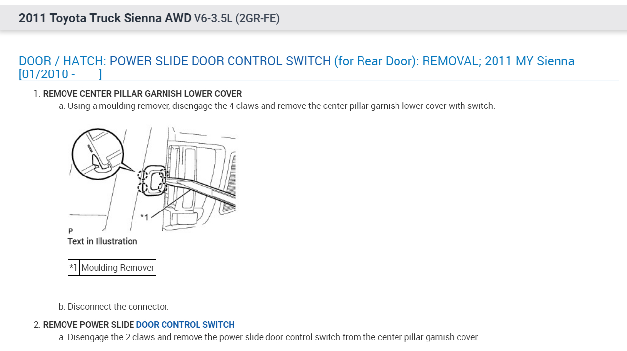

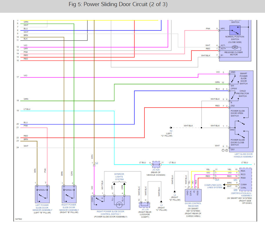

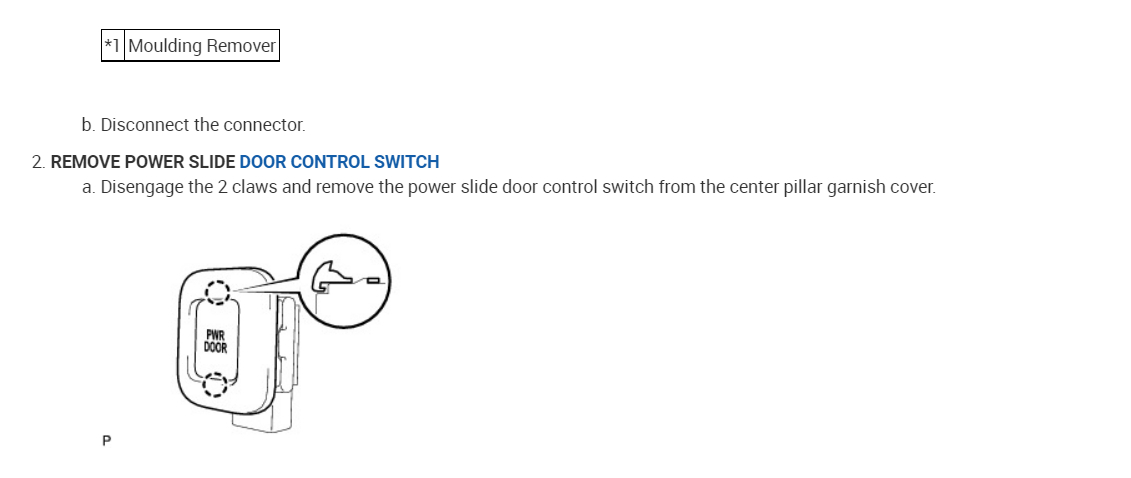

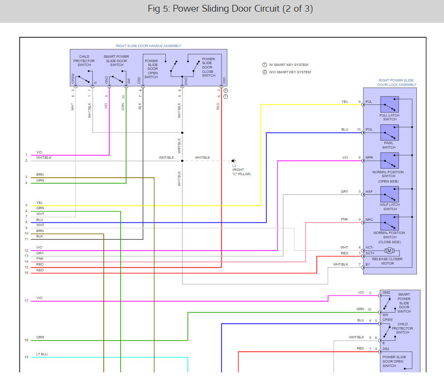

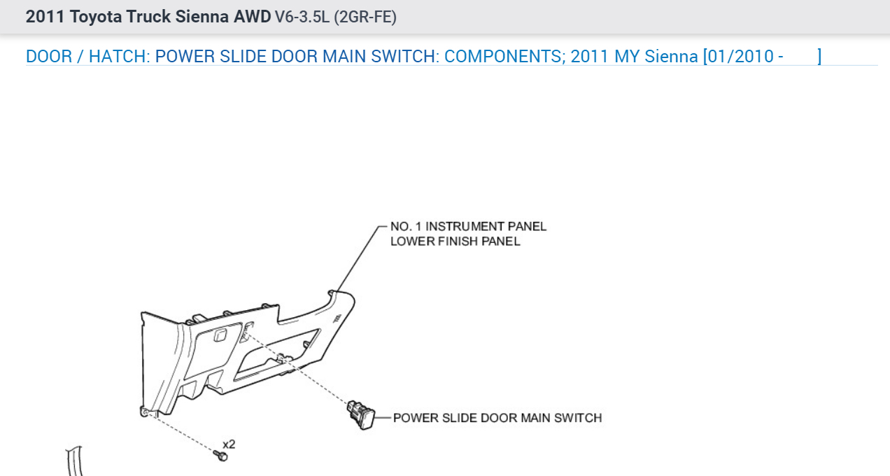

It sounds like the switch has gone bad, but here are the sliding door wiring diagrams so you can see how the sliding door works and which fuses to check. Also, I have included how to change the switch out in the images below. Check out the images (below). Let us know what happens and please upload pictures or videos of the problem.
