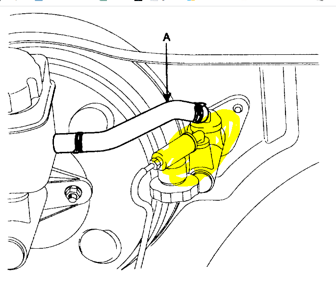

It is likely either the slave cylinder, as you mentioned, or the clutch master cylinder. Have you checked the brake fluid level to make sure it isn't low? The brake master cylinder is what supplies hydraulic fluid to the clutch master cylinder. See pic below.
Also, is there anything wet near the slave cylinder or clutch master cylinder on the firewall?

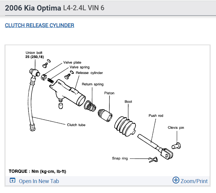

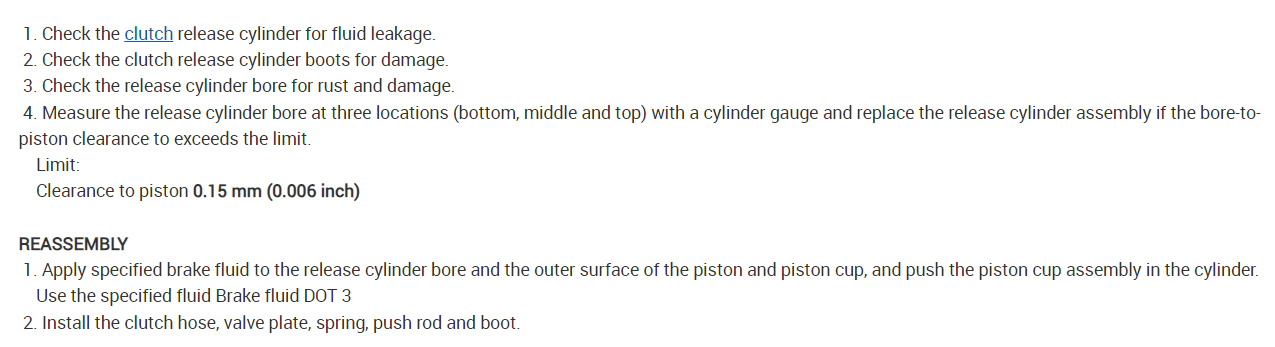

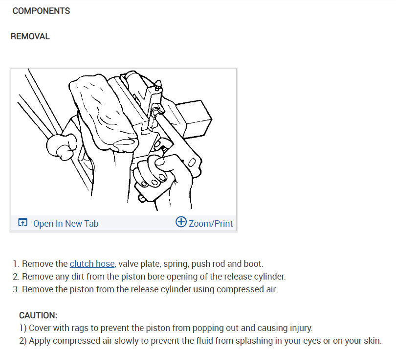

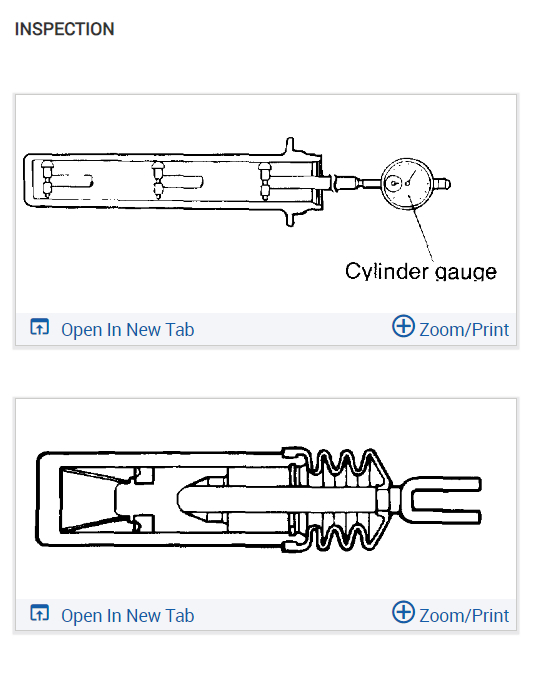

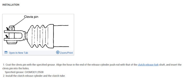

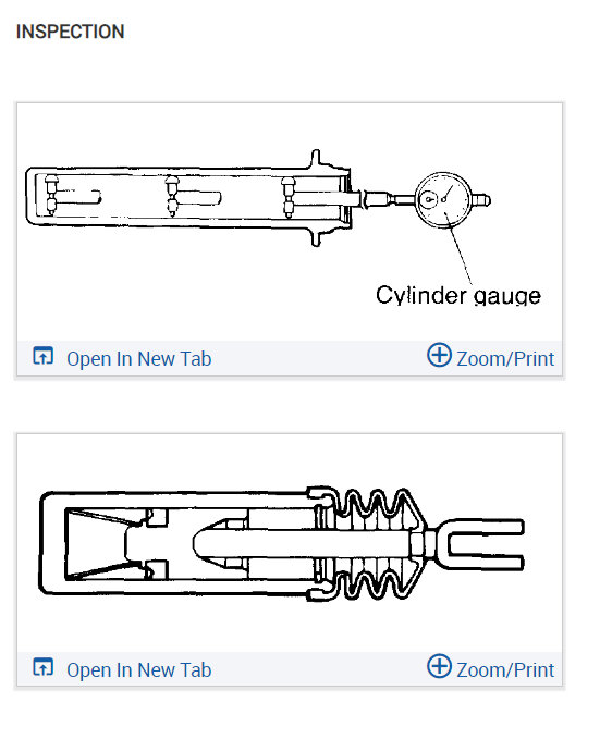

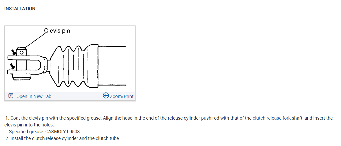

Can you upload an image of what you are seeing? Here is what the secondary cydliner should look like and I have included the replacement instructions as well.
