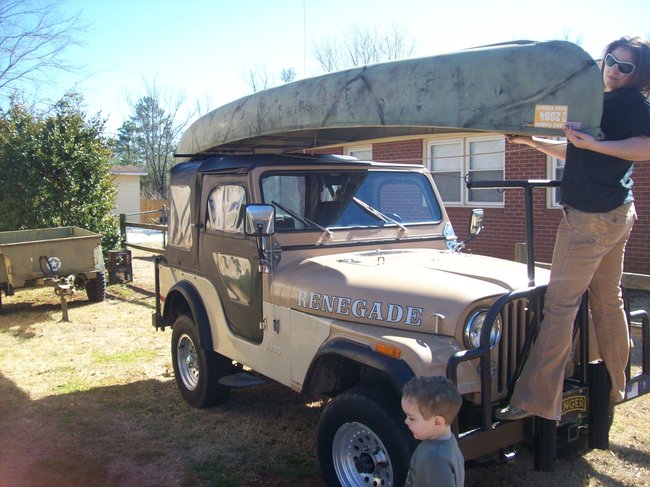

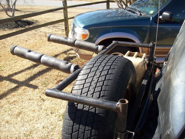

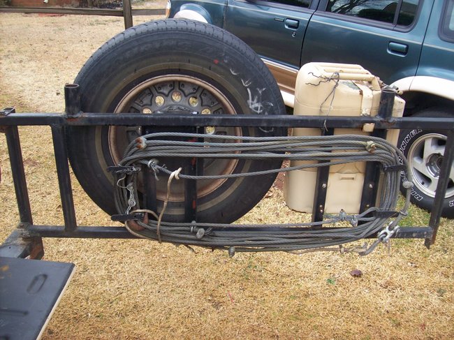

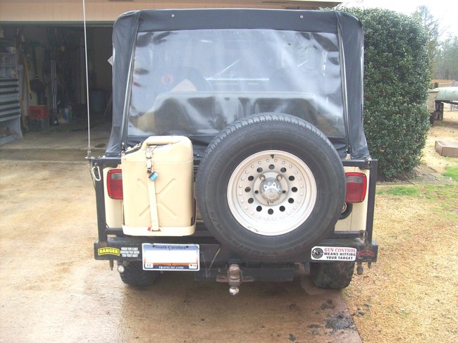

I HAD TO MOVE MY SPARE FROM THE SIDE, TO THE BACK OF MY 1977 CJ-5, AS I DRAGGED IT OFF ON TREES A COUPLE OF TIMES!

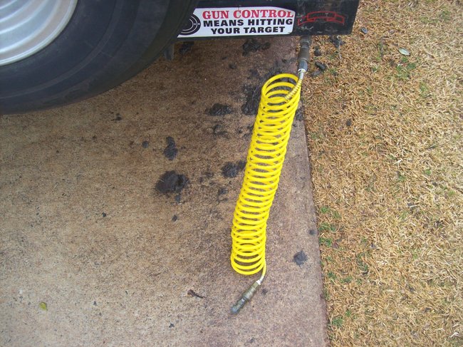

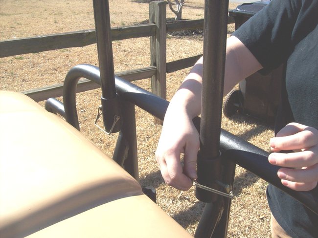

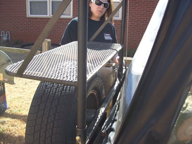

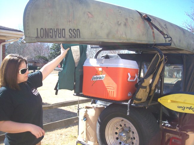

NOT ONLY DID I MAKE A SWING GATE, I MADE THE BUMPER INTO AN AIR TANK (FOR AIR AND MY AIR HORN), AND ADDED SOME QUICKLY REMOVABLE RACKS FOR MY CANOE. I HAVE A RACK ON MY '46 SO I CAN USE THE TAILGATE.

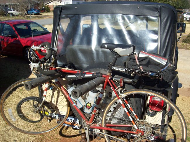

MAYBE THEY MAKE A BIKE RACK THAT COULD ADDED TEMPORARILY ONTO YOUR VEHICLE?
IF SO, MAYBE IT CAN BE MODIFIED FOR CARRYING WHEELS?

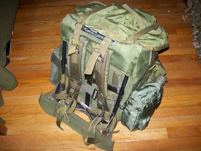

WHEN I WAS AN AIRBORNE RANGER IN THE ARMY, WE CARRIED A LARGE ALICE PACK (BACK PACK). IT WAS PRETTY MUCH A GIVEN THAT WHEN IT WAS SLAP FULL OF EQUIPMENT, THEY WOULD CONTINUE TO HAVE US ADD "JUST ONE MORE THING" INTO IT. SEEMS IT COULD ALWAYS HAVE MORE AND MORE CRAMMED INTO IT.
SOUNDS LIKE THAT IS WHAT YOU ARE DOIN' WITH THE OLE "SONIC"
YOU MIGHT KEEP IN MIND THAT IT WASN'T DESIGNED TO BE A UPS TRUCK!

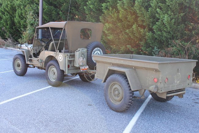

MAYBE EVEN CONSIDER A SMALL U-HAUL TRAILER (EVEN I GOT A TRAILER FOR MY JEEPS!)
