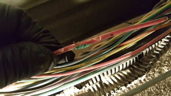

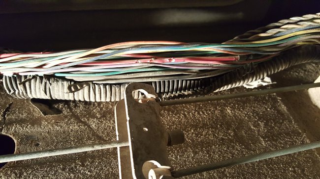

It was bad red white stripe wire that powers the module I would get 12v at module but I guess it was to week to power it was bad right by the frame under Cabinet thanks for all help not sure how it happened i attached some pics

Maybe chewed up by a rodent. Glad to hear you found it.
