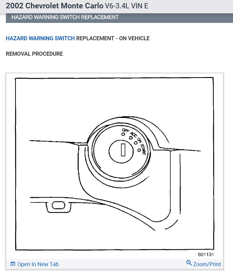

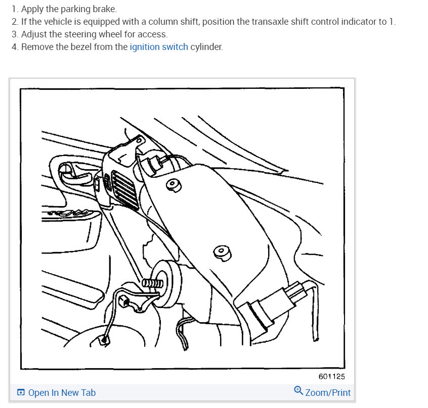

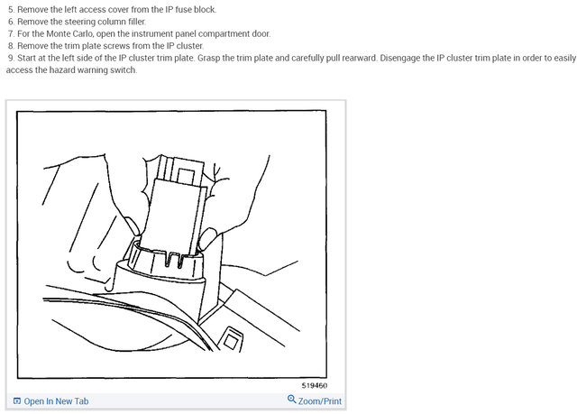

It sounds like the hazard/turn signal flasher module is out. here are instruction to replace it in the diagrams below. Please let us know if you need anything else to get the problem fixed.
