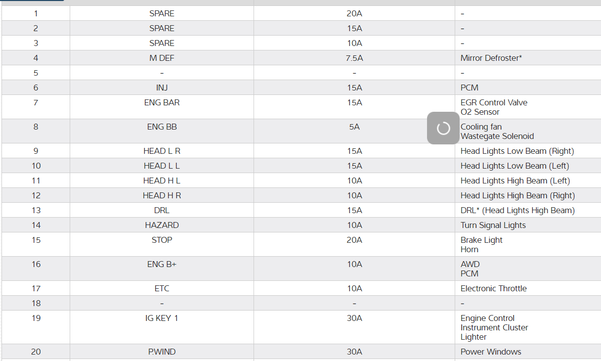

My turn signals and hazard lights will not come on. And it is not the bulb, but I do not know which fuse controls my turn signals.

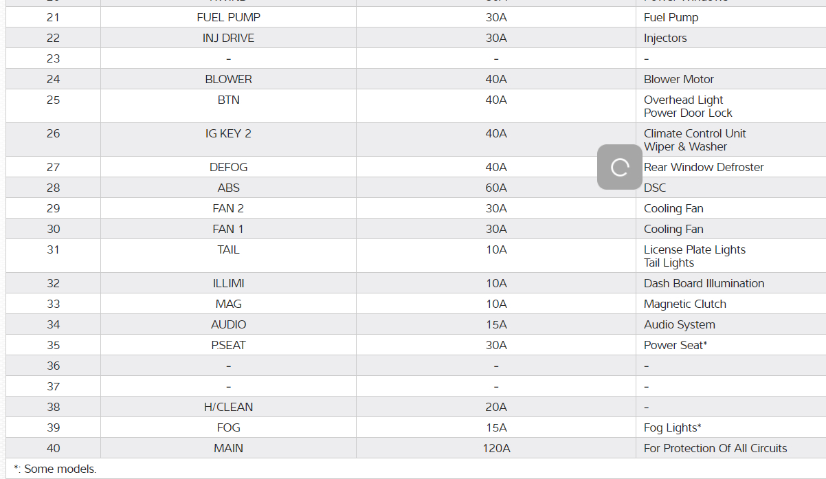

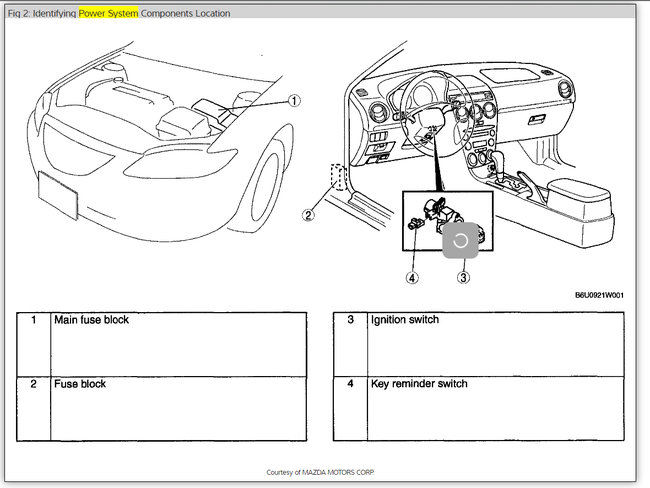

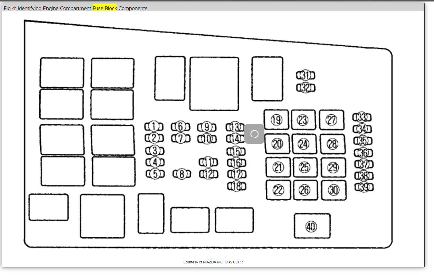

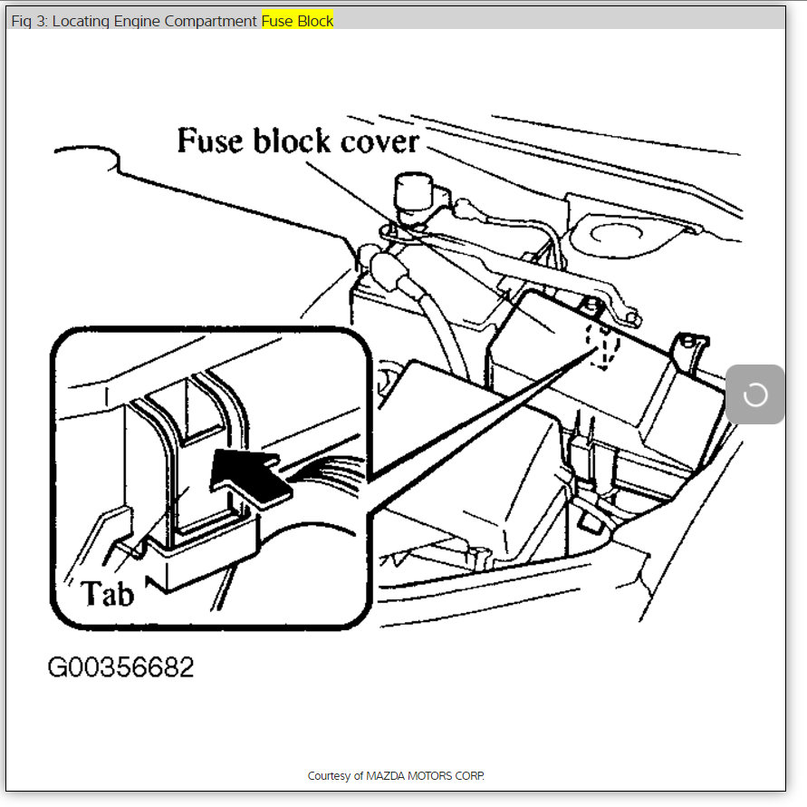

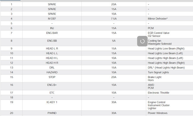

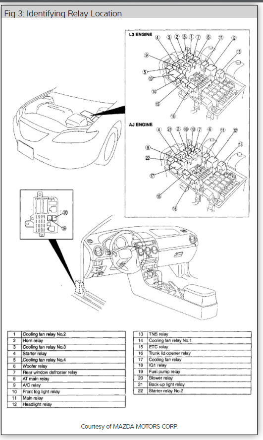

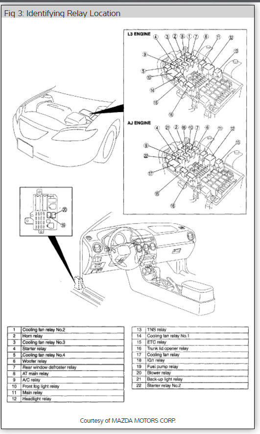

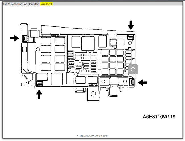

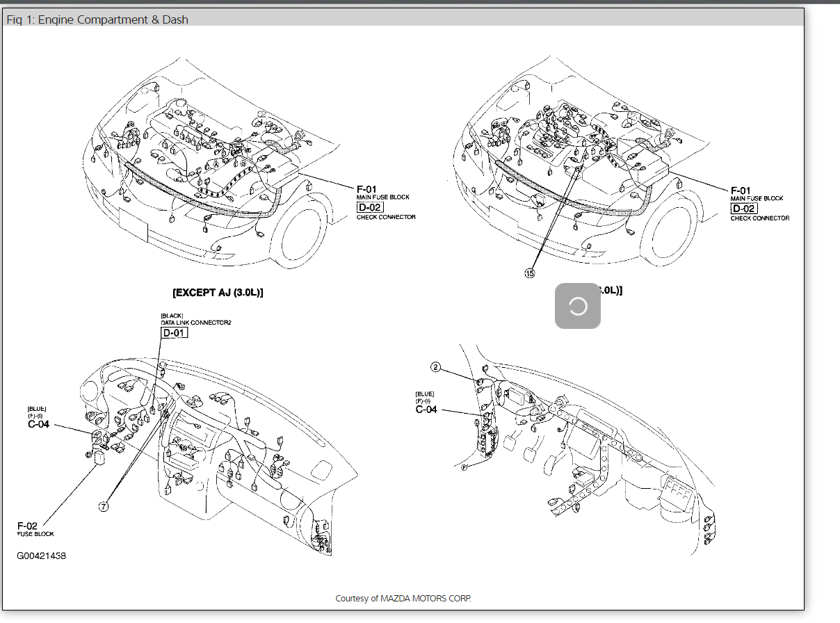

Lets get the problem fixed, the fuses are a great start. Here is a guide and some diagrams to help you check the fuses. Key on engine off.
Jun 18, 2020 at 1:31 PM (Merged)

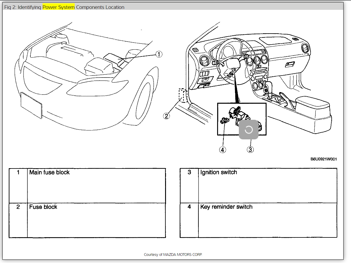

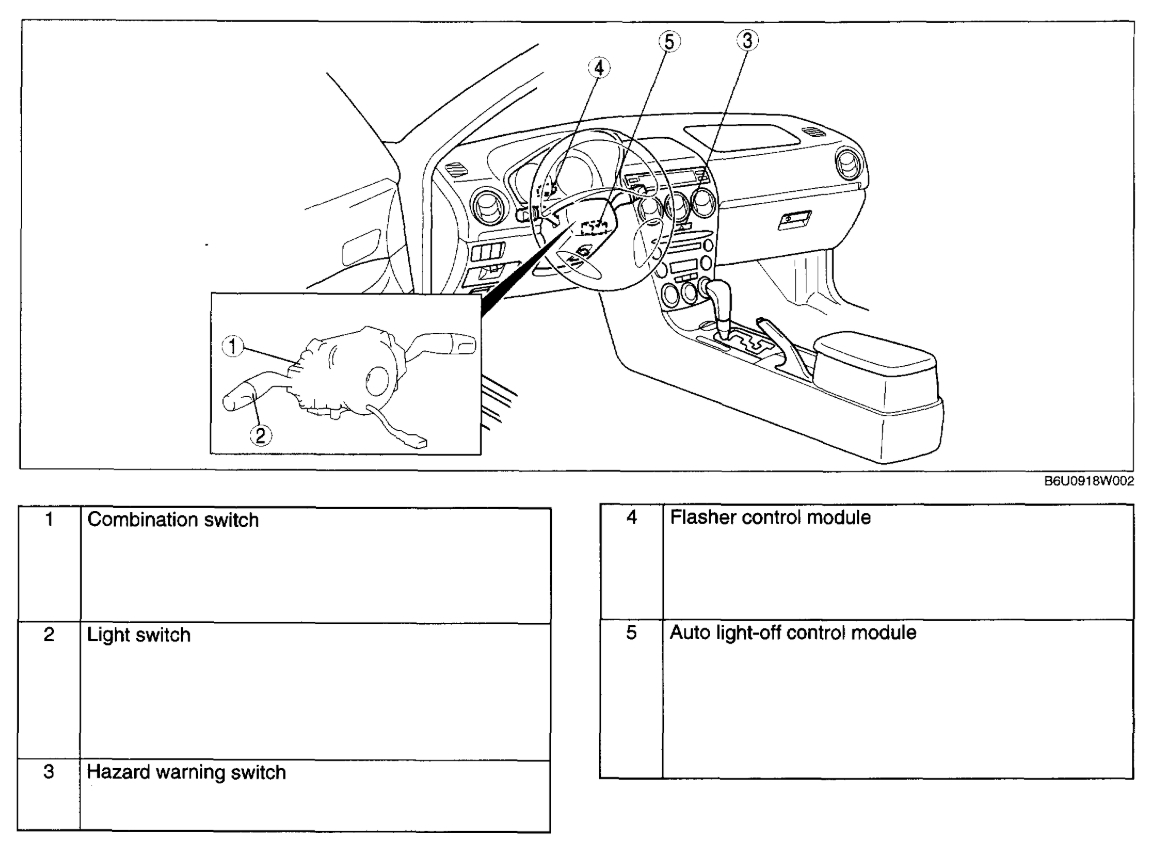

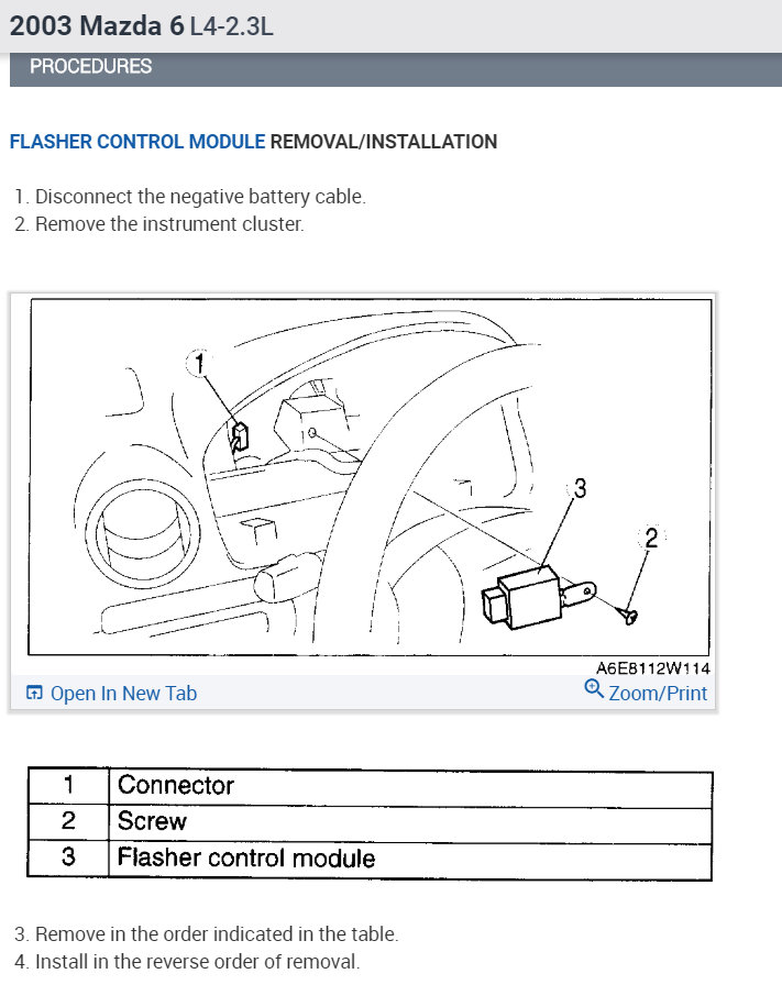

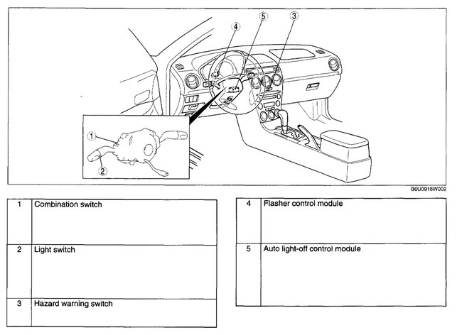

It sound like the flasher module has gone out which is behind the cluster here is a diagram to show you the location and how to change it out. Check out the diagrams (Below). Please let us know if you need anything else to get the problem fixed.
Jun 18, 2020 at 1:32 PM (Merged)
TIMMCGRAW313
I had this problem it was the flasher got a new one for $34.00 all fixed
