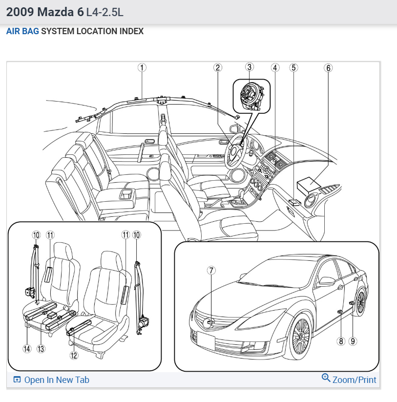

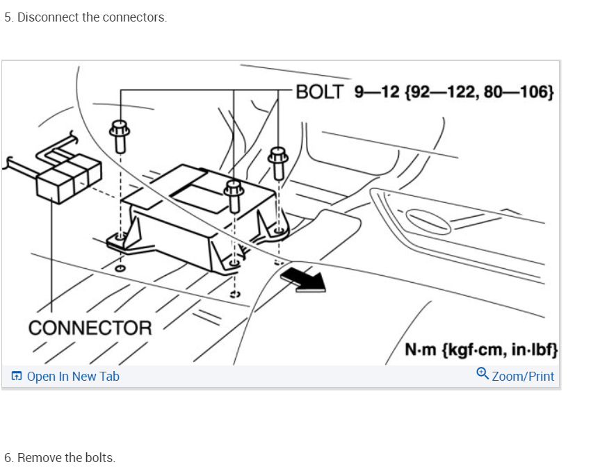

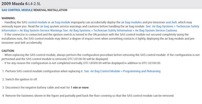

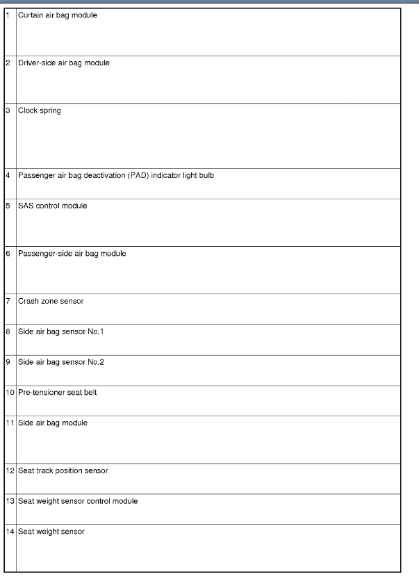

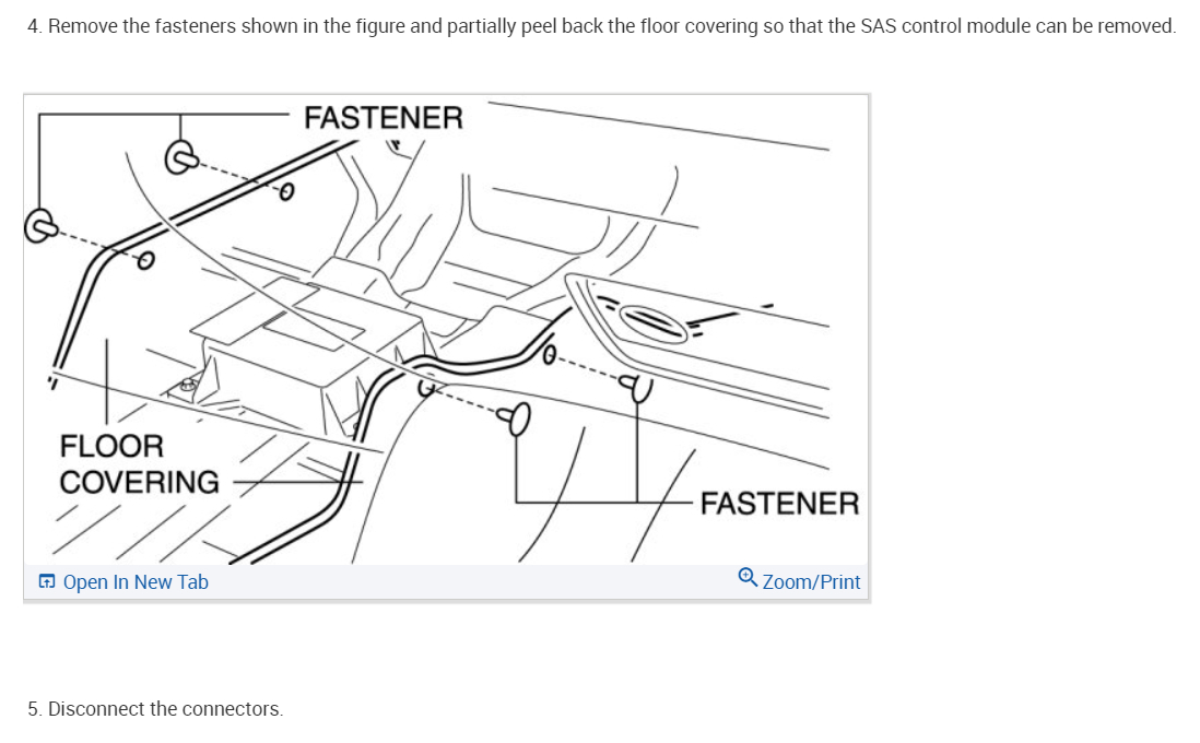

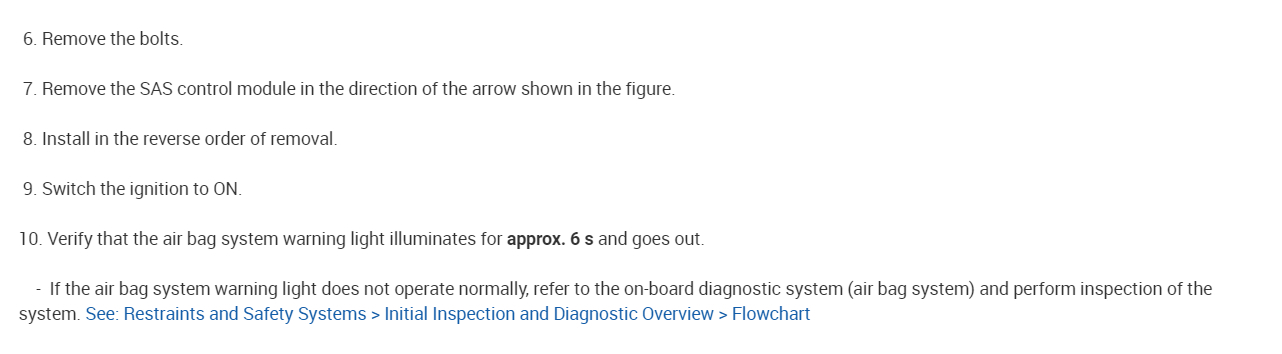

Yes, when the airbag light flashes the system is disabled. To me it sounds like the airbag module needs to be replaced but first I would check the electrical connector and look for corrosion which could cause the issue as well. Here is the location so you can check it out, and also disconnect the battery before you begin. I am not sure which link you are talking about; do you mean the one on the airbag code video? Check out the images (below). Please let us know what happens.
