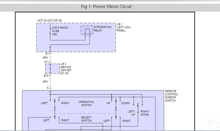

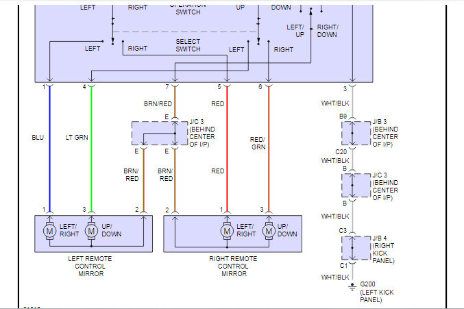

Hi Jesus,
I am sending the side mirror wiring diagram divided in two sections for clear picture. Check out the diagrams (Below). Please let us know if you need anything else to get the problem fixed.
