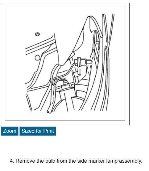

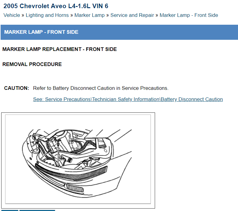

Here is a guide that will give you an idea of what you are in for when changing the headlight/side marker lens or bulbs with diagrams below so you can see how it will be for your car:
https://www.2carpros.com/articles/headlight-lens-replacement
