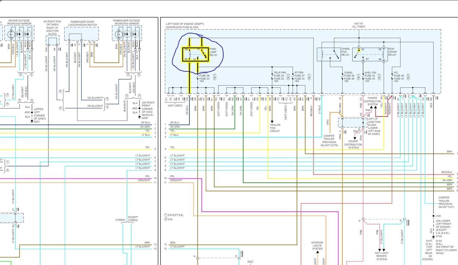

Good afternoon,
I attached a diagram of the system for you. Check the fuse for the battery light system. The cluster and the ECM control the light itself.

Did you test for power on both sides?
Check for voltage at the light green/red wire at the alternator for power with it running.
