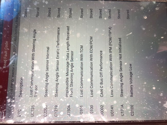

NASER NASER
  • 836 POSTS
codes before.
Apr 3, 2020 at 10:53 AM
Thanks.
Make sure the battery cables are clean and tight. The low voltage code may be the root cause of all the codes.
