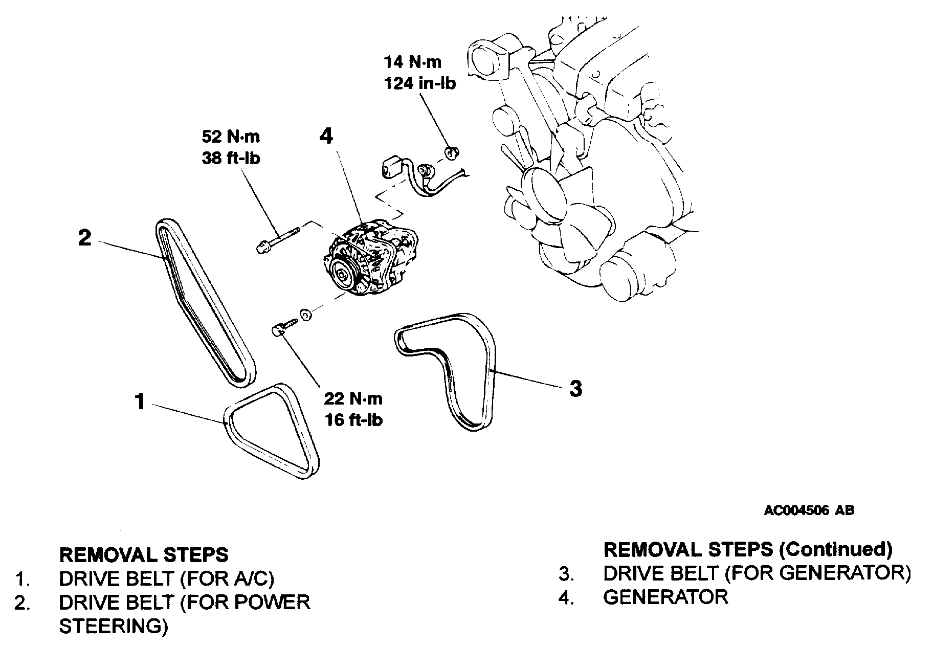

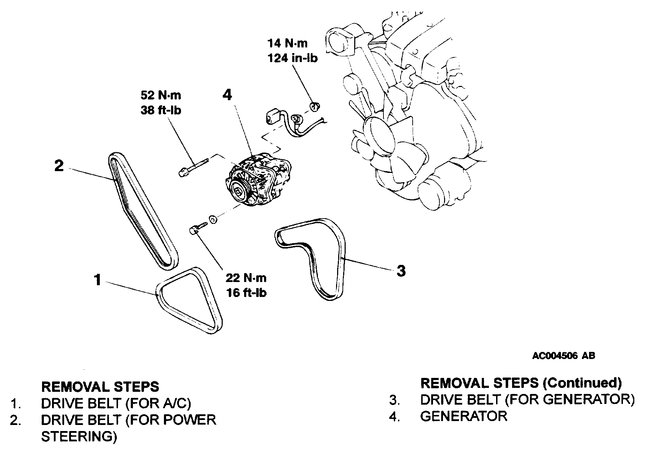

Here are the directions specific to your vehicle. The actual directions are in the attached picture.
2004 Mitsubishi Truck Montero Sport V6-3.5L SOHC
Removal and Installation
Vehicle Starting and Charging Charging System Alternator Service and Repair Procedures Removal and Installation
REMOVAL AND INSTALLATION
see pic 1

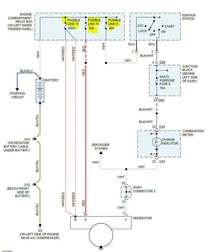

It could be the aftermarket alarm is likely causing an issue. However, I don't think it would cause the alternator to fail to charge the battery. Is it possible for you to check it with a voltmeter or multimeter now? It's really easy to do. The link is listed above.

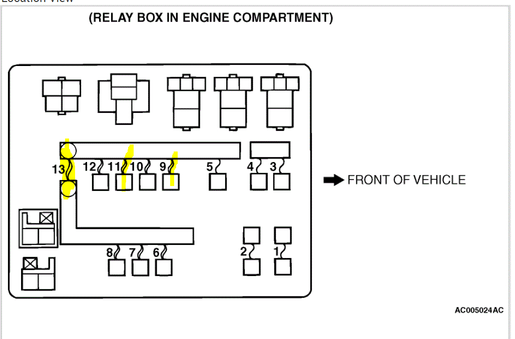

If you look at the attached pic, I need you to check a few fusible links. The pic is the entire wiring schematic for the charging system. If you follow the aforementioned link, that will tell me if power from the alternator is making it to the battery. If the battery is going dead when driving, either you have one heck of a draw or it isn't recharging. Pic 2 shows the orientation of the fusible link. Confirm there is power both in and out from the link.
I'm not sure how Advance checked it, but usually, they are reliable. However, I need you to confirm it. Let me know what the voltages are both with the engine off and with it running.
