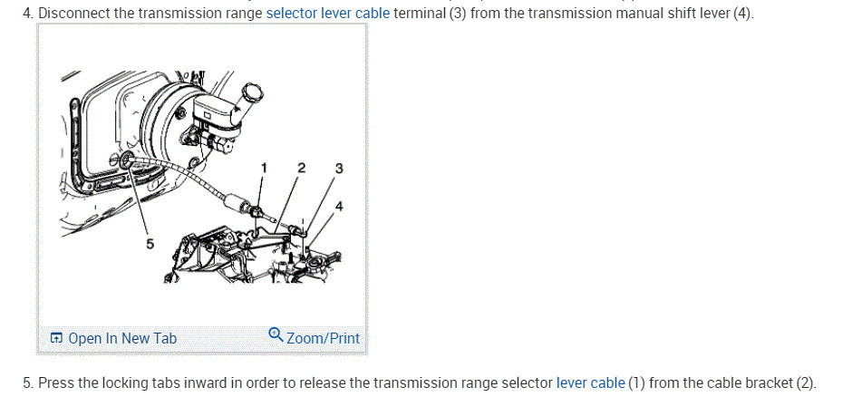

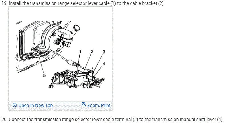

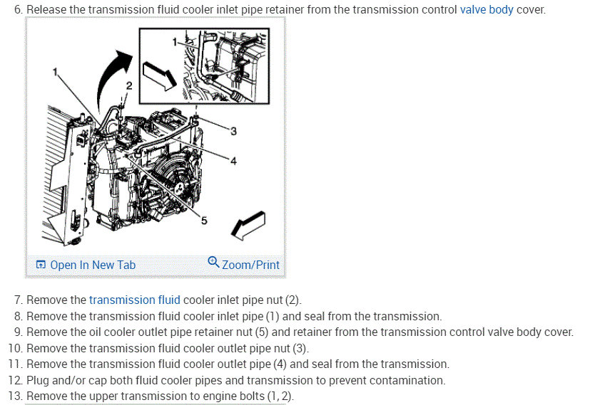

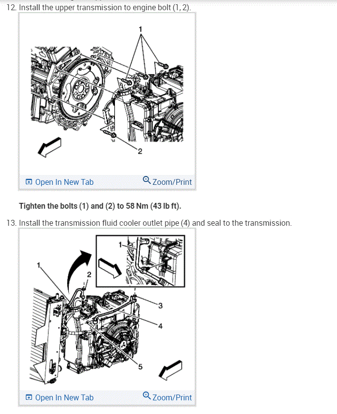

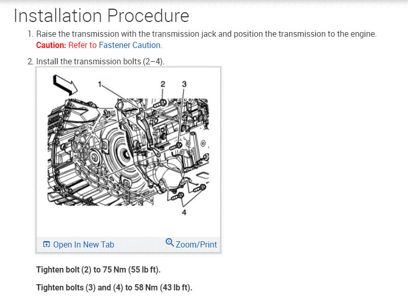

It's an awd. Also, i also need directions on how to drop the transmission and replace it.

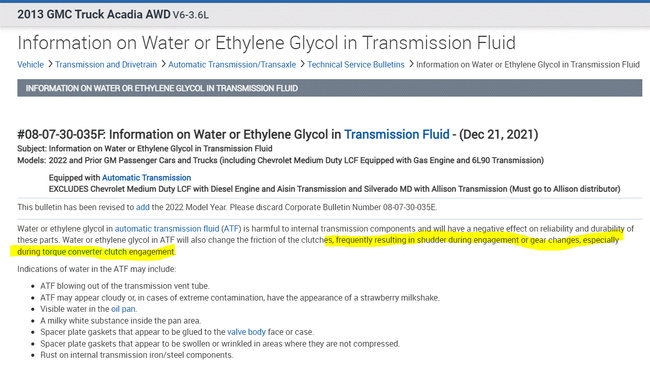

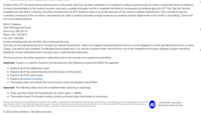

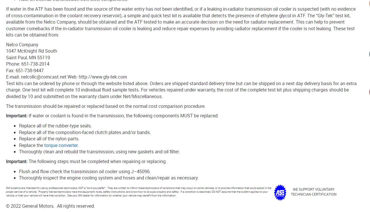

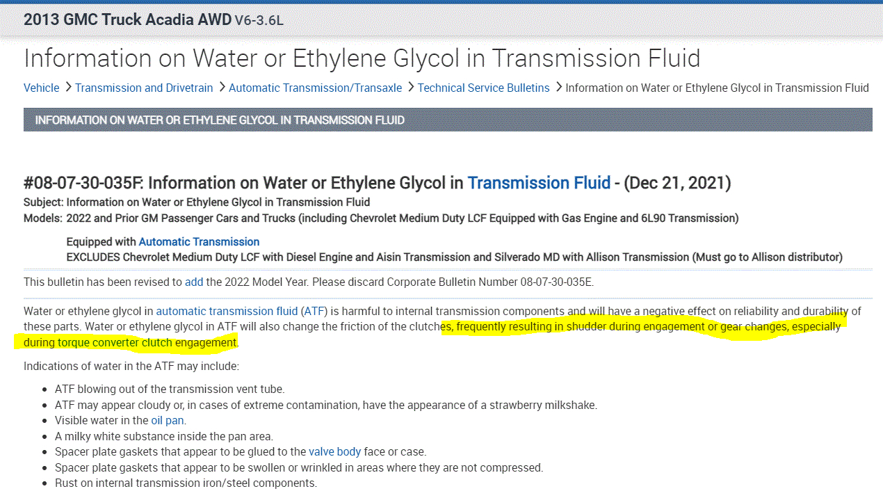

Do you only feel the shudder when in overdrive? Most commonly, it is related to the torque converter or low line pressure. However, there is a technical service bulletin I want you to review and let me know if it mirrors what you experience.
I attached the TSB below. Read through it and let me know. Also, I check my replies every day, so hang in there and I will get back to you.
Let me know

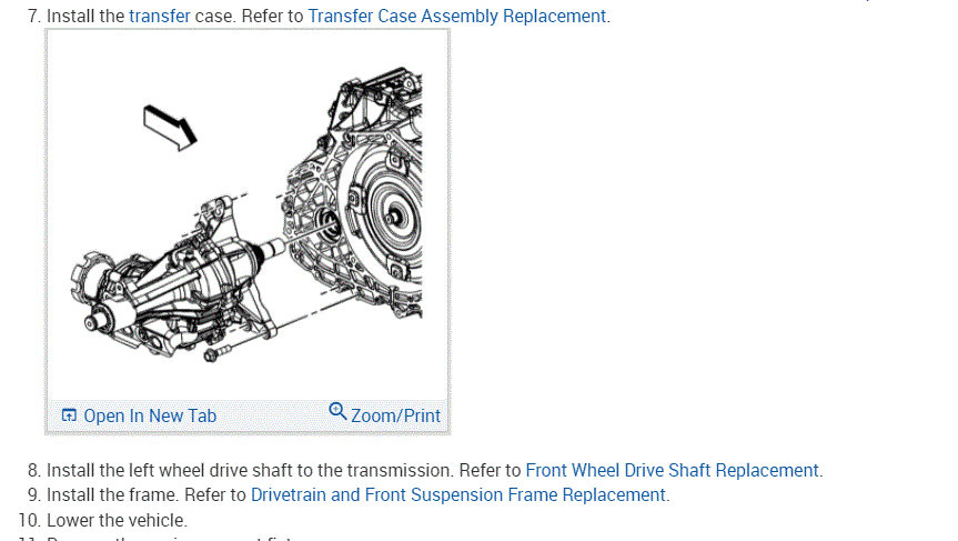

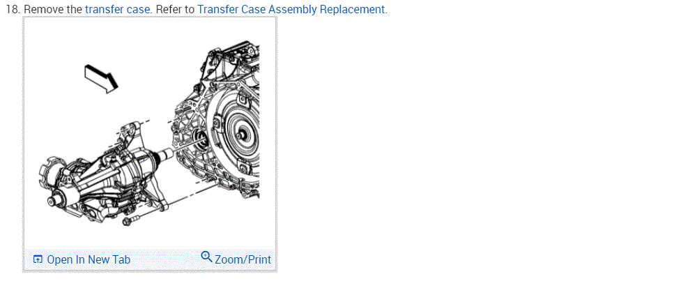

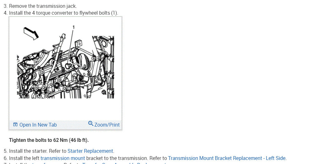

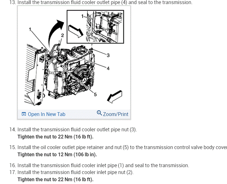

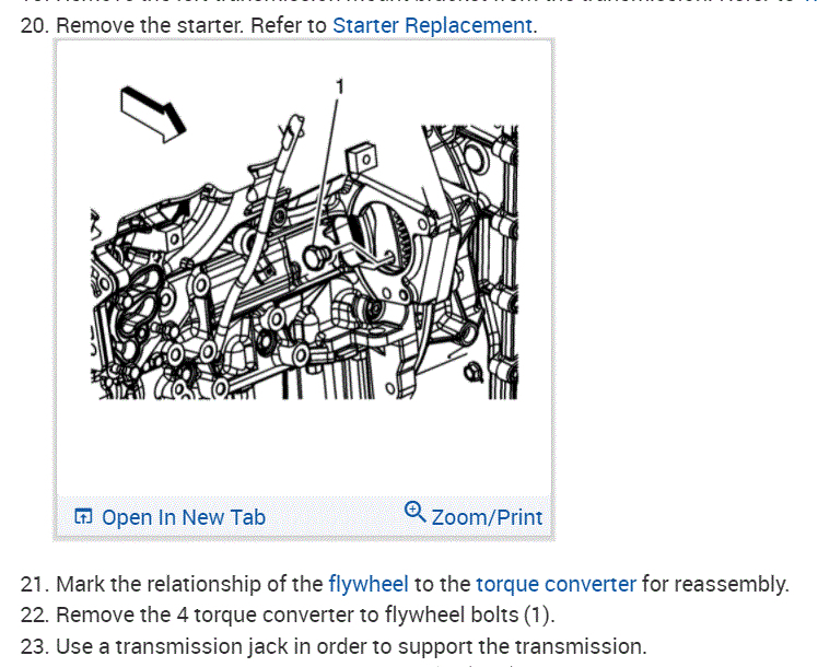

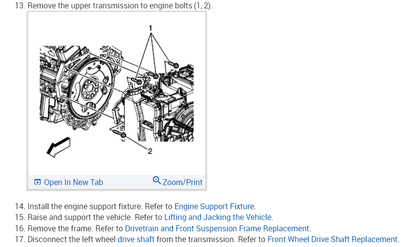

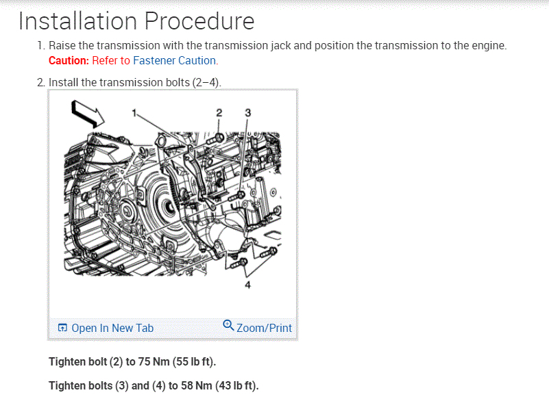

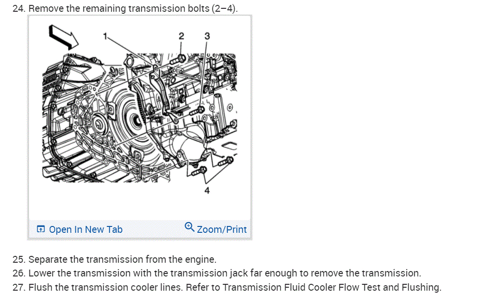

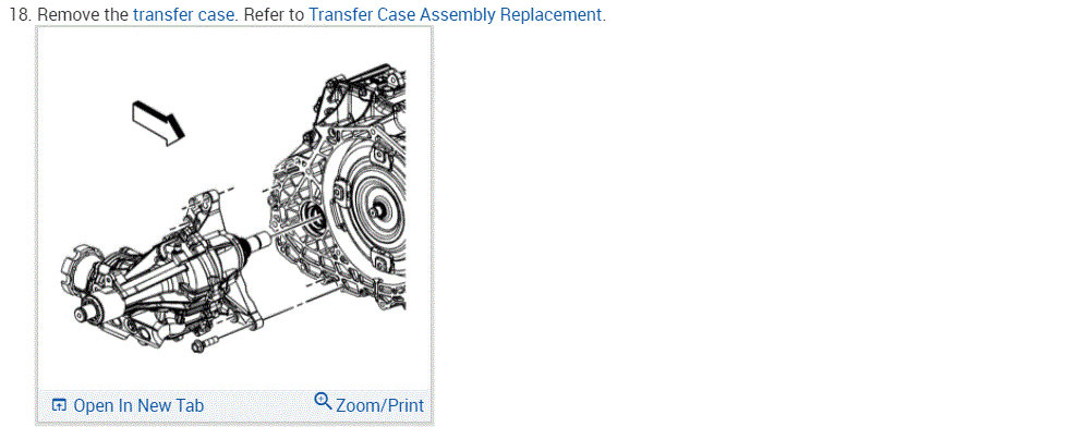

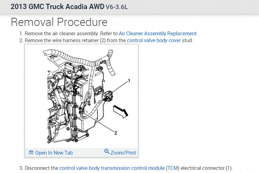

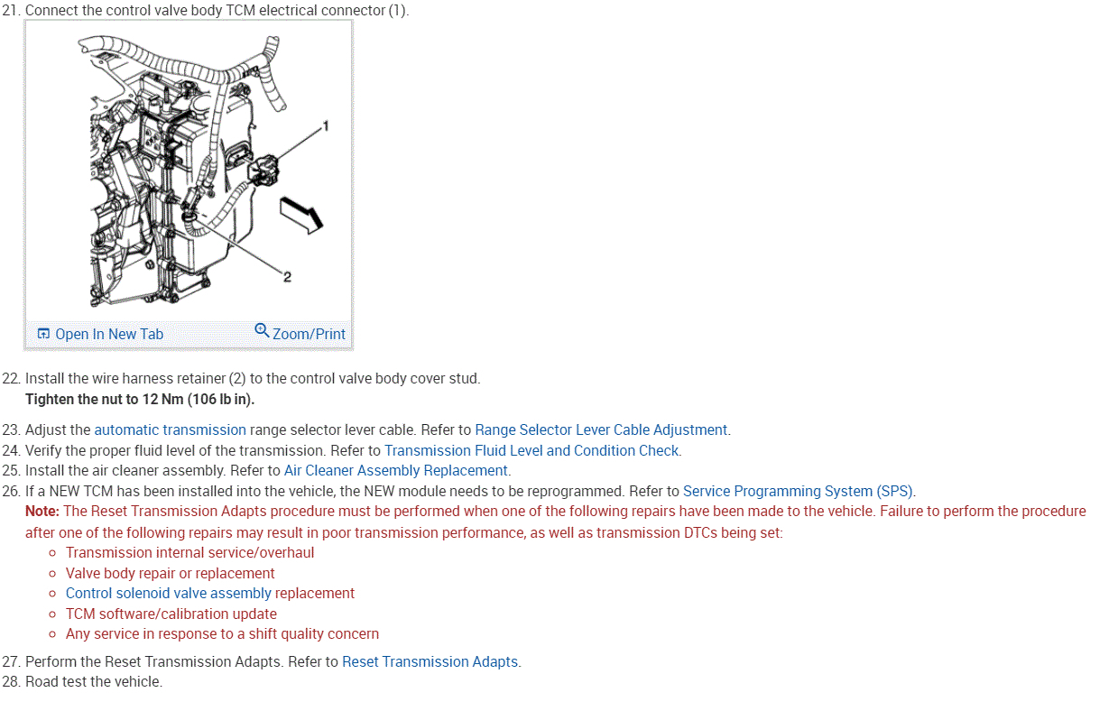

See pics below. Note: Pics 1 and 2 are the TSB. The remaining pics are the directions for the removal and replacement of the transmission.

Only in Overdrive, around 4045 and then sometimes on the freeway when the motor bugs down going uphill. Annoying. Gotten much better with shudder instafix. I read TSB. I doubt this is my case, but I will check the radiator to see if any contamination has occurred, even though it says sometimes it is not necessary. The fluid is dark, but I didn't see any traces of water or what could look like water. The fluid is dark. I replaced it twice and now it is much clearer. I will do more investigation. I just don't want to replace the converter and find out it was not it....and there is no pan to check filters or gaskets or rust traces.

What about removing things like the axle and mounts?
