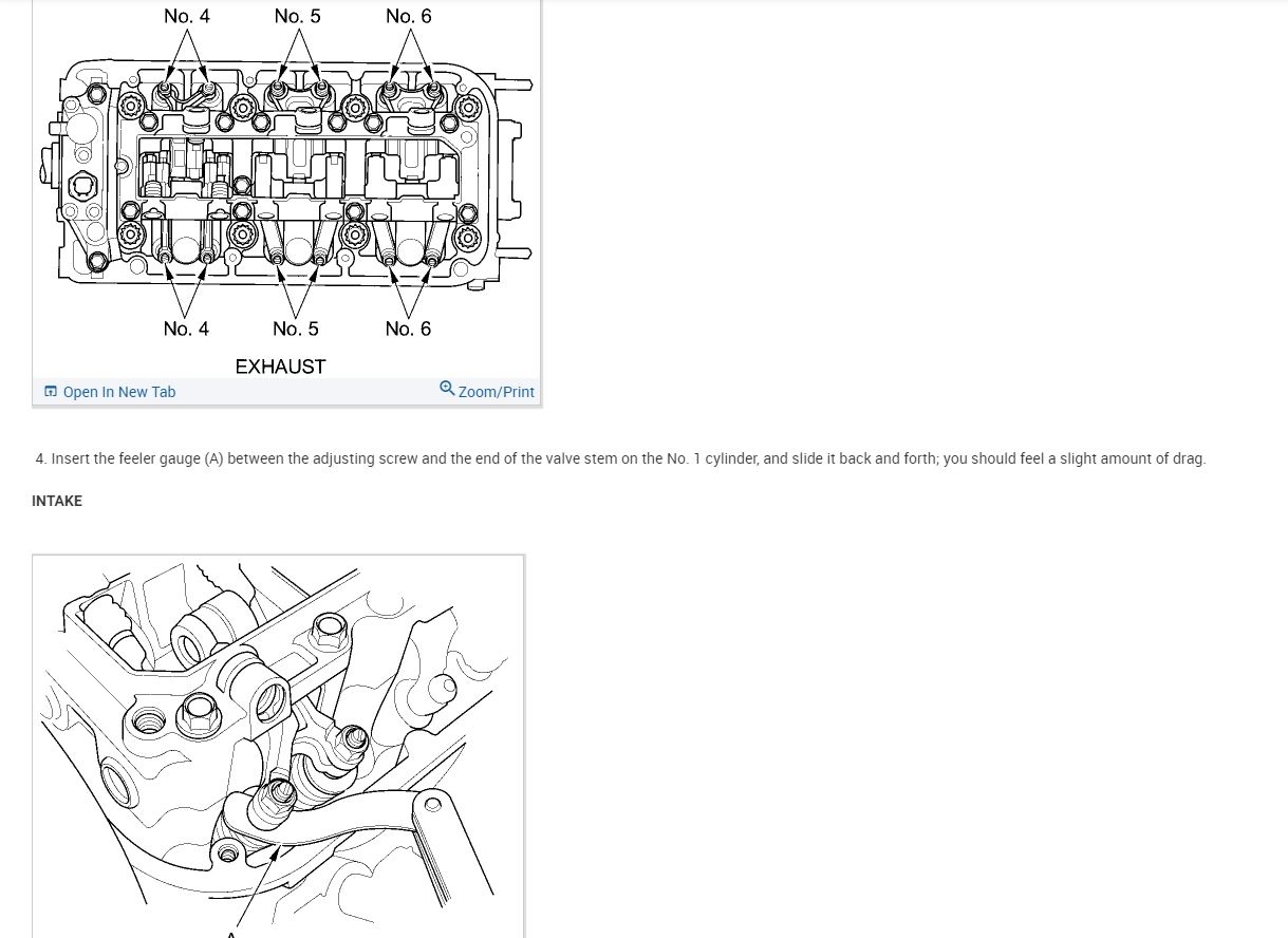

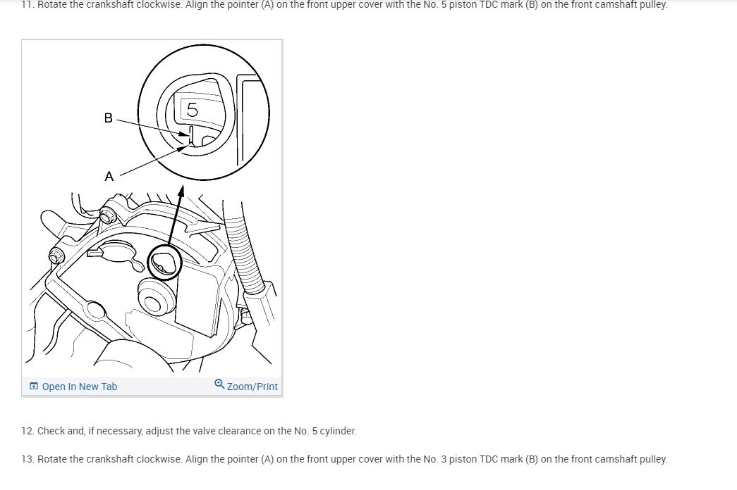

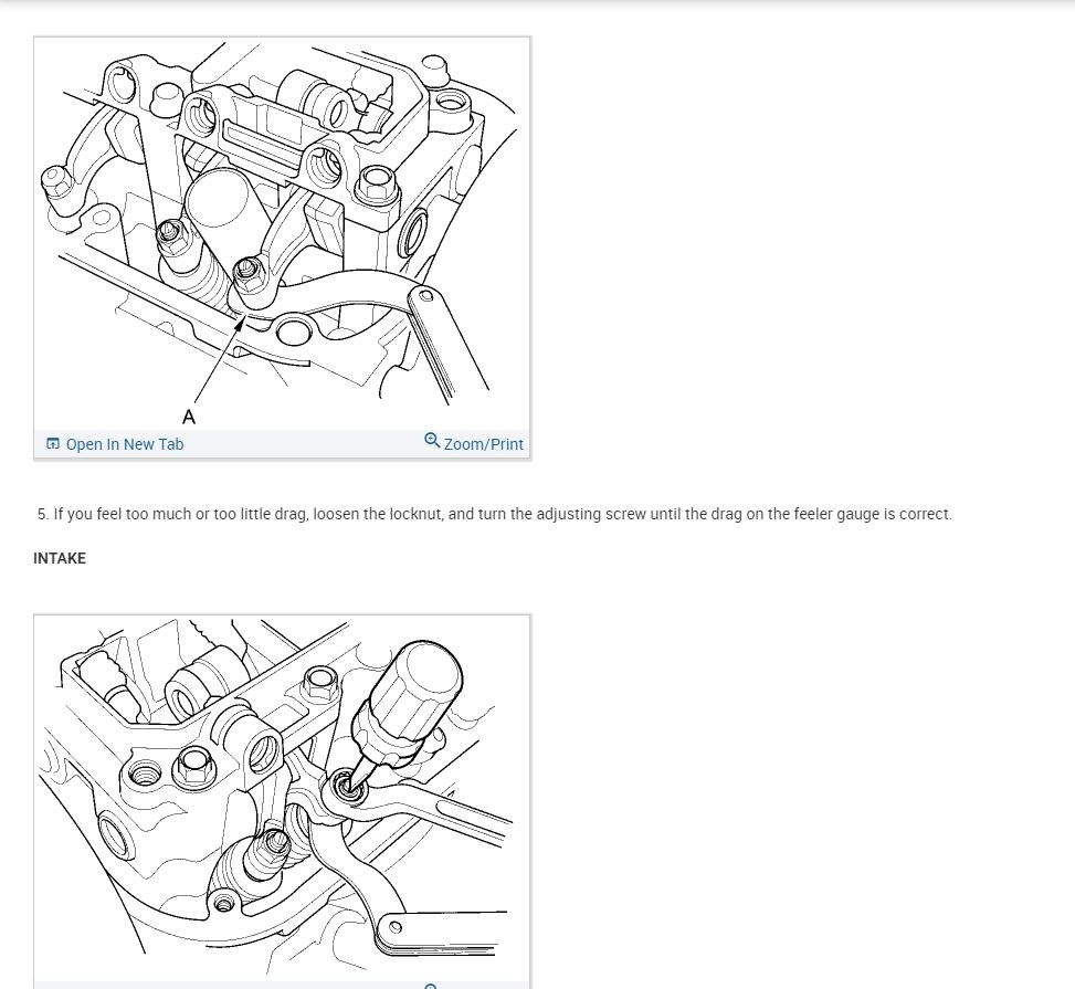

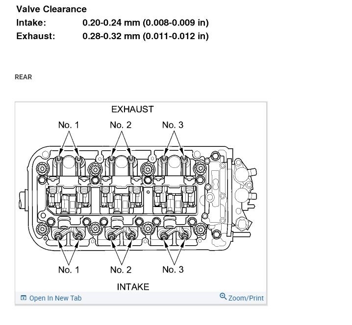

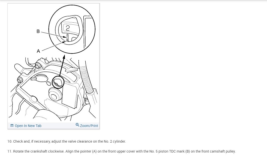

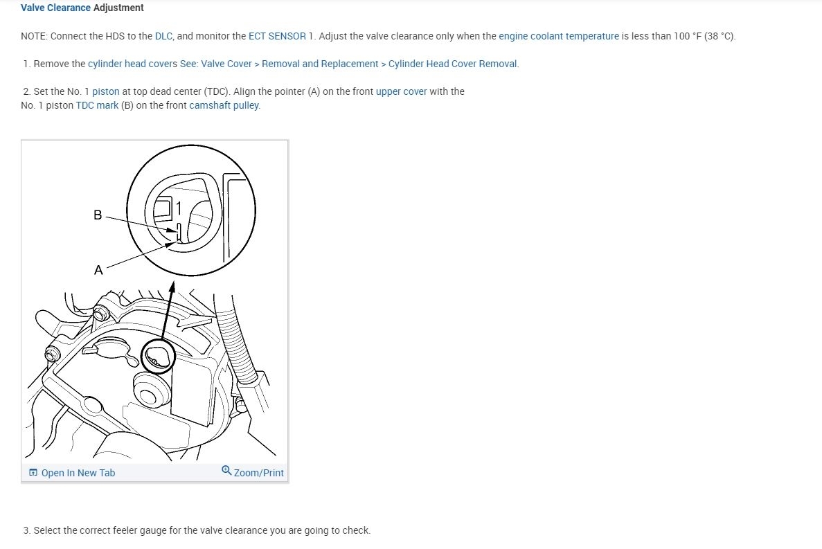

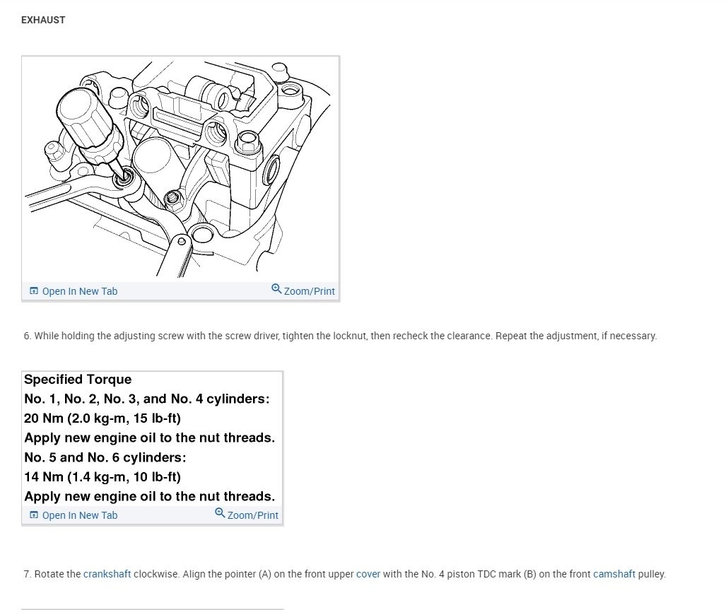

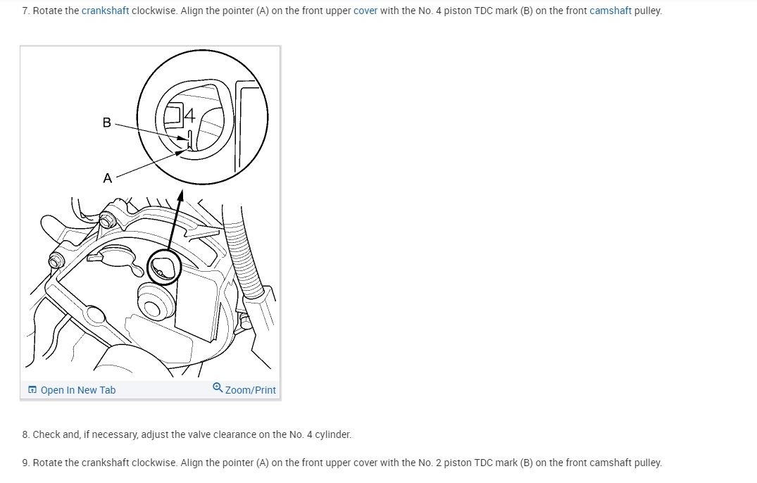

Good afternoon,
Adjusting the valves is a 100,000 service. The reason for it is to make sure the engine is running at 100% efficiency.
It is involved but if you want longevity, then keeping up on the maintenance is necessary.
I attached the procedure below for you.

Don't wait too long or not do it since it runs well. It is a basic maintenance item like changing the oil.
