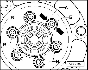

DUAL-MASS FLYWHEEL
Dual-Mass Flywheel
Special tools, testers and auxiliary items required
Counter-holder tool (3067)
Removing
Engine or transmission removed.
- Remove clutch pressure plate.
CAUTION!

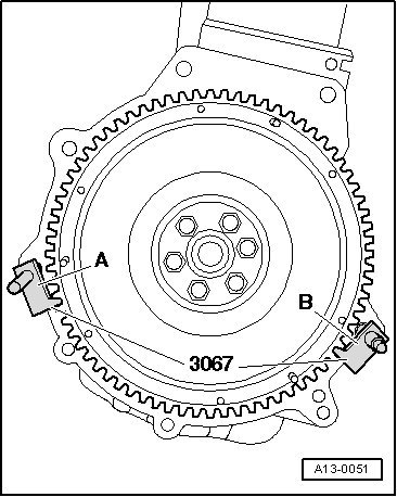

To prevent damage to dual-mass flywheel when removing, bolts - B - must not be removed using an air-powered or impact wrench. Only removing bolts by hand is permitted.
- Rotate dual-mass flywheel - A - so that bolts - B - stand centered to holes - arrows -.
picture 1
- When removing bolts - B -, make sure that bolt head does not contact dual-mass flywheel
- arrows - and thereby cause damage when turning it further.

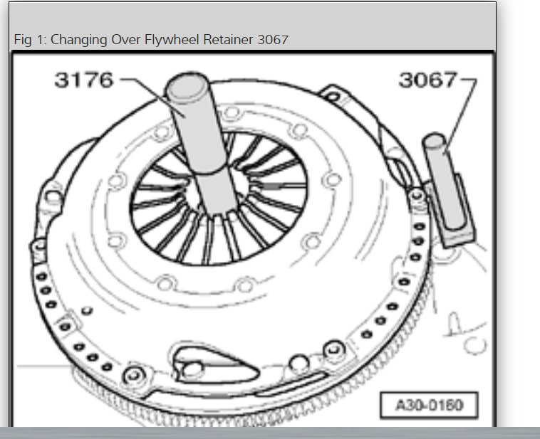

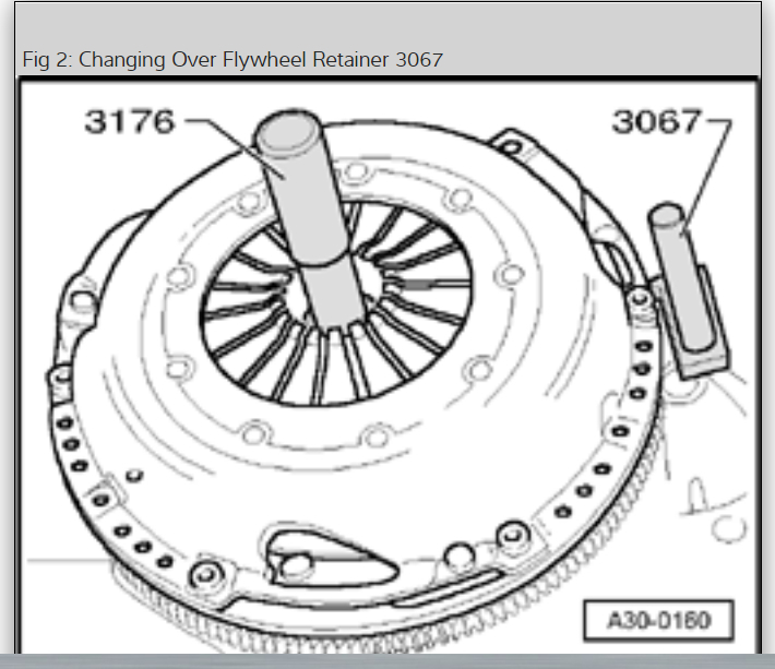

- Insert counter-holder (3067) into hole in cylinder block - B -.
picture 2
- Mark dual-mass flywheel to engine.
- Remove dual-mass flywheel.

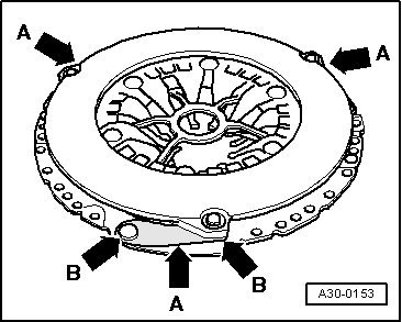

- Insert counter-holder (3067) into hole in cylinder block - A -.
picture 3

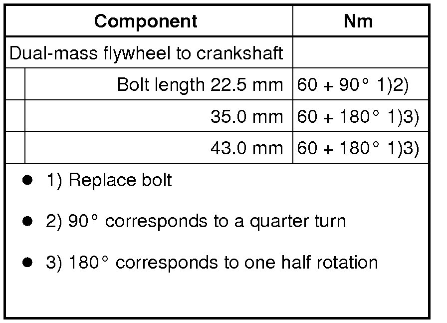

Torque specification
picture 4

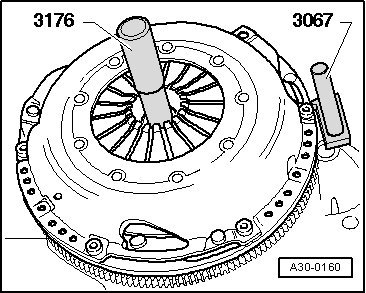

Here are the directions for clutch replacement:

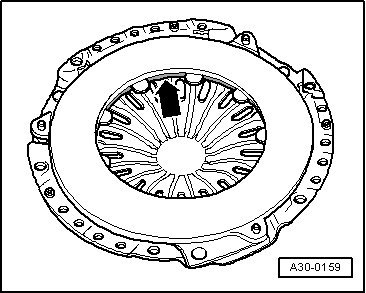

CONVENTIONAL CLUTCH
Conventional Clutch
Please refer to notes, refer to => [ Clutch General Repair Information ] See: Clutch, M/T > Procedures > Clutch General Repair Information.
The transmission has to be removed before working on the clutch. Refer to => [ Transmission, Removing ] See: Manual Transmission/Transaxle > Removal and Replacement > Transmission, Removing.
picture 5
1 Flywheel/dual mass flywheel
Make sure that dowel pins fit tightly.
Contact surface for clutch lining must be free of grooves, oil and grease.
Removing and installing, refer to => Engine Mechanical See: Engine > Mechanical > Cylinder Head, Valvetrain - Fastener Tightening Specifications
2 Bolt for flywheel
Always replace.
Bolt length: 22.5 mm; 60 Nm + an additional 90° 1/ 4 turn.
Bolt length: 43 mm; 60 Nm + an additional 180° 1/ 2 turn.
3 Clutch plate
Installation position: Clutch lining must make full contact with flywheel.
The marking "Getriebeseite" (if provided) faces pressure plate/transmission.
Coil springs (damper assembly) point toward pressure plate and transmission.
Centralize, refer to => [ Centralizing clutch plate and removing and installing pressure plate ]
Clutch plate diameter, refer to => [ Code Letters, Allocation, Transmission Ratios, Capacities ] See: Manual Transmission/Transaxle > Components > Code Letters, Allocation, Transmission Ratios, Capacities.
4 Pressure plate

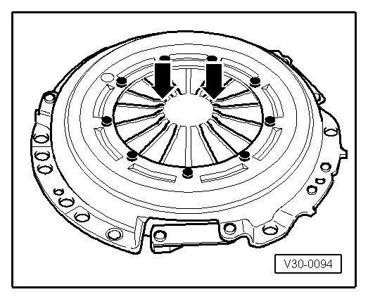

Removing and installing, refer to => [ Centralizing clutch plate and removing and installing pressure plate ]
Check ends of diaphragm spring, refer to => [ Checking ends of diaphragm spring ]
Check spring connection and rivets, refer to => [ Checking spring connection and rivet ]
Check wire ring, refer to => [ Checking wire ring ]
5 Bolt, 22 Nm
Loosen and tighten gradually in several stages and in diagonal sequence.
6 Needle bearing

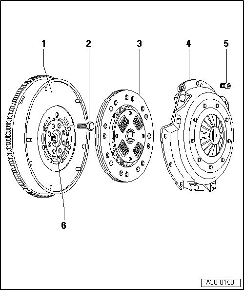

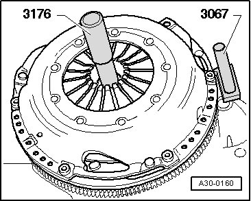

picture 6

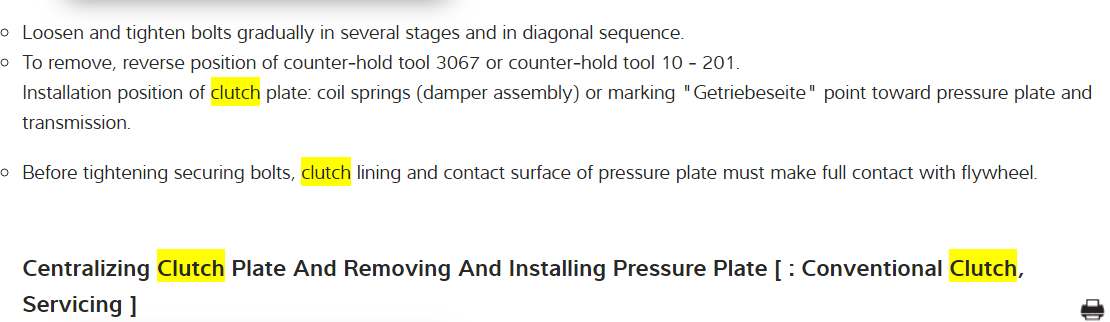

- Loosen and tighten bolts gradually in several stages and in a diagonal sequence.
- To remove, reverse position of counter hold tool (3067) or counter hold tool (10 - 201).
Installation position of clutch plate: coil springs (damper assembly) or marking "Getriebeseite" point toward pressure plate and transmission.
- Before tightening securing bolts, clutch lining and contact surface of pressure plate must make full contact with flywheel.
picture 7
Wear up to half the thickness of the diaphragm spring is permitted.
When performing repairs, always select the correct clutch pressure plate and clutch plate by checking engine code.

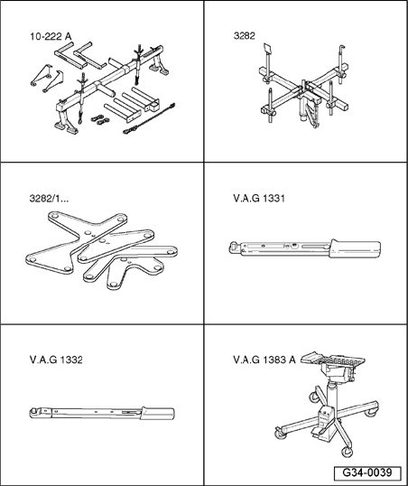

^ Engine support bridge 10-222 A
^ Transmission support 3282
^ Adjustment plate 3282/43
^ Torque wrench V.A.G 1331
^ Torque wrench V.A.G 1332
^ Engine/transmission jack V.A.G 1383 A

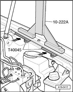

- Detach rubber seal from edges of wing mounting flanges.
- To avoid damaging edges of fenders with engine support bridge 10-222 A, insert wing compensation plates T40045 on both sides between fender mounting flange and body panel underneath.
picture 15
- Set up engine support bridge 10-222 A with adapters 10-222/3 on fender mounting flanges.
- Engage spindles on engine lifting eyes as illustrated.
- Take up weight of engine using spindles.
