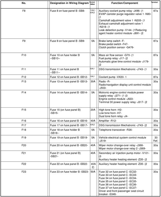

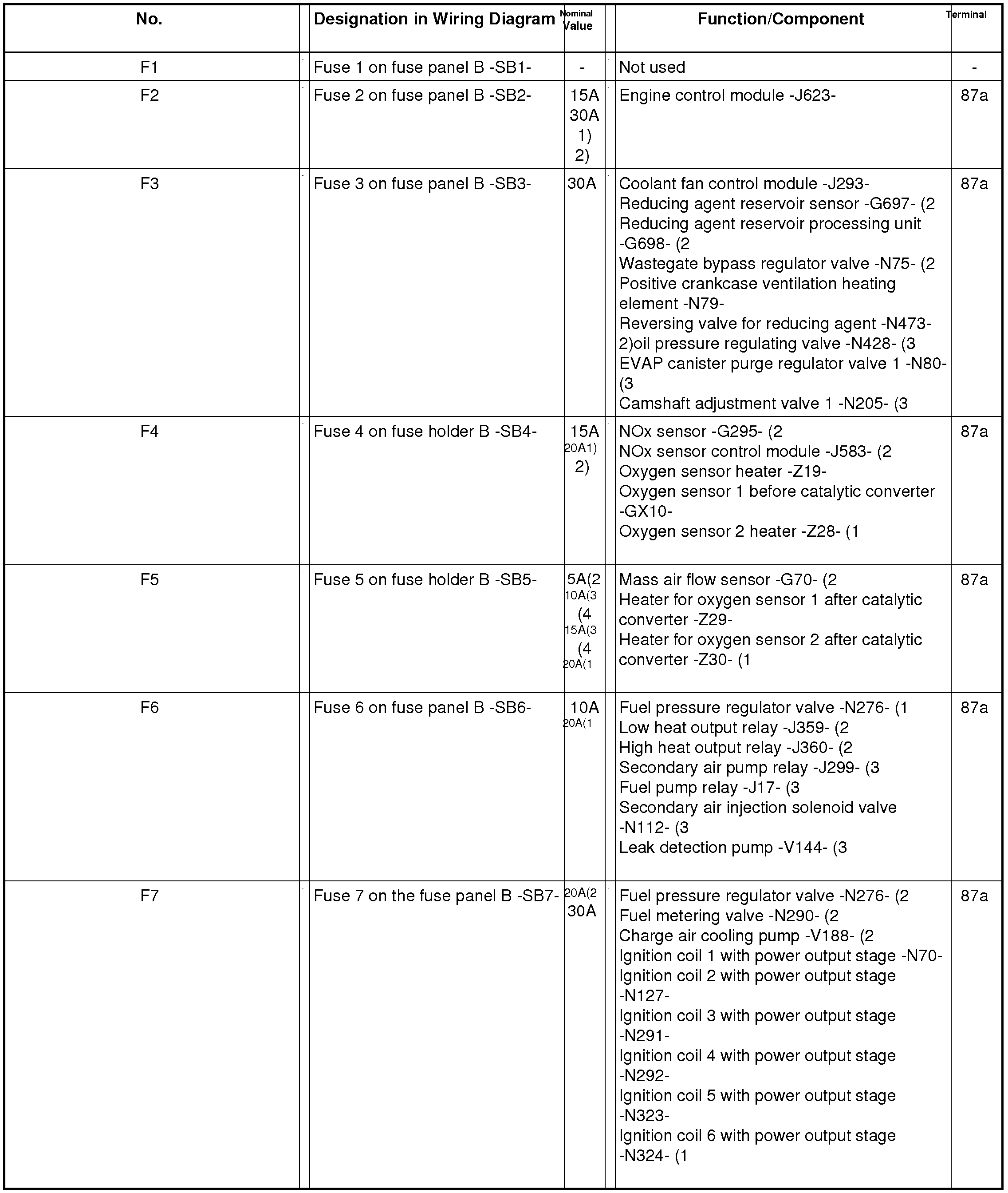

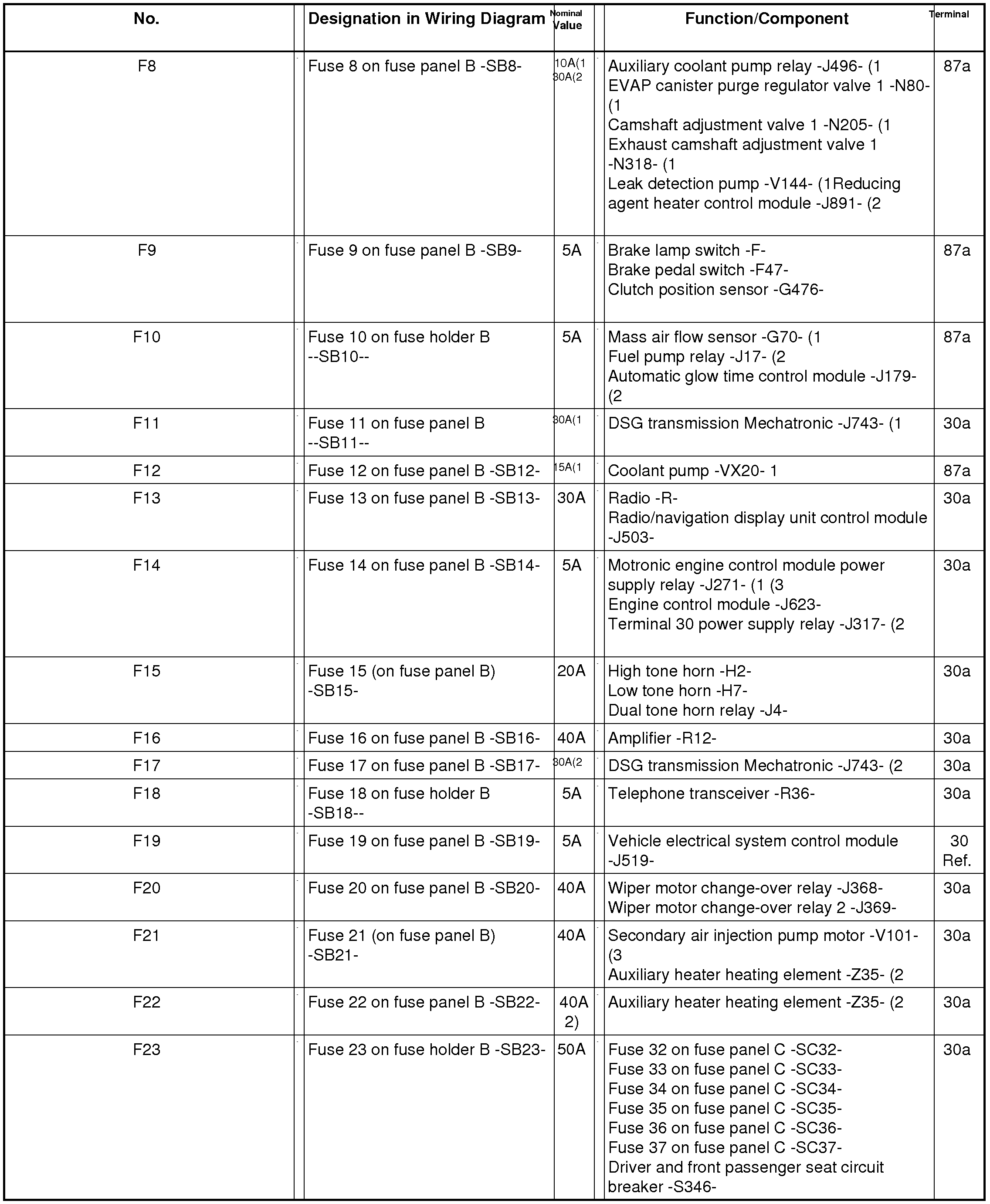

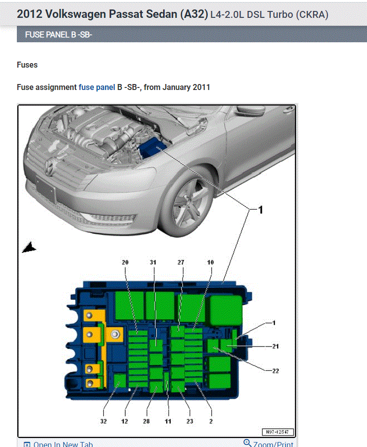

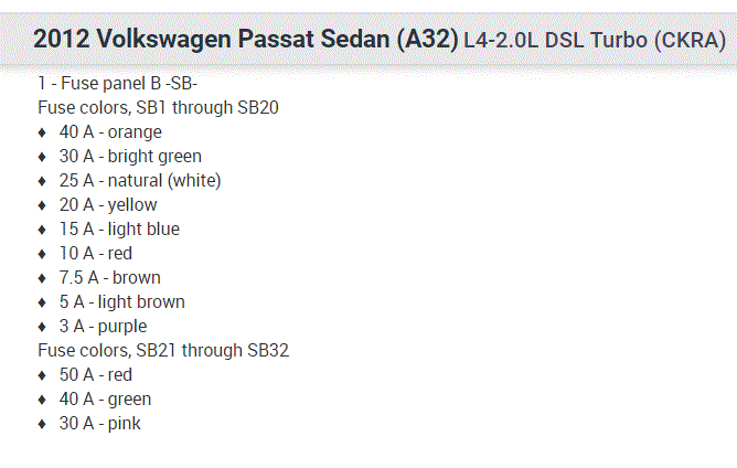

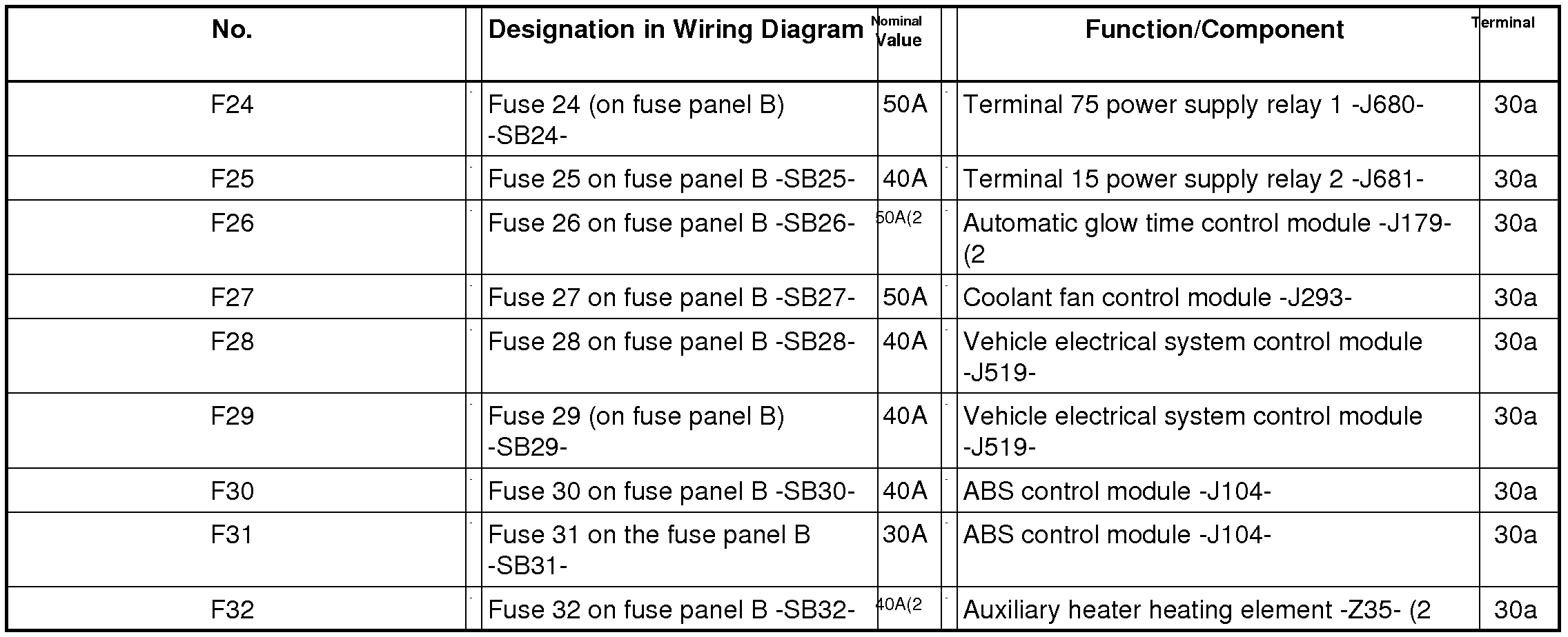

I attached information related to the fuse box under the hood. I don't know which fuse is blowing, and there are a couple that are 40 amp.
Take a look through this and let me know if it is what you needed. Also, if you can provide the production date, it may help. When I go through the manual, there are several production dates to choose from. The one listed below started in January of 2011 but was used in the 2012 model year.
If you look on the driver's door or the door frame, there should be a label that indicates when it was built.
Let me know if this helps or if you have other questions. Also, here is a link you may find helpful:
See pics below.
