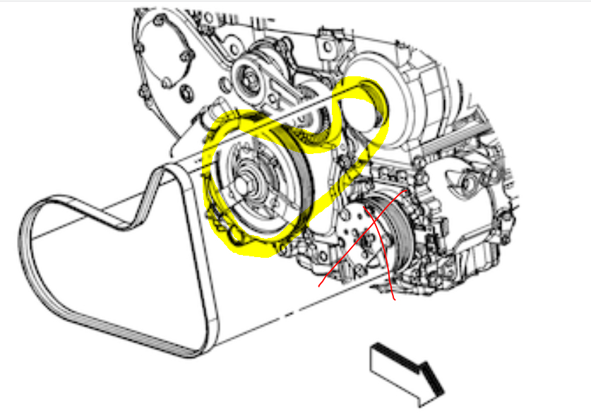

PS: I looked up belt routing for this vehicle. The alternator and compressor are the only two things shown, other than the belt tensioner and crankshaft pulley.
I copied what I found and highlighted where I think it would work for you. It's not going to be a very long belt. LOL
See pic below.
