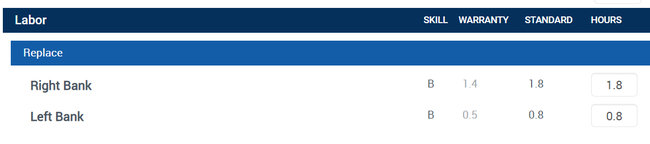

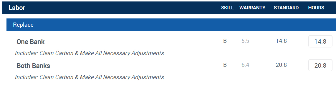

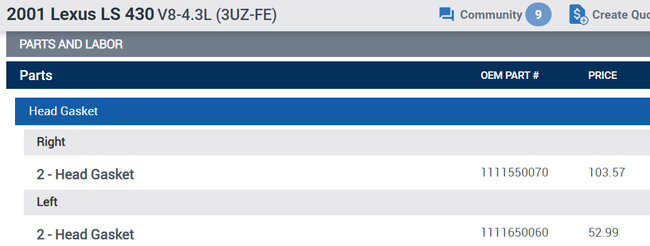

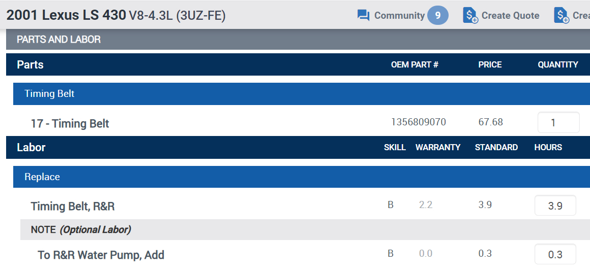

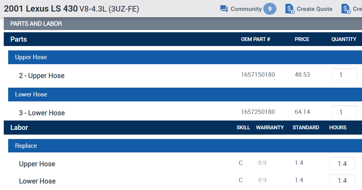

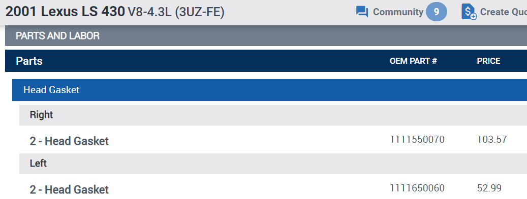

Can you give me an idea how many hours is involved to do the following:

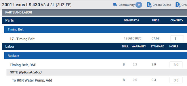

Change timing belt, water pump, tensioners.
Replace head gaskets with bolts, cam seals, front main seal

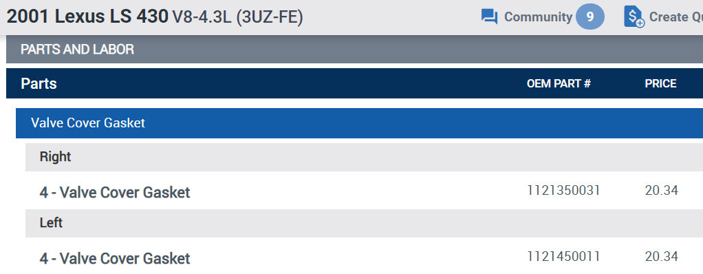

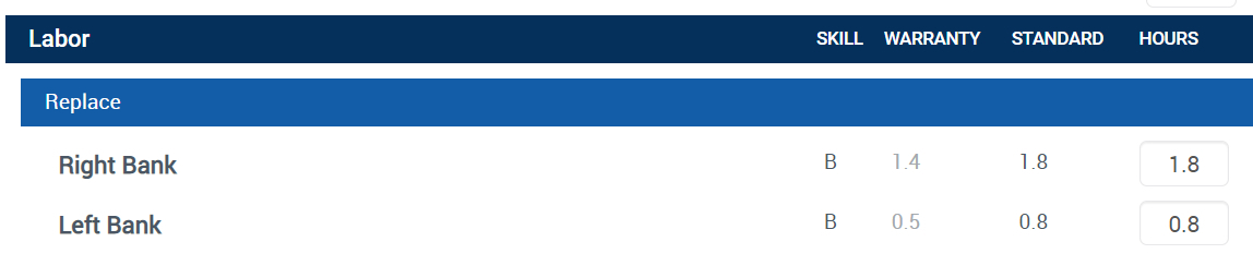

Replace valve cover gaskets, tube seals, spark plugs.

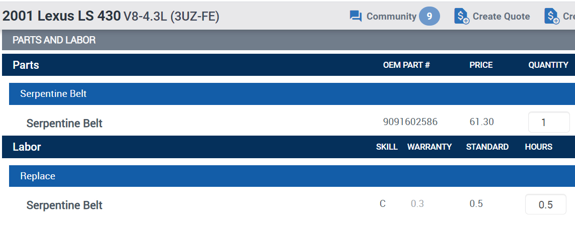

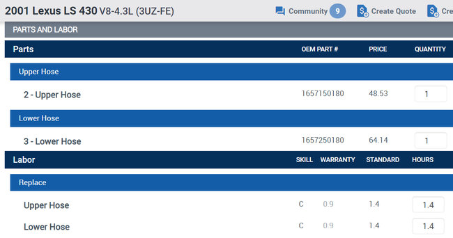

Replace radiator hoses, serpentine belt.
I believe most of this work other than the timing belt stuff is pretty much along the removal path for the timing belt and water pump.

Hello, I'm Danny.
I've attached pictures below for the information you requested. Check out the diagrams (Below). Please let us know if you need anything else to get the problem fixed. Hope this helps and thanks for using 2CarPros.
