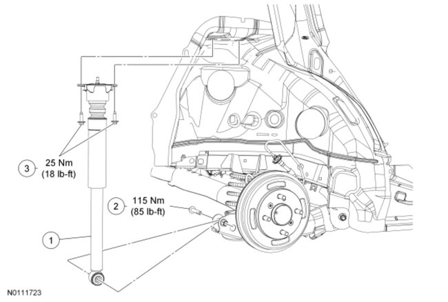

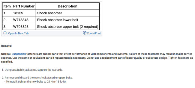

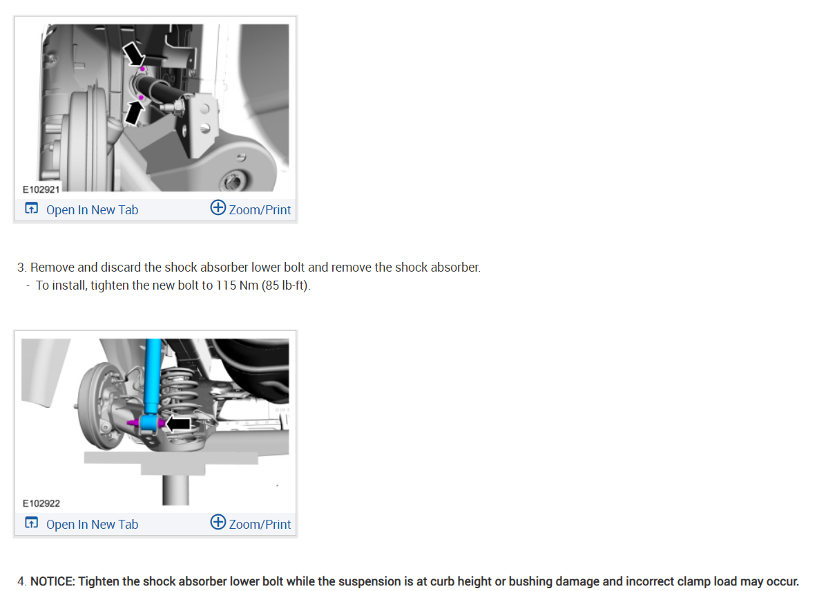

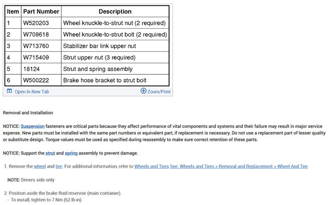

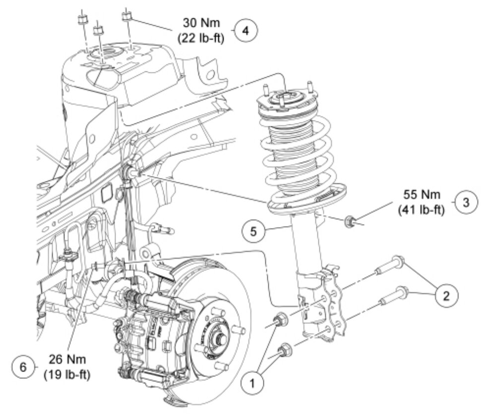

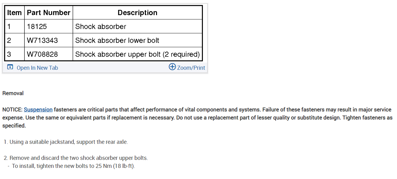

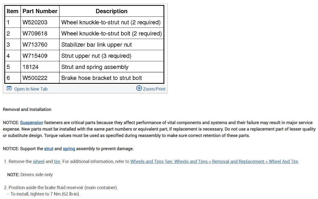

Can you give us more information, maybe an image of the problem so we can help? Here are images and instructions on the front struts and rear shocks so we can be on the same page. Check out the images (below). Let us know what you find.
