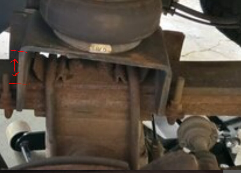

Could you tell by looking at the pictures if a standard shock works for my truck or if it is a 1" lift or 2" lift.
Thanks, Phil
Jul 8, 2023 at 6:48 PM
It can't tell by just looking. However, if you measure between the two lines I made on your picture, that should provide you with how much lift there is.
Take a look below and let me know if that helps.
See pic below.

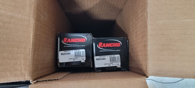

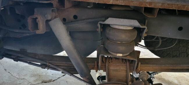

Did research from air ride and installed standard shocks and everything is great. Thanks 2CarPros.
