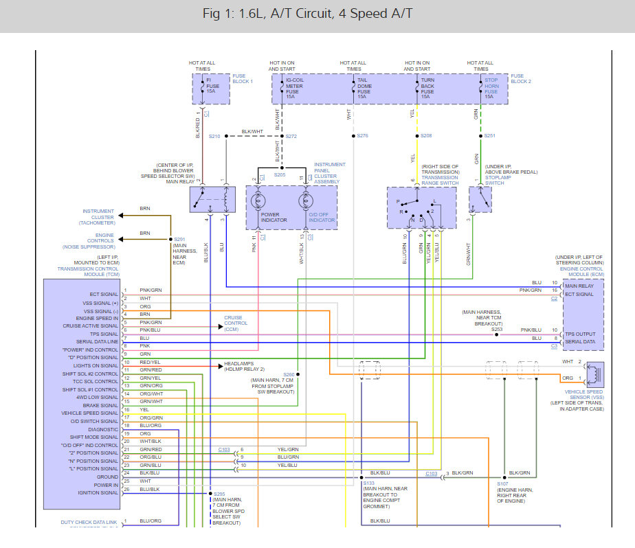

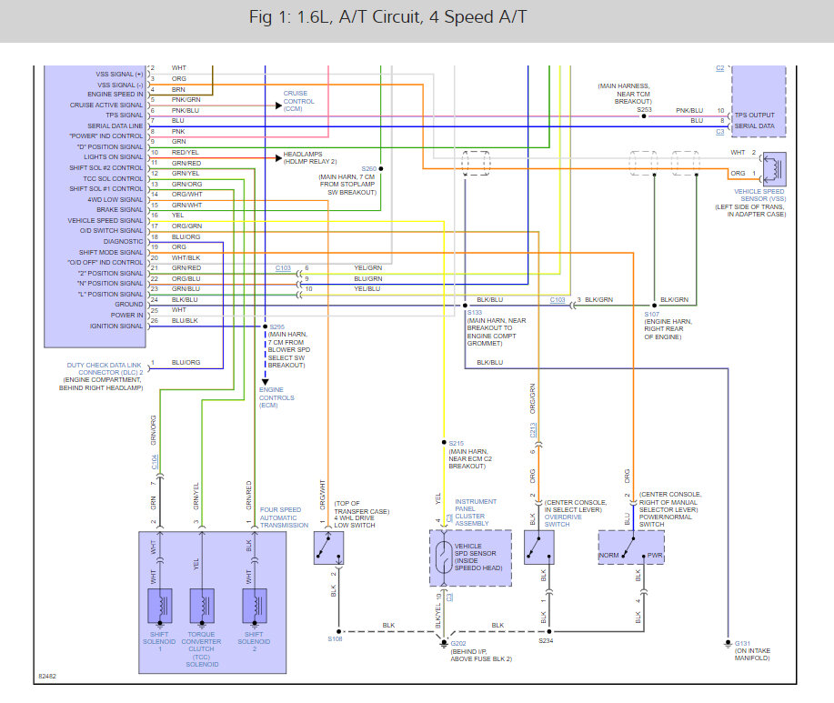

Okay, it sounds like we need to check all fuses with the key on. Here are the wiring diagrams for the transmission which show you have a VSS sensor inside the instrument cluster. Does the speedometer work?

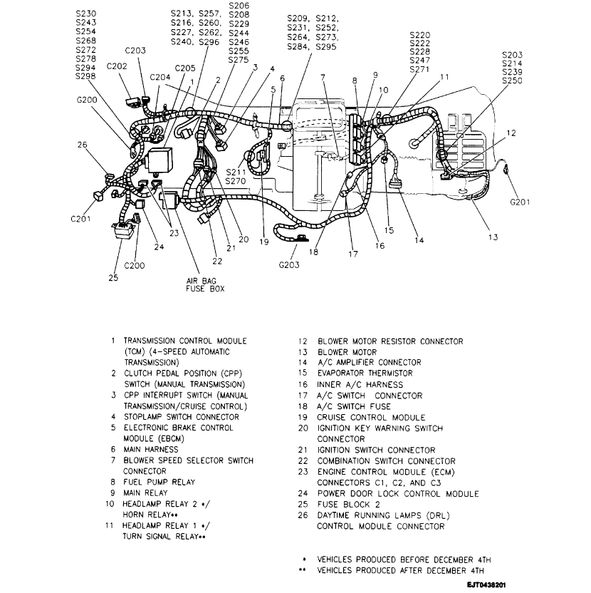

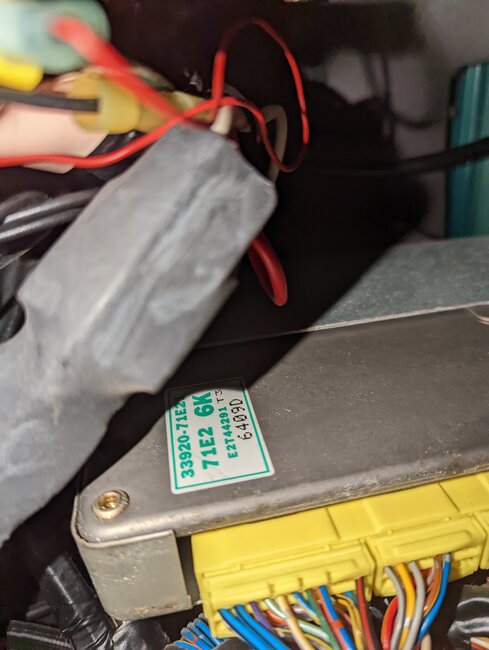

Let's try removing the transmission control module to check the electrical connector for corrosion, this will through off the values of the sensors and make it shift strangely. Check the image from below to see the location of the module.
Oct 25, 2022 at 1:50 PM
ROBERT UHLER
  • 11 POSTS

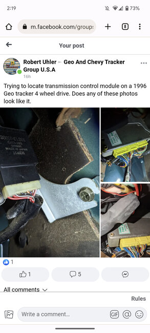

Could this be the module? The one wrapped in gray material.

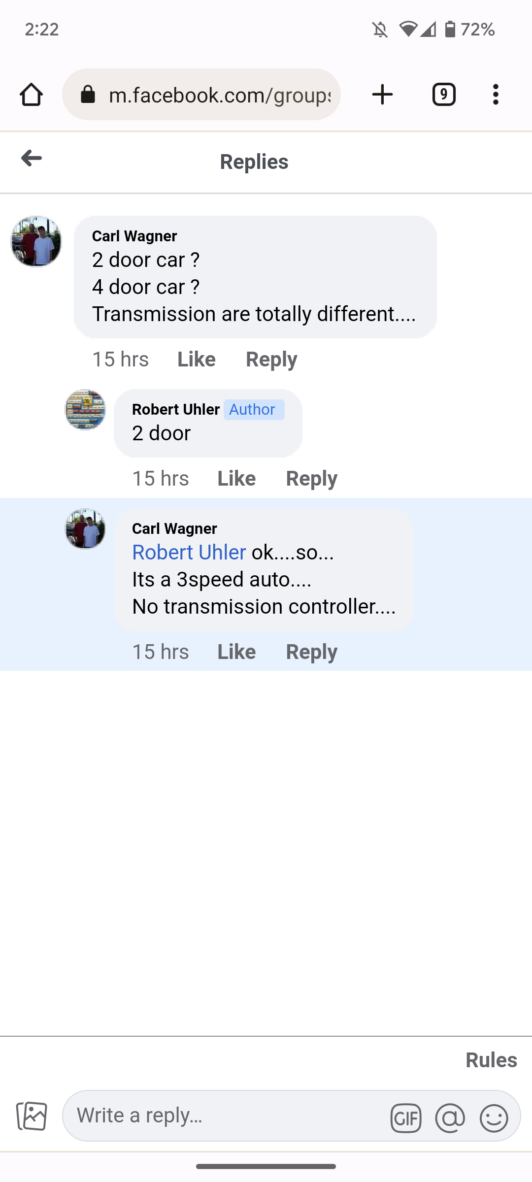

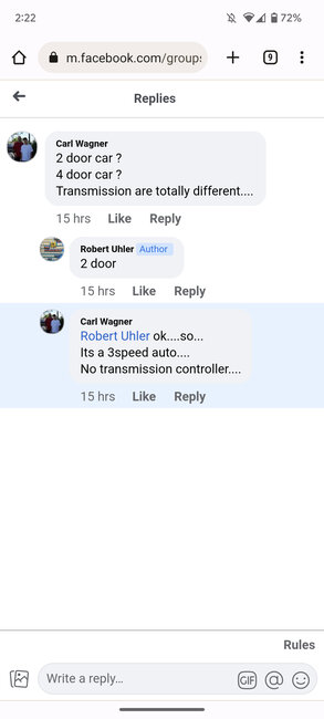

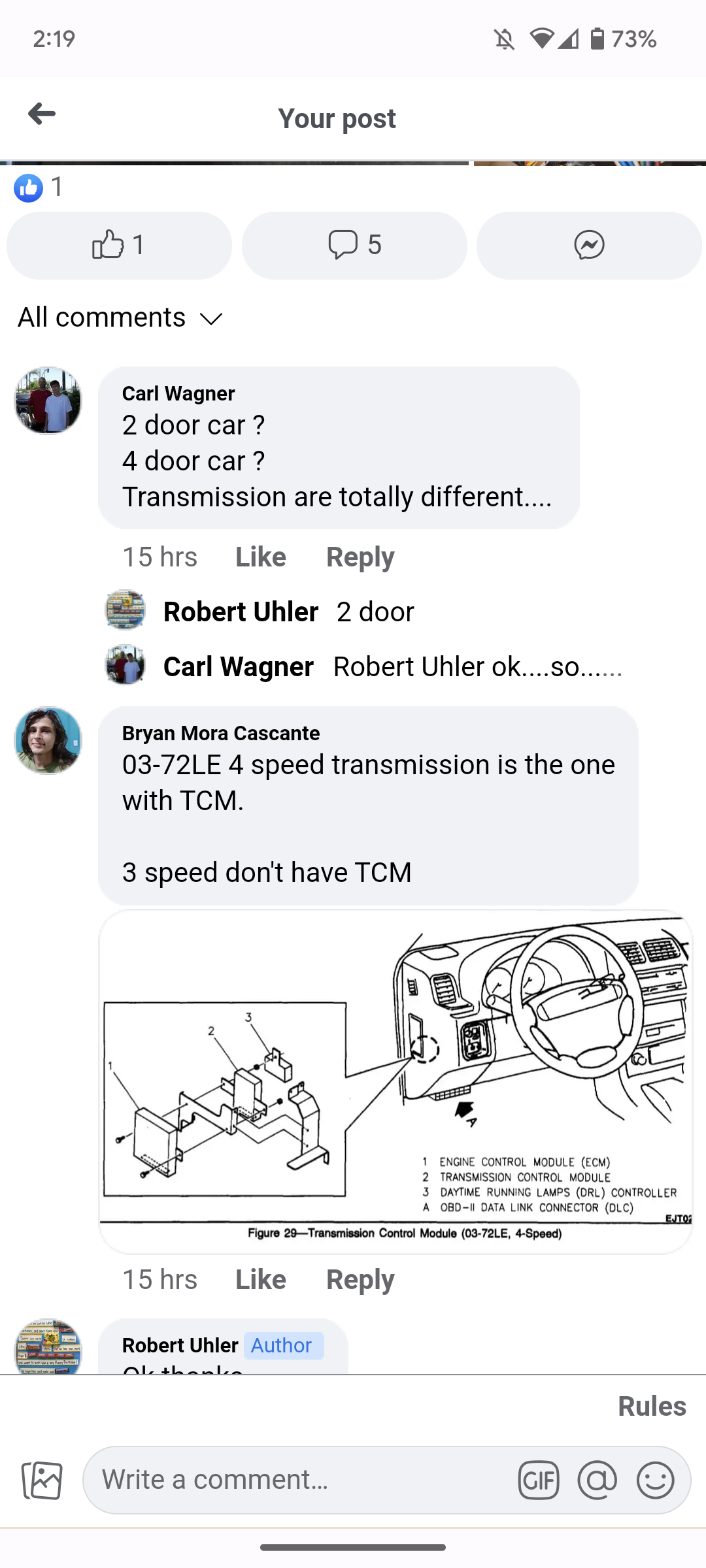

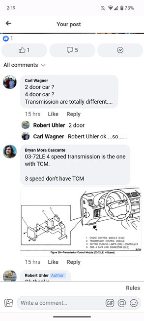

I have a 3-speed transmission. People on the Facebook page says 3 speed does not have a controller.
Oct 26, 2022 at 8:15 PM
Can you forward the facebook page please?
Oct 27, 2022 at 10:59 AM
ROBERT UHLER
  • 11 POSTS
Here are some screenshots of the post.
Oct 27, 2022 at 11:21 AM
ROBERT UHLER
  • 11 POSTS
Thank you, the guy said there is a three speed, but I do not show one for 1996 but in 1995 they do not show one so it could be a late 1995. How does the power of the engine seem, could you have a clogged cat causing the vacuum to be low therefore holding the gears longer because the computer thinks it is under load?
