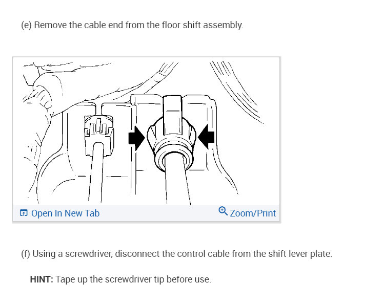

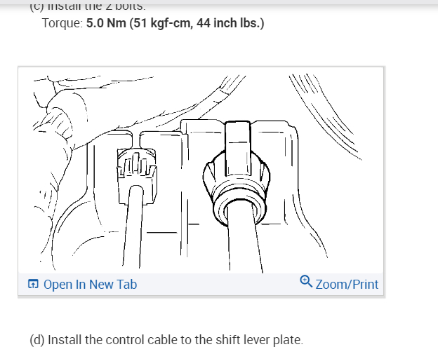

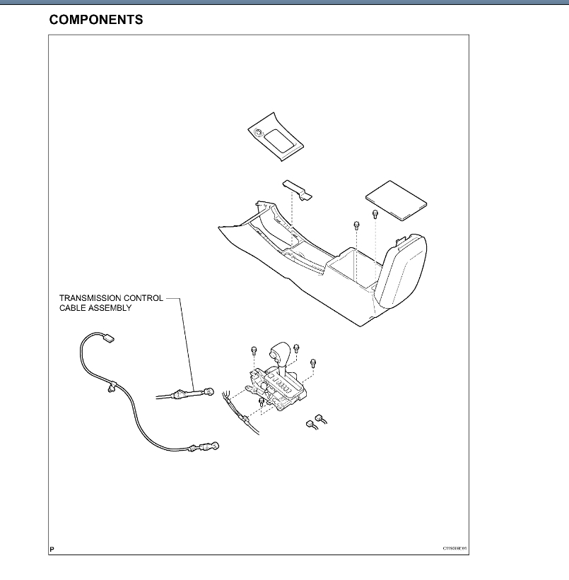

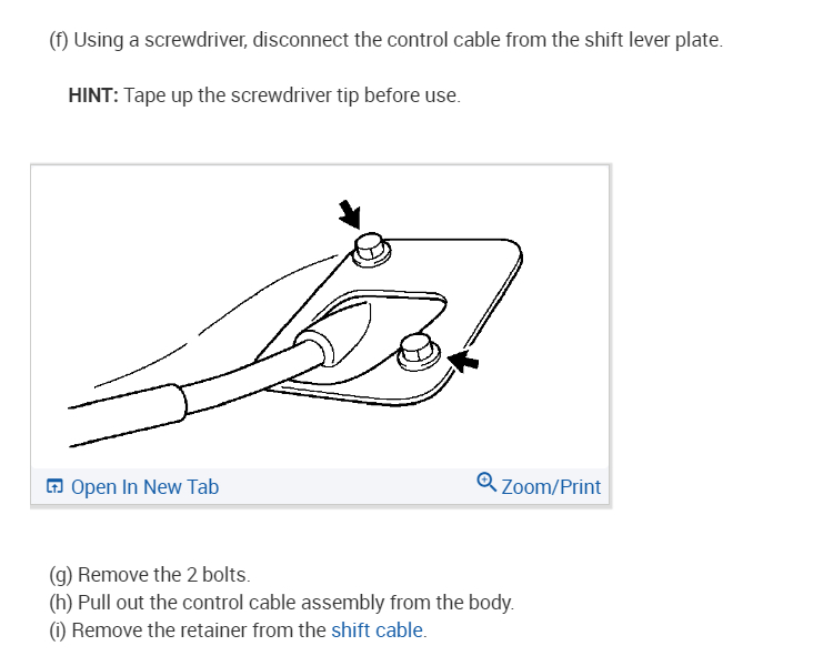

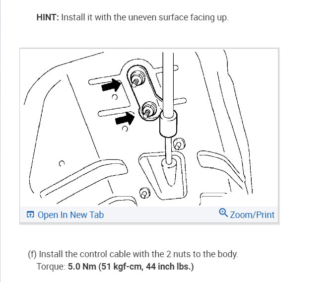

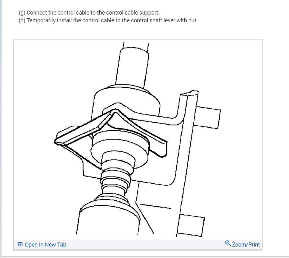

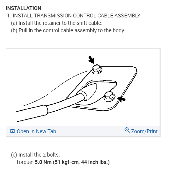

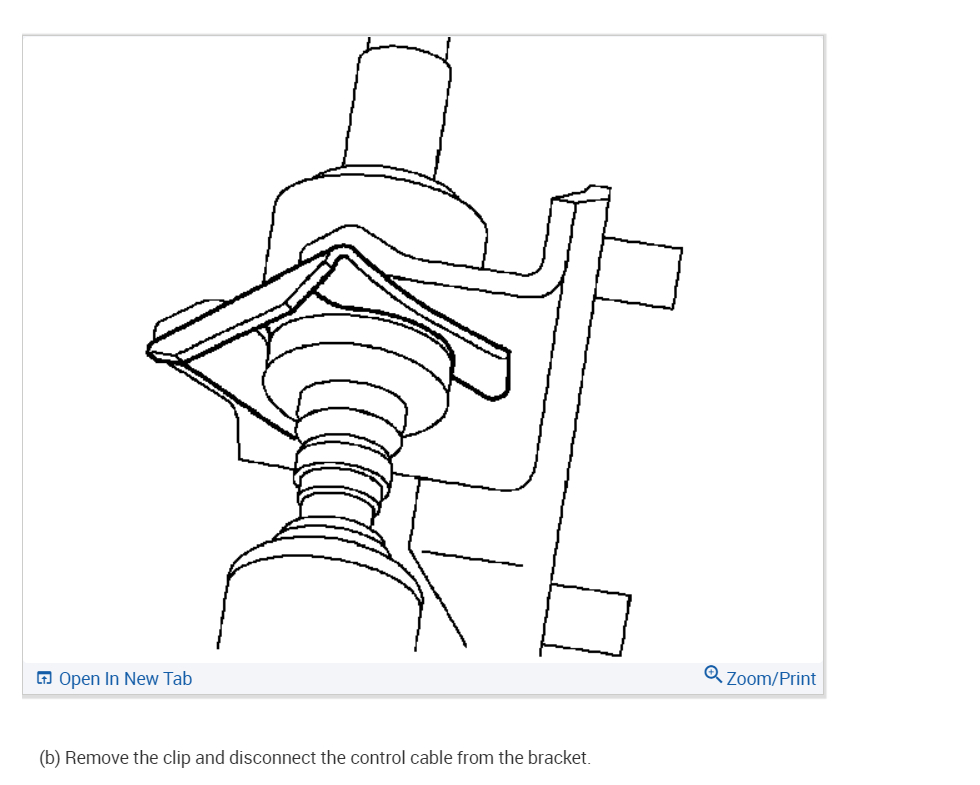

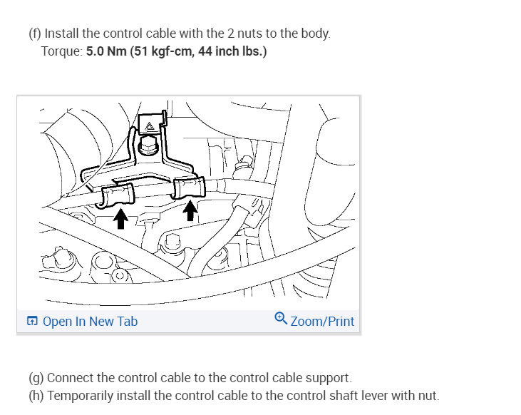

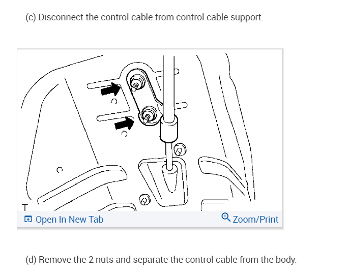

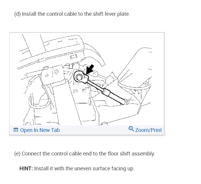

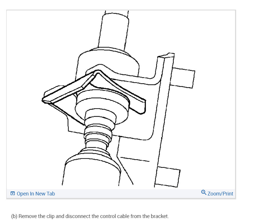

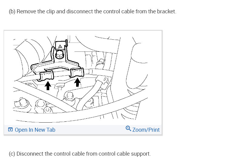

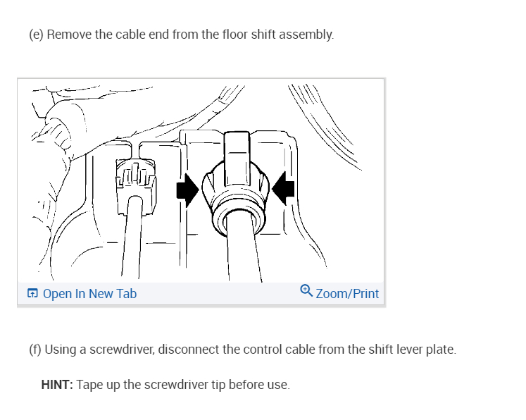

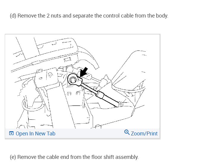

So, the fact that the car wants to go forward when the shifter is in neutral is telling me the shift cable could be going out, to be sure you can disconnect the shifter cable from the transmission and shift it by hand and let the internal detent control the shift lever position. Here is how to change out the shift cable in case you need it. Check out the images (below). Please let us know what happens.
