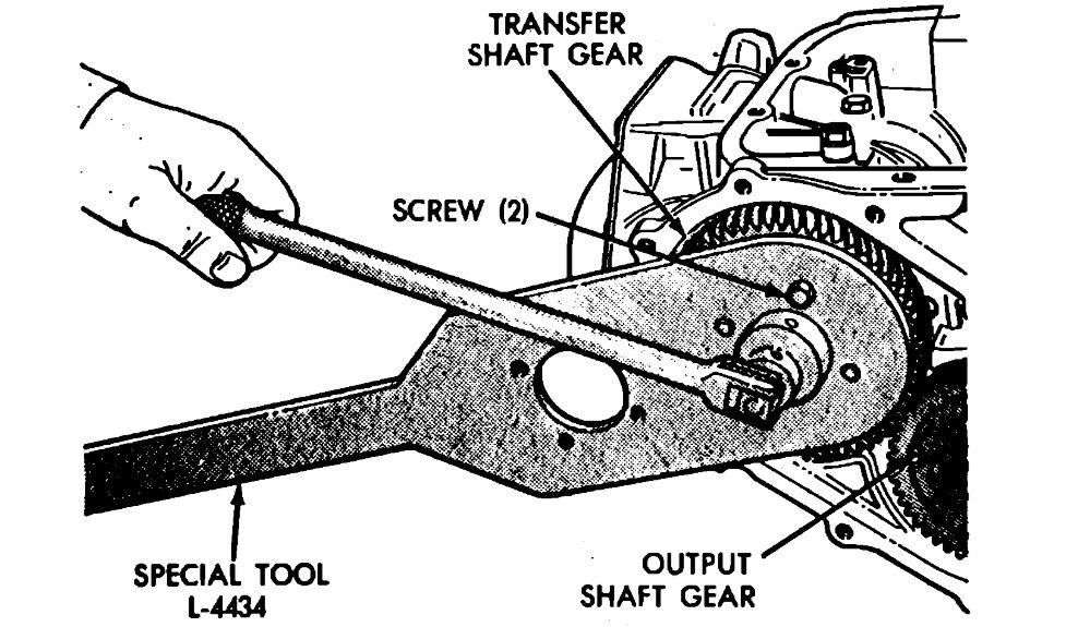

2. Using transfer shaft gear tool No. L-4434 or equivalent, remove transfer shaft gear retaining nut, Fig. 3.

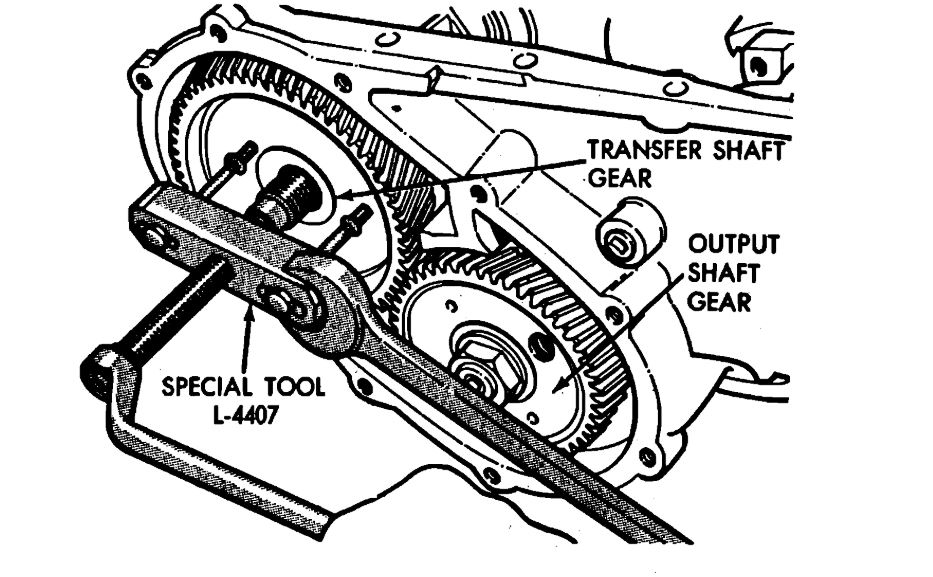

3. Using transfer shaft gear puller tool No. L-4407 or equivalent, remove transfer shaft gear and shim, Fig. 4.
