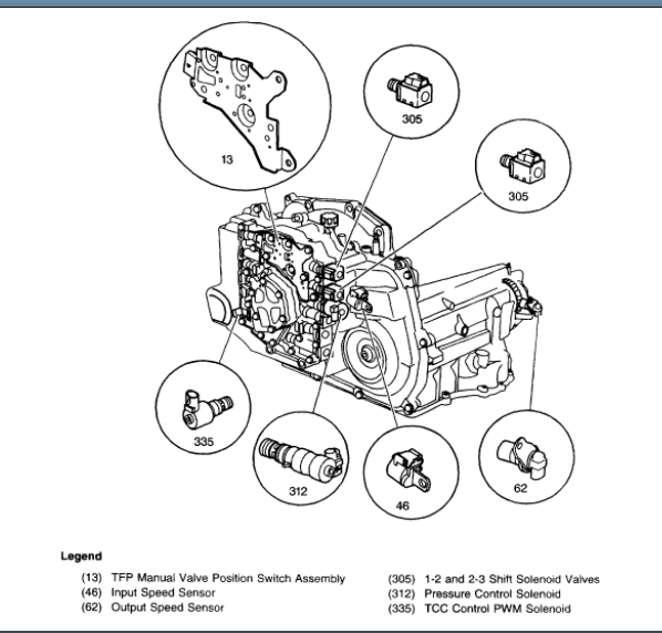

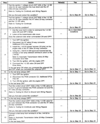

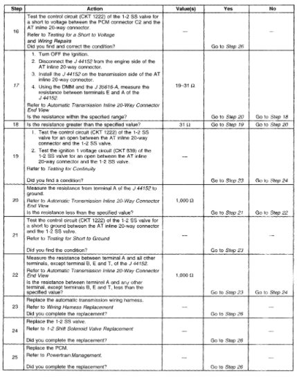

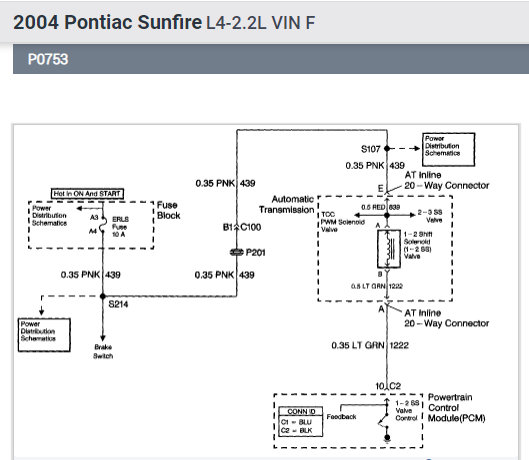

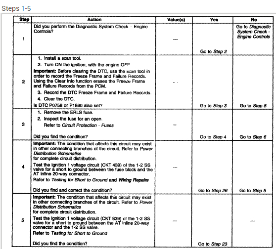

I have read the trouble code and it comes up with shift solenoid A electrical. I guess my question is, where in the transaxle is this located and do I have to remove the transaxle from the vehicle to repair it?
