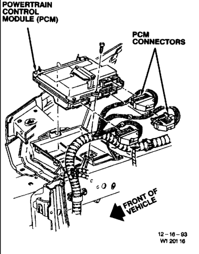

To me it sounds like you have ECM that is going out becasue when you reset the system it starts working again. Have you serviced the transmission lately?
Here is a guide to give you an idea of what you are in for when doing the job.
Also here is the location of the ECM I would try to get a used one and plug it in to see if this is the problem.
