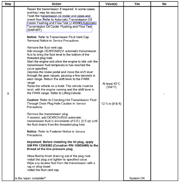

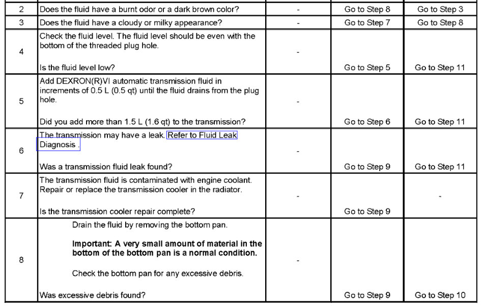

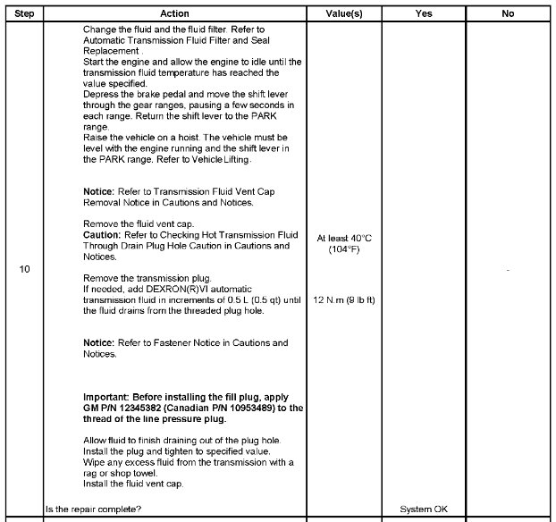

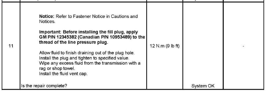

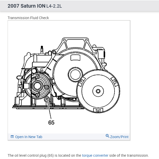

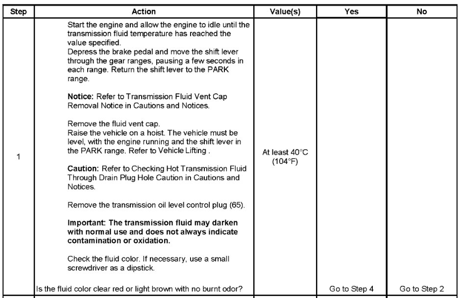

Thanks for listening guys. I purchased this car about two years ago. Around six months afterwards, I noticed a hard shift after sitting in a friend's driveway idling. When I went from park to drive, there was a hard clunk, and the car wouldn't change gears properly until I put it back into park, and into drive again. Seemed to be a onetime thing. But recently it has done it two more times. Both times right after sitting at idle waiting for my wife to come out of the store. I'm also having an issue now and then with the key not wanting to release from the ignition. Like the shifter isn't going up far enough to release. Was wondering if one may have something to do with the other. Like a linkage problem or something like that. I'm really not sure. I'm not aware of any leaks in the sealed system, and otherwise the car shifts perfectly up until this happens, then goes away again for extended periods of time. Happens very intermittently. I replaced a transmission mount due to vibration in the vehicle, along with motor mounts. The car started the vibration a few months after I bought it. Changing the mounts seemed to help a little, but it still vibrates when sitting in drive. I actually just drove it to the store and back and it shifts very smoothly. I'm hearing a few different opinions about whether this 07 Ion has a dip stick or not to check levels. Can't imagine it would be low if there were no leaks. Any help would be more than appreciated. Unfortunately, I'm in no position to replace the vehicle at this time. I try to fix my own cars when I can, but I'm just not sure where to start here. Hopefully with your help, I can lose this worry soon, and get this figured out. I seriously need your expertise and will offer much support to your site in return. Thanks again!
