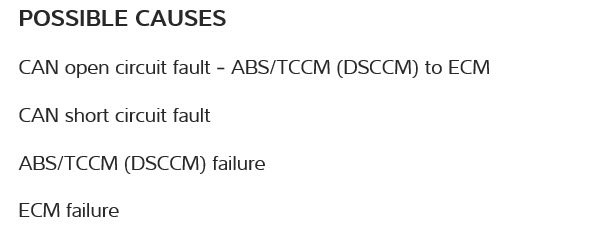

both of those codes mean that one or more modules are not talking to each other a mechanic must look at this to get it fixed. probably seller did not tell you that because you would not buy it. It is a can/bus problem it is more like an ECM or one of the modules listed. See pic.
