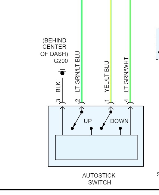

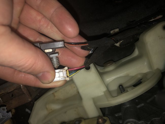

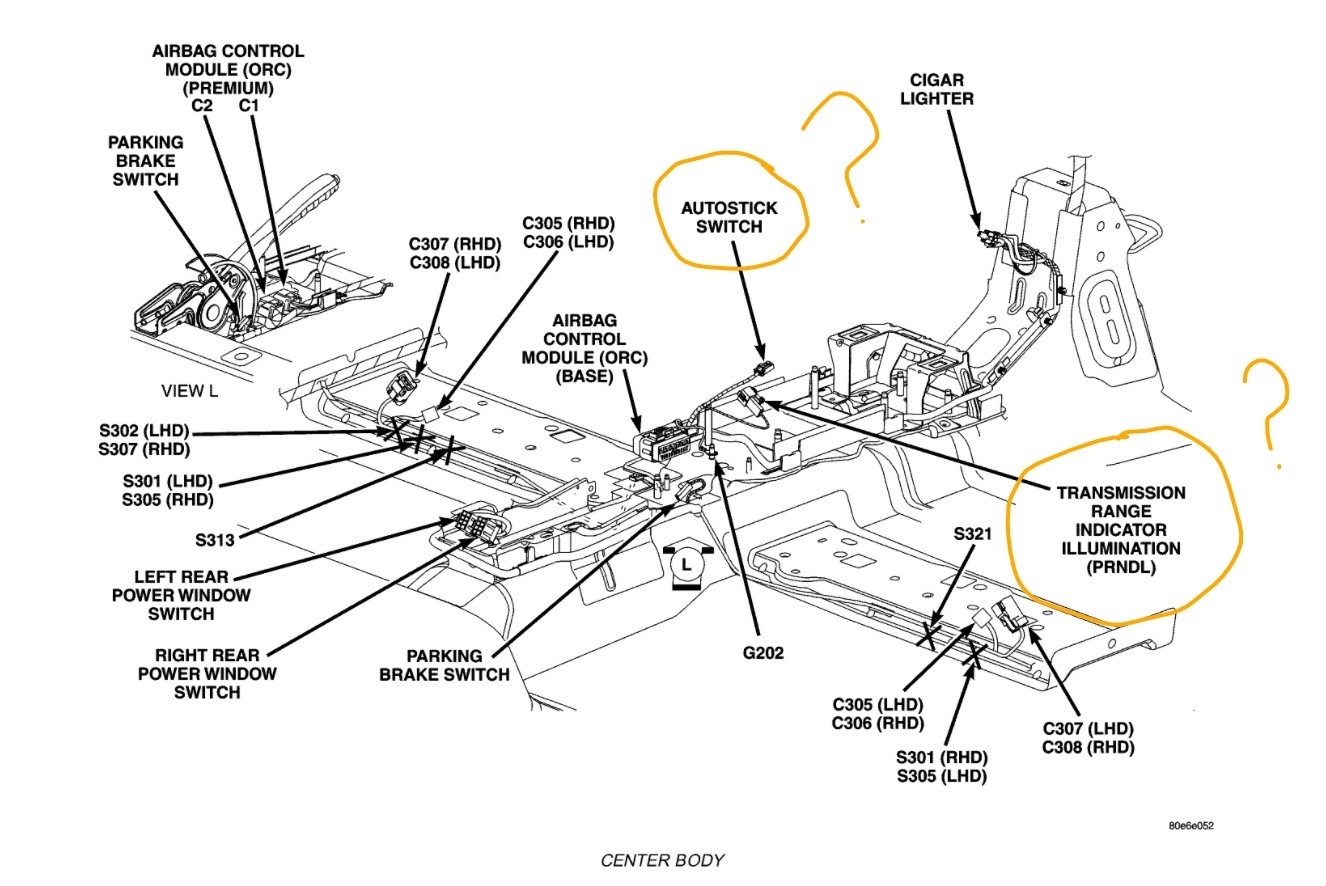

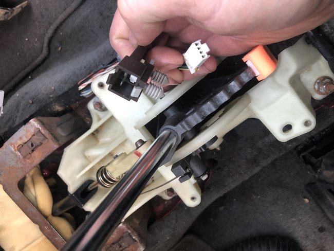

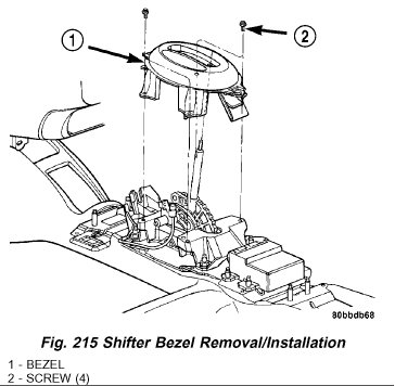

Tell me the wire colors and I'll look them up, I suspect they may be for the other transmissions they used but wire colors should show that.

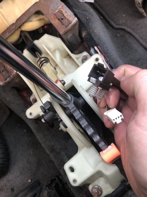

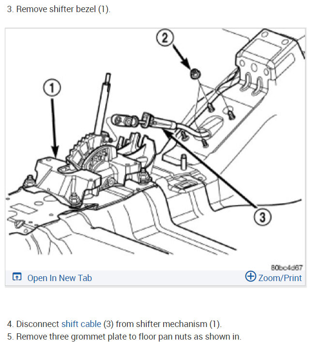

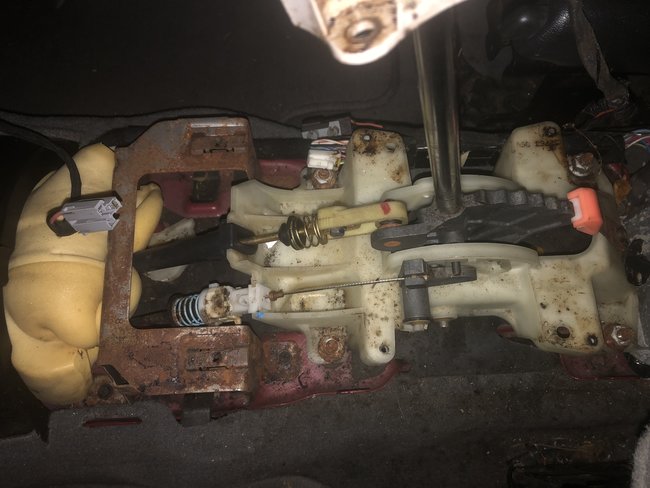

Does yours have an auto stick transmission shifter? That 4 pin connector could be for that option if you don't have it. Do the wires match the ones in the attached diagram?
The other one looks like it could be for the PRNDL light.
