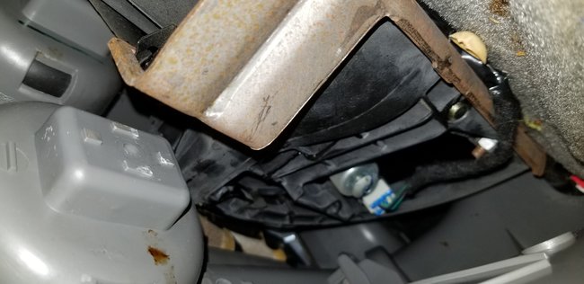

Recently the shifter will not move unless I hit the overdrive reset button every time. I have checked the transmission fluid. This just started two days ago. What do I do?

Do you mean the bypass at the shifter for getting it out of park? There is no overdrive reset button.
Can you post a picture of this button?

This is the button. You have to let up the console that houses the shifter.
Apr 8, 2019 at 1:26 PM
That is the shift interlock.
Do your brake lights work? The brake light switch is what controls the interlock system.

When we push that button in. And I press the brake pedal. And the button on the shifter it will go into gear.
Apr 8, 2019 at 1:48 PM
There is the solenoid on there that moves an arm.
The solenoid has most likely failed. In order to replace it, the entire shifter has to be replaced.

Apr 8, 2019 at 1:54 PM

So it has nothing to do with the shift linkage? It is a solenoid built into the shifter that allows it to move into gear when the brake pedal and the button is engaged correct? Like a safety feature. Currently I am overriding that feature by pressing in that button under the shifter.
Apr 8, 2019 at 2:56 PM
That is correct.
