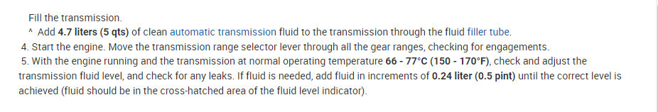

We need to check the fluid and just make sure it is correct. I attached the process.
Let's start with this and go from there.
