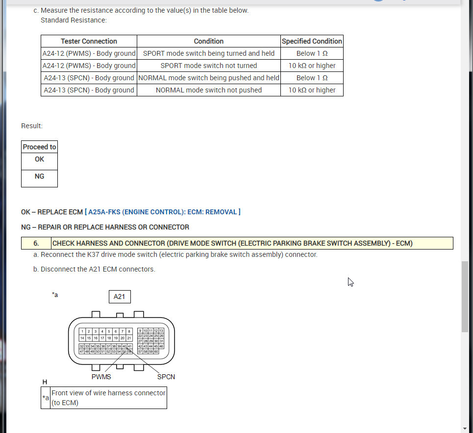

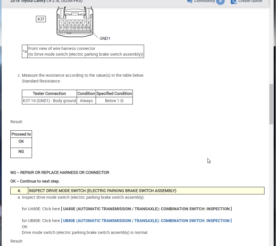

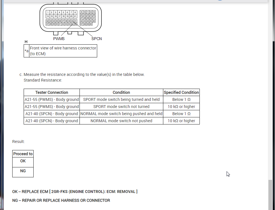

Couple things. First and foremost, if this is still covered under the powertrain warranty then you will want a dealer to inspect it and tell you if it is covered. Clearly you don't want to pay for anything or even have to mess with it if it is covered under warranty.

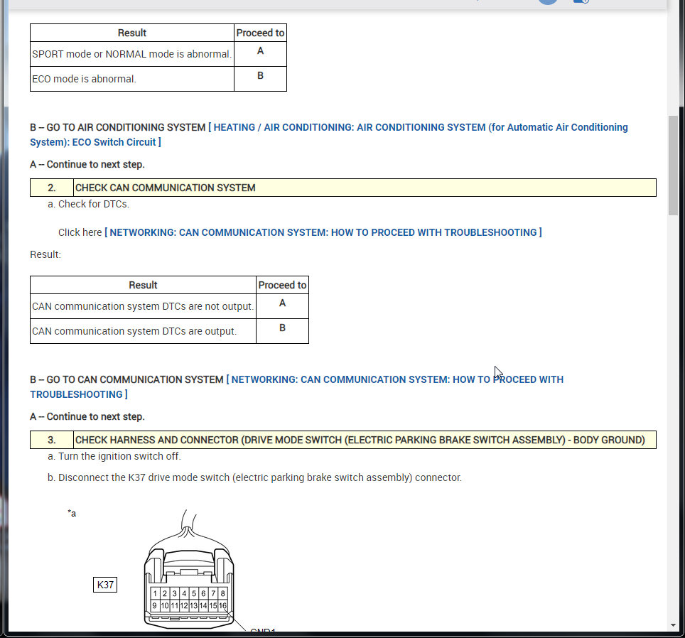

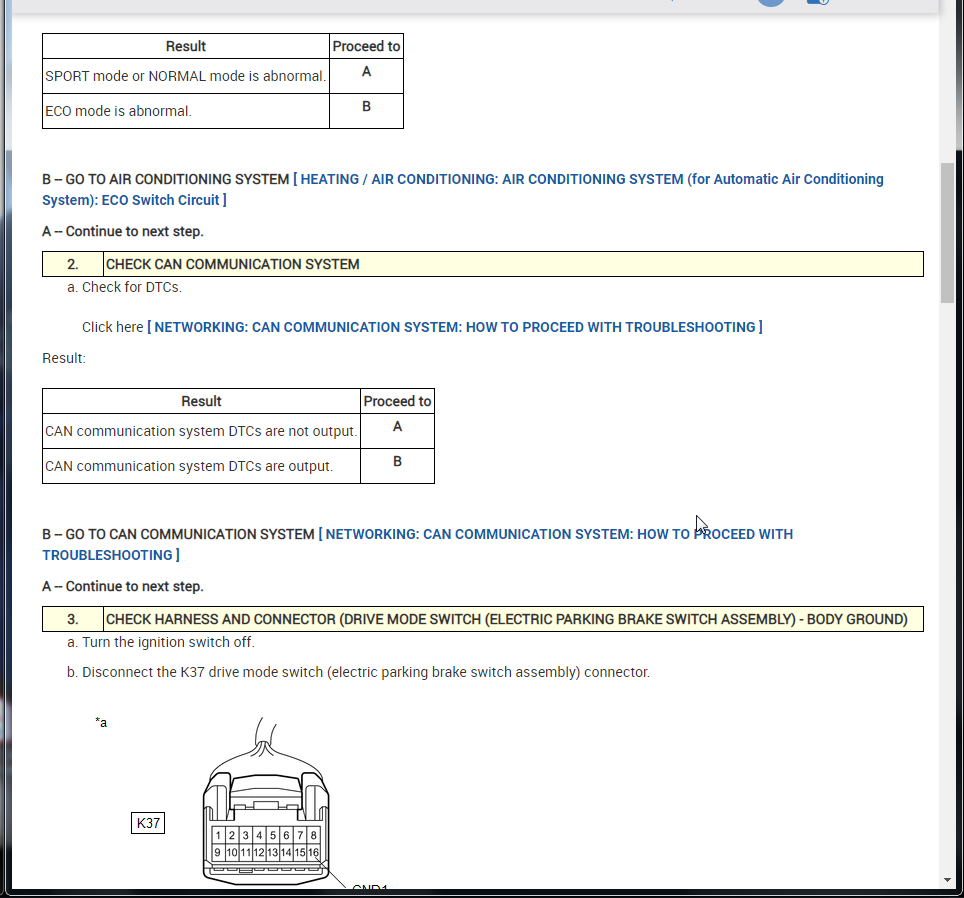

If this is not under warranty we need to start with checking for codes. I attached a guide here that will help with that.

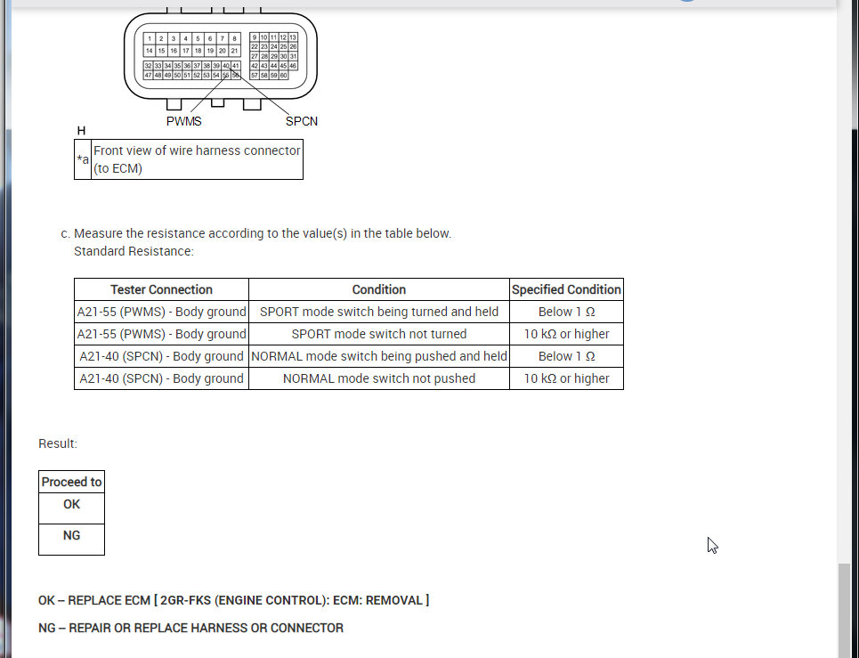

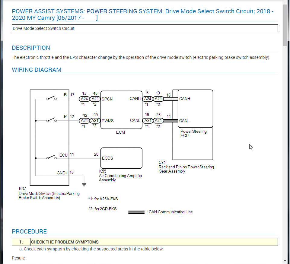

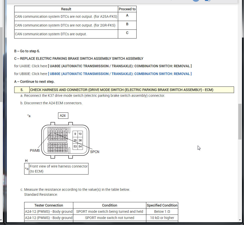

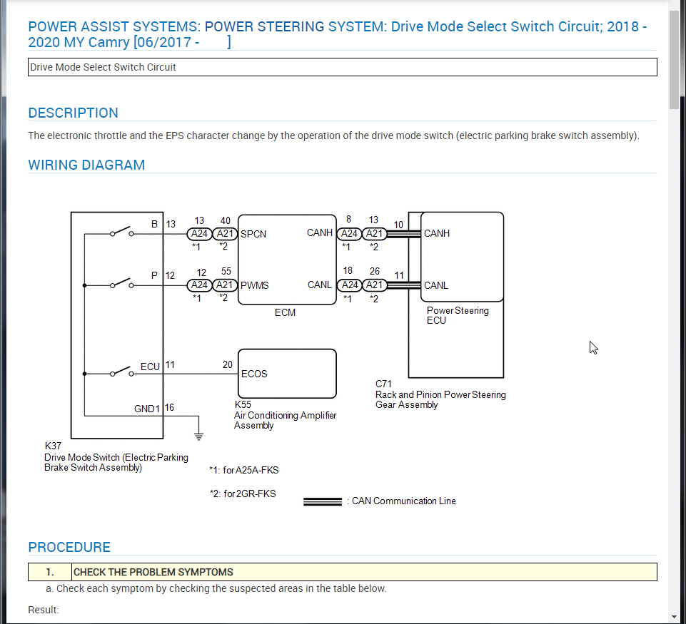

Then we need to run through this testing depending on what codes we have. I attached the testing that we need to run through below if there are no codes.
Here is a guide that will help with wiring testing if you are not sure how to take these types of readings:
