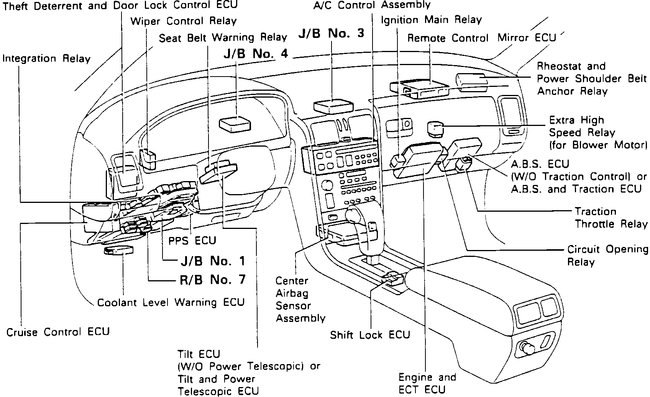

The shifter doesn't shift out of park without the override button which i wouldn't have a problem with except the override has become finicky and difficult to get it out of park even with the override. I'm told it's a relay in the shifter not letting it shift out of park and I'm trying to find out where that is.
May 9, 2019 at 1:24 AM
Welcome to 2CarPros.

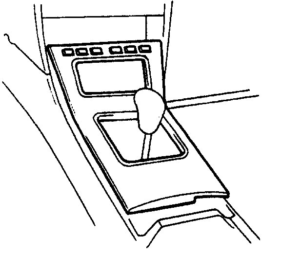

The shift interlock control module is in the center console. See the attached pictures.

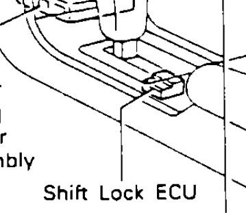

Picture 3 is a wiring schematic of the system. I'm adding it in case it's needed.

picture 3

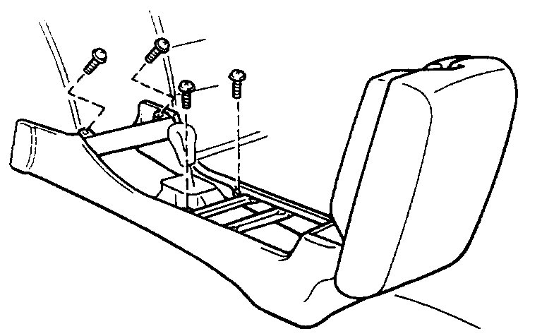

picture 4
(b)Using the screwdriver, pry out the lower console cover.
(c)Using the screwdriver, pry out the cover.
(d)Remove the 3 screws and lower console box.
(e)Remove the 4 screws and cup holder.

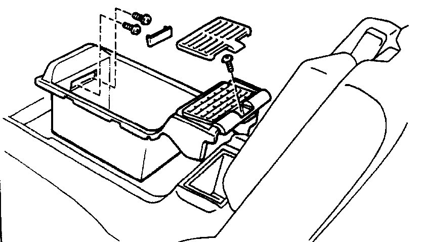

picture 5
(f)Remove the 4 screws and the console box.
Installation is in the reverse order of removal.
